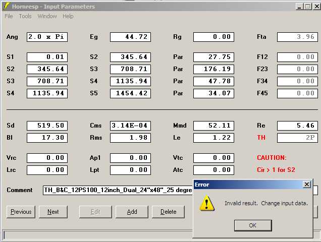

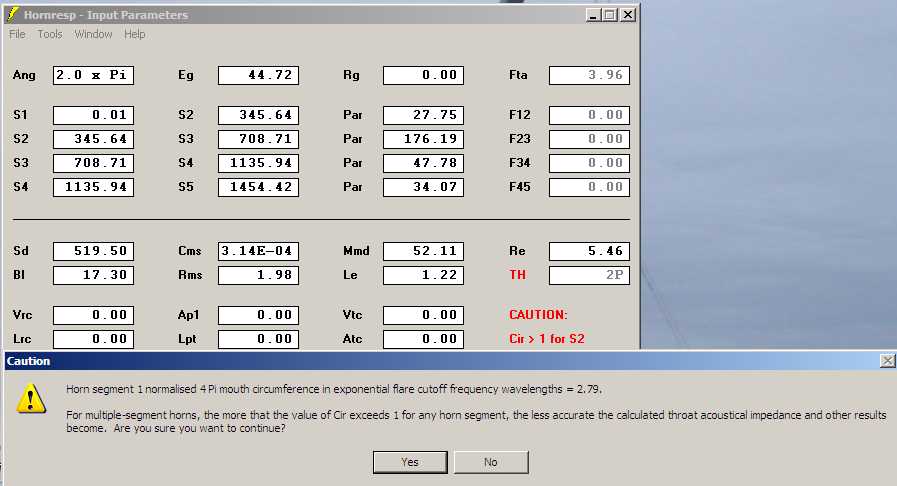

Just updated to 3100-130124, and when resetting S1 to 0.01 I get an error in Par and Exp, but not in Con. Please, see attached pictures.
The first message is a warning, telling you that the horn is so large compared to the cutoff wavelength that the plane wave model is no longer valid. It has always appeared for multisegment horns, when Cir for one or more of the segments exceeds one.
Hi Oliver,
Brilliant pickup - many thanks!
The error was introduced as a result of making the schematic diagram perfectly symmetrical under all conditions. The problem will be fixed in the next release - likely to be tomorrow.
Kind regards,
David

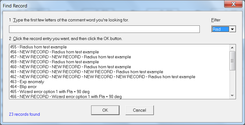

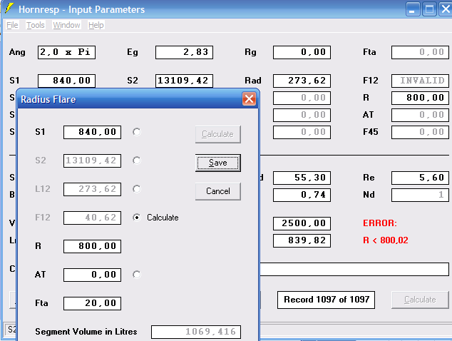

Rad wizard made/allowed another invalid horn.
Hi David_Web,
Strictly speaking the radius horn as specified in your example is a valid design. It's just that when the axial length is less than one-eighth of the cutoff frequency wavelength, the radius horn is not really acting effectively, which is why Hornresp displays the warning message on the main input screen and prevents results from being calculated. This same limitation is applied to Le Cléac'h, tractrix, and spherical wave horns.
Kind regards,
David
And what appears to be a rounding error.
Hi David_Web,
The result you are seeing is indeed due to the Horn Segment Wizard parameter values being rounded to two decimal places. When the wizard calculates values for anything other than the main input window default configuration, there is always the chance that a subtle change will have to be made to one of those values when "transformed" back to the main screen. This applies to several of the horn types - not just radius horns.
Kind regards,
David
