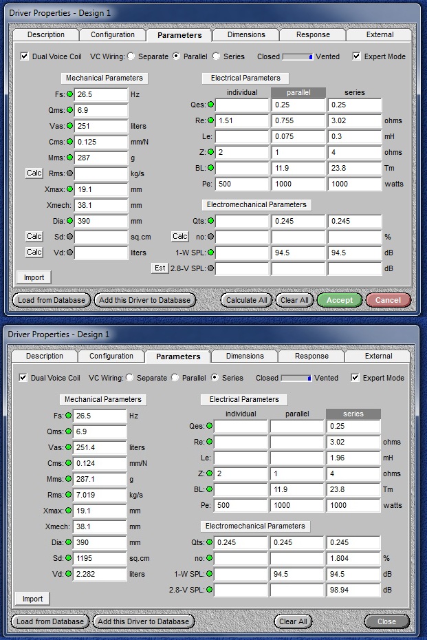

The Datasheet doesn´t provide Sd (I simply don´t get why TC Sounds always does that, but.. oh well..... It´s just the way it is..). The Diameter is NOT the exakt effective area which would be Sd.... This is something TC Sounds is doing the wrong way, honresp can´t be blamed for incomplete datasheets.
The discrepance comes from the way the diameter is derived... If simply measured from the middle of the surrounding, you get a slightly different value compared to calculating it from other parameters. Often datasheets are "mixed", resulting in some slight shifts in the values. In fact, most manufacturers have slight irregularities in theyr datasheets.
One moment, doing some math...
Asuming all the other values in the datasheet are allright, I get Sd=1186,5 cm², which results in Cms=1.25E-04, close enough to the datasheet.
Slight abberations still occur, but thats "normal".
To derive some unknown parameters, you can crosscalc with some tools. I recall WiniSD PRO, LSPCad or TSPCheck, there are probably many more, but these three worked fine for me in the last years. WINISD PRO is free.
So your saying the Cms figure is likely to be more accurate then the diameter they provided? Can you work back from Cms to get Sd?
Hard to tell how they got the data. I don´t know the used measruement system, so I don´t know which method is used to get the data. Most of the paramteres can be calculated from a set of others...
Some parameters are rocksolid most of the times... But then I´ve even found measruement differences in Re when using DAAS, MLSSA and others.... Not by a noticable dimension, but enough to get a datasheet which almost looks like a different driver at first glance... Many manufacturers have slight improvemts on the drivers over the years and not everytime all the data in the datasheet gets updated at once... When Eminence changed the glue on the 3015LF and added some epoxy, MMD certainly went up slightly, but first datasheets around only showed different Qts Values (resulting in "not suitable for ported boxes anymore" statements on the web, since Qts then was 0.45 rather then 0.39 before...). Of course, the driver performed the same (we used a lot of them, I can tell....) and simulations differed only slightly, but there were many people on the web having a completeley different view on this driver than before (all that was changed, was 1,5g of epoxy more...)..
What I am trying to say: On Paper, it sometimes looks like a big difference - but in Reality or simulation, it often is only a small one, if any... TSP-Sets from different measruement-methods even can look very different but still represent the same driver.
Using WinISDPro, you can calculate missing parameters, as long as you have the ones leading to the missing one (assuming they are correct....).
My guess is, that the diameter provided is simply measured with a ruler. Which is ok, if the rest is done afterwards on this basis.. Obviously, it´s not :)

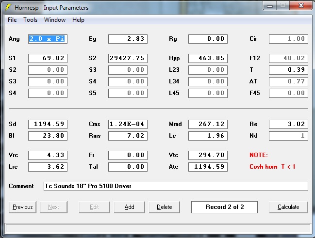

That didn't work... I put in 1194.59 for the Sd and 1125.4 for Cms (which turns into 1.13E+03) I double click Cms and add a Vas of 251.4 and the Cms turns into 1.24E-04, so something isn't right.
I have attached the TS Parameters can you please see what is wrong.
Notice that Cms in the datasheet is in um/N (micrometer per Newton), the units used in Hornresp is m/N. So the value in the datasheet is actually 1125.4E-06 = 1.13E-03.

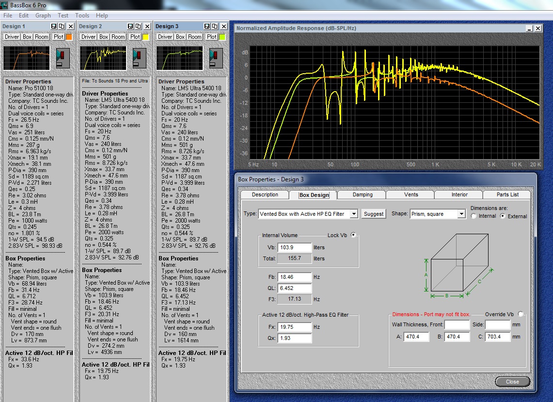

The only bit of software I can get to make any kind of sense in Bass Box Pro.
When you use the driver picker it loads a different Cms to the one in the data sheet suggesting a typo in the data sheet.
The Cms in BBP is the same as HR after you double click and it alters the Cms.

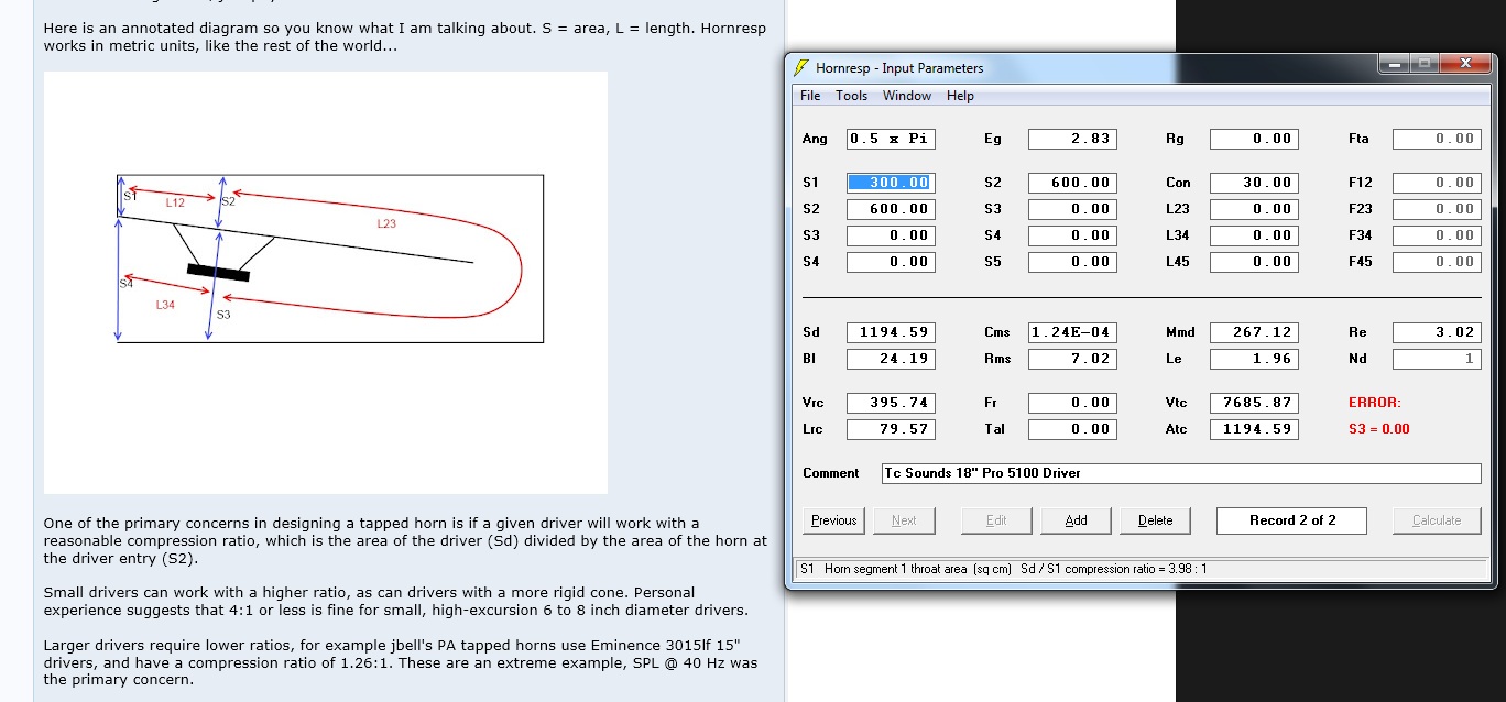

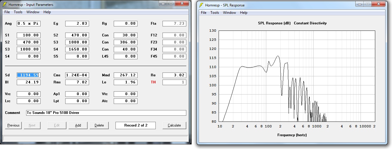

Got it sort of working, but it wants to make the cabinet several thousand litres, can anyone make this smaller as the wizard only want to make it big.
You can try a different set of starting parameters. It seems from the resulting horn desing that you want to build a 40Hz-600Hz bass horn for use in a large, open field. (2Pi = halfspace). Two problems with that:
1) you probably do not plan to use the horn out on a large field, so you shoudl specify Ang of either 0.5 (corner) or 1.0 (floor/wall intersection). However, if you do plan to use the horn outdoors, you actually need a large mouth.
2) the driver is a subwoofer driver with a heavy cone, and will not go high in a horn. Hornresp tries to compensate by reducing the throat area, which makes the horn longer and increases throat distortion.
Try setting Ang to 0.5 and reduce the upper cutoff, and the horn becomes much smaller. Efficiency increases too.

No I was planning to use two of them as home theatre sub woofers.... but cant get the box size down below room size. This program seems to have potential but is completely useless for a novice. The help file is not user friendly enough to be of use and is too vauge for a novice, the wizards which a novice needs to use to get in the ball park suggest boxes the size of football fields.
I treid using 0.5 but still facing 2700 litres which is not practical. So I think I will go back to Bass Box Pro and do a BR box in that. Pity I really wanted to try a folded horn.

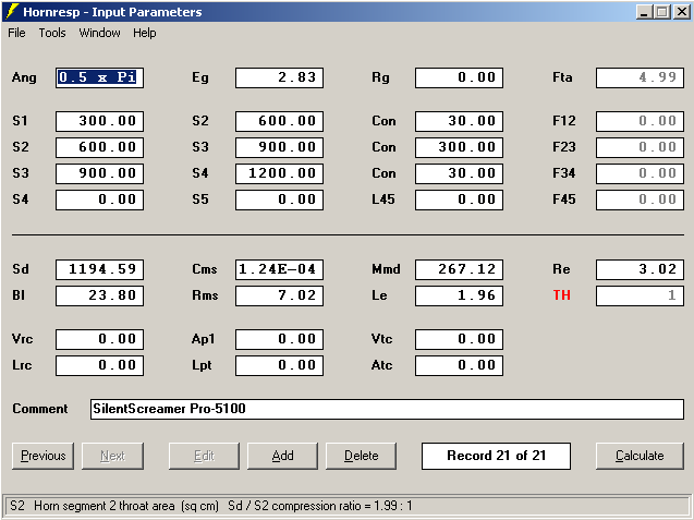

The attached picture is a classic reason why the software needs to include extremely clear instructions. In the tutorial it appears to calculate the compression ratio based on S2, yet when you hover over S1 in the app it appears that it is using S1 as the means to calucate it, when you hover over S2 in the app nothing to do with compression comes up.
So now I am faced with the delima of knowing to trust a self proclaimed novice, or the person who wrote the software, of course I naturally trust the person who wrote the software, but logic also tells me that calculating it off S1 is wrong.
Common sense would dictate that if I am working out a ratio of an angled board I would use the S2 mid point because the high and low either side would even out... but what do I know I dont even understand why I am calculating in the first place so now I am well and truely confused who to trust and what value to put in there...

Your problem is that you are calculating a front loaded horn, where the driver is attached at S1. You need to tell Hornresp that you want a tapped horn, where the driver is attached at S2 and S3. The help tells you how to do this (on page 20, note 8 in my version of HR). When you do this, hovering over S2 gives the compression ratio.
A sample is attached:
