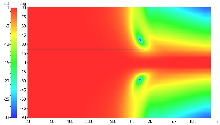

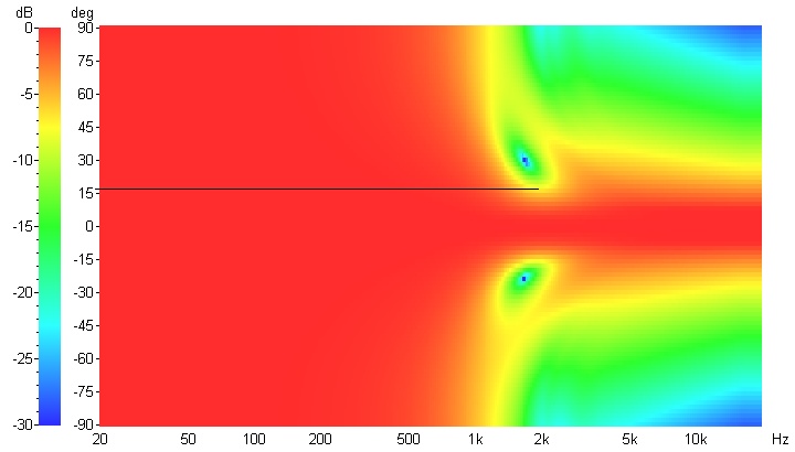

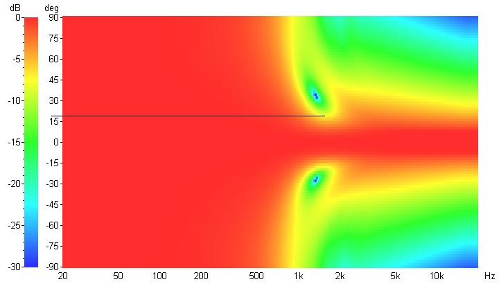

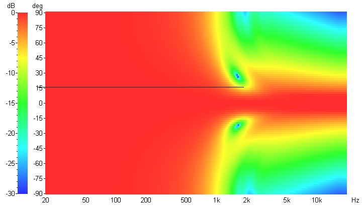

ZilchLab said:Humor us with the 6.5" 90° x 50° case, please, subject of this thread.
What 10", 90° round waveguide are you modeling?
Sure, what crossover frequency and acoustical (not electrical) slope?
The 10" is a generic 90 degree horn based on a text file I built. LspCAD can use files like these for off-axis sims. I put a little more effort into the 90x60, picking some numbers off Brandon's measurements. It would help if you'd build me one for the econowave. You can include as many frequencies and angles as you want. Otherwise I'll use the generic values commented out with //. LspCAD will interpolate values not included.

To keep things comparable, LR4 @ 1.3 and 1.6 kHz, w/10" and 12" woofers....

Okay Zilch, don't say I never did anything for you. Here's the file I used based on Earl's curves.

Econowave with 12" woofer and LR4-1600
What software are you using to do the sim? Or are these measurements? The color shades do not seem to have enough contrast to see the pressure lines. Is it possible to show this?catapult said:Econowave with 10" woofer and LR4-1300

soongsc said:What software are you using to do the sim? Or are these measurements? The color shades do not seem to have enough contrast to see the pressure lines. Is it possible to show this?
It's a sim done in LspCAD using 'perfect' drivers and a 'perfect' crossover transfer function. The horn's directivity is simulated with a text file and the woofer's directivity is simulated with piston diameter. You could use real measurements if you had them and a real crossover if you had the schematic. You can download the demo version and it will do everything except save files and model more than 2 drivers.
I guess you could make the dB range smaller but I've wasted too much time on this already. It's just meant as a 'this is the general idea' visualization, nothing too precise. I started doing these to answer the question 'could the QSC horn work with a 15" woofer' and I concluded that it could without any huge penalties.
