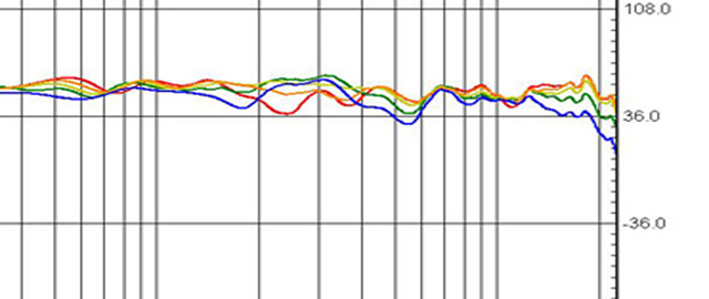

Edit: Looks like my vertical lobe is somewhere between +7.5° and +10°:
More Data ... Less Yak-Yak:

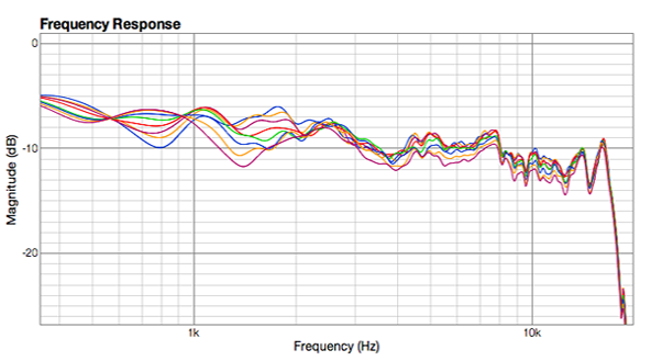

Could someone with better Photoshop skills than me overlay the following two images with maybe 10 dB of vertical offset, please?
I believe I have them scaled equivalently, but one is JPG and the other PNG, and I'm having difficulty making layers happen.
They are vertical polars +/- 10 dB from the lobe center, first for Markus's Nathan:

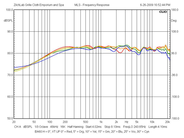

And this one, my el-cheapo dumpster-diver Boston A60 Econowave. Note that my plot extends past 20 kHz in aligning them horizontally. Mine should go above Markus's, looks like, as the response doesn't collapse up there.
If you'd prefer to work with the "originals," they are third image down here:
http://www.diyaudio.com/forums/showthread.php?postid=1859757#post1859757
And this one here:
http://www.diyaudio.com/forums/attachment.php?s=&postid=1865902&stamp=1246087381

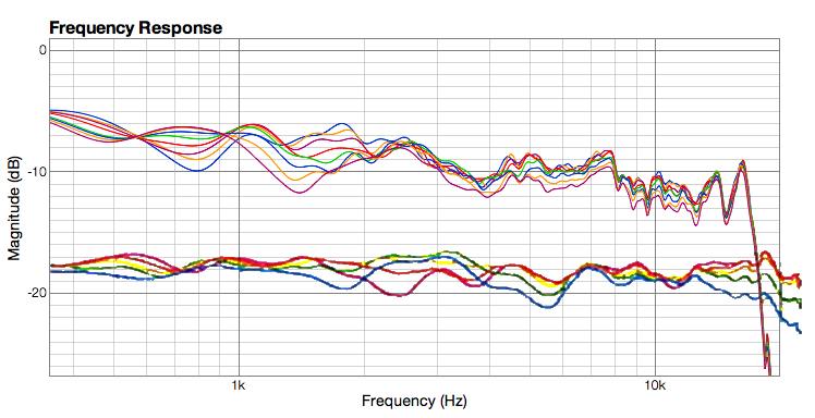

Hello,
Here attached but not very pretty (allways difficult to work after a JPEG conversion...)
Best regards from Paris, France
Jean-Michel Le Cléac'h
