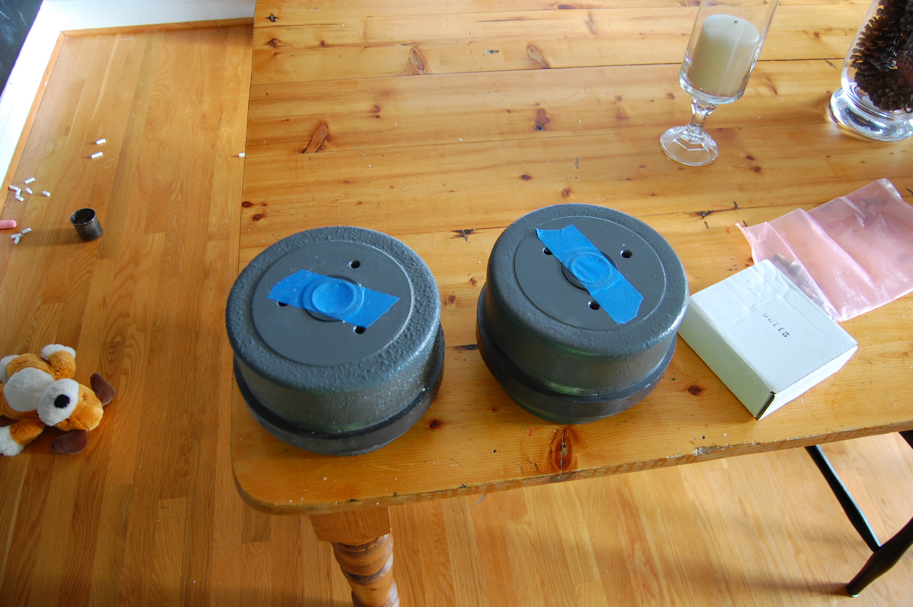

I know you have stated that getting new from GPA is easier than messing with older drivers that made need work. I dont disagree at all. I simply went this route as it allowed me to try something for a great deal less than new. The side by side double will use the 414's, unless you think the MTM setup is better for my room. I buoght a pair of JBL Le15a's in good shape off a local guy that I will put into the single woofer version. Based on what i hear, I will decide where to go from there. This is really a step into nerw territory for me, SO i have to decide if I even like the concept. I will measure all the drivers and post info. I have been playing with WinIsd and Unibox for all the above drivers as well as the ALtec 515 and got what seems to be very usable reponses, especially considering EQ. Working on wooden horn layout today and trying to flesh that out. Any opinions on which dual driver setup to use, considering my room?
I have decide to do first draft of horns in MDF. IT will help me work out my kinks and try some ideas for cheap. THought about normal framing wood, but MDF is ore consistent.
I have more motivation now.
Dman these things are huge.
