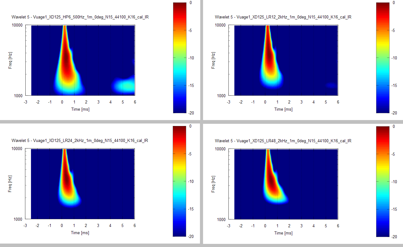

Been playing with Octave tonight, and so I decided to measure the horn again I tried various HP filters to see their effect on group delay. The horn is 18sound XD125 and it's mounted on a 40cm width baffle. Measurement distance is 1m, and orientation is on axis.
The cases are:
1) 1st order at 500Hz (for protection)
2) 2nd order LR at 2kHz
3) 4nd order LR at 2kHz
4) 8nd order LR at 2kHz

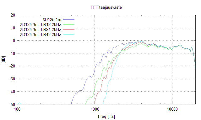

First here's the windowed FFT freq responses:

And here's the wavelet transforms of the 4 filter cases:
The higher the filter order the heavier will the response be tilted to left. However, in the usable band >2kHz the difference between no filter and LR12 is negligible!

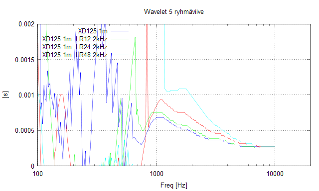

Maybe the difference it better seen from the group delay:
Indeed the LR12 does not add almost anything to the group delay of the horn itself. Then LR24 almost doubles the delay at 2kHz. Obviously LR48 has huge delay.
Now the question is how does this relate to Horn Honk?
What is interesting about the group delay of this horn is the fact that it's never constant but has rising slope all the time! No phase linear system possible with this horn

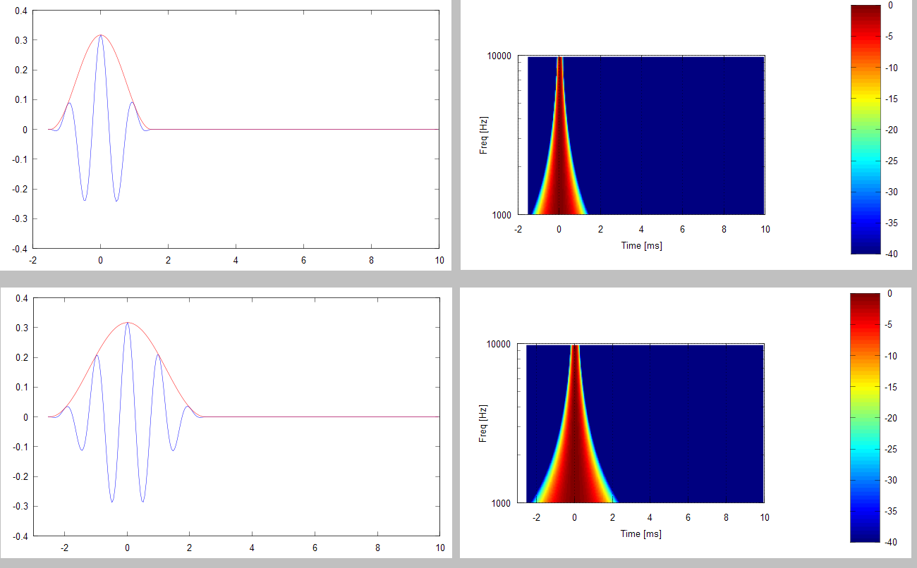

The interpretation is not difficult The "christmas tree" shape comes from the fact that the wavelet contains a fixed number of cycles at each frequency. Thus the time domain width gets smaller as the freq increases.
Here's a pic of two set of wavelet transforms on the right first having 3 cycles and another having 5 cycles wavelets. The colors indicate the magnitude of the envelope in dB scale. And on the left their time domain waveforms with the envelope at the lowest frequency. This is the ideal case (the response of a PC sound card).
Hope it helps
- Elias

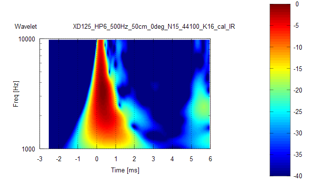

Interesting things come at display when increasing dynamic range of the wavelet tranform results. Here looking at the 40dB scale. Again the same 18sound XD125 horn now measured at 50cm distance on axis.
Here's a 5 cycle transform. There is a lot of garbage on the right hand side with this horn! Compare this to the sound card response above.
Notice the first room reflection comes at 5ms (ignore that).
- Elias

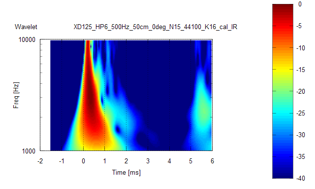

If we trade some of the frequency domain resolution into time domain resolution and select 3 cycle wavelet, we can see there are multiple consecutive reflections/diffractions at the high frequencies (see above 3kHz for example). Maybe even HOM???
