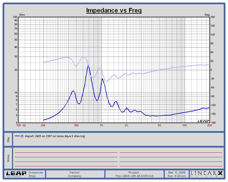

Hello,
Do you know any compression driver having such a large Qts value.
IMHO most compression drivers possess a Qts <0.2
Best regards from Paris, France
Jean-Michel Le Cléac'h

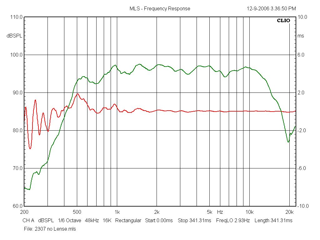

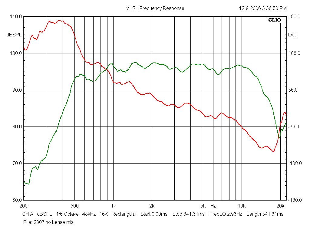

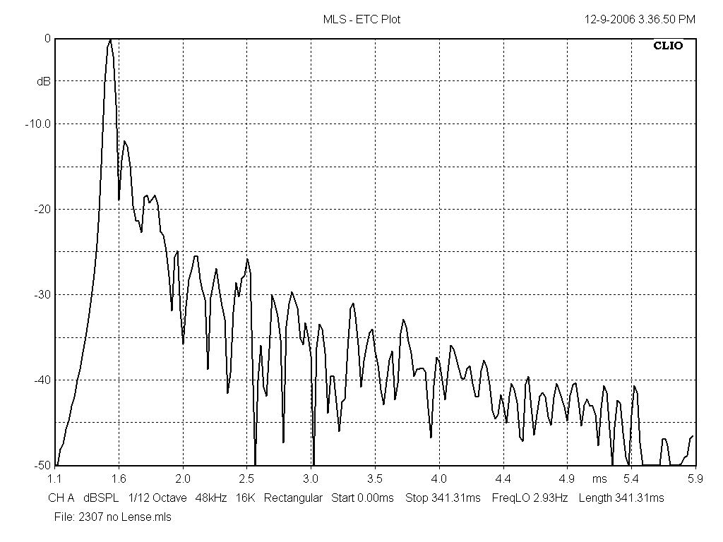

Hello Soongsc,
We have to be careful in our interpretation of ETC.
On such an ETC curve it is very IMHO difficult to separate what is due to the group delay rise when acoustic reactance dominates on acoustic resistance from what is due to reflections or other stored energy release processus.
IMHO, better to keep using spectrograms, CSD or wavelets graphs... onto which it is more easy to separate what is due to non stored energy processus (like GD rise due to reactance) and stored energy process (like reflections, resonances...)
Best regards from Paris, France,
I think GD, reflection, resonance are the same thing, a problem of transmission of energy i.e a reactance effect in acoustic domain.
Hello Thend,
The way you are considering the rise of the GD due to the unavoidable reactance of any horn and the reflections from rapid flare change or mouth toward throat which are themselves avoidable is a bit sterile considering the goal of that thread.
IMHO better to separate what is a normal behaviour of the horn (the increase of the acoustic reactance/resistance ratio near the cut-off) and what is a undesired behaviour (the reflections, ....).

Hello,
You are right of course but please note it when the compression driver is installed on the horn and not the unistalled Q. Yes I have seen about 2 that were that high installed.
Step change at compression driver throat interface
Yet another reasons horns honk is the conical flare rate of the compression driver interfaces at the more elliptical flare rate in the throat of the horn. Now I know this is really a small change but it is down there in the part of the horn where things are very touchy. Any step change is a change in propagation Z which can cause a reflection and make the horn honk. I use a thin matching device there which re-emits the signal from the compression driver into the throat. This has completely removed honk from horns in testing. A soft gasket with a reduced hole size from that of the horn throat. Nothing but good has come from this in practice as far as I can measure.
This may not work on all horns but has worked on the horns I use as in earlier post.
