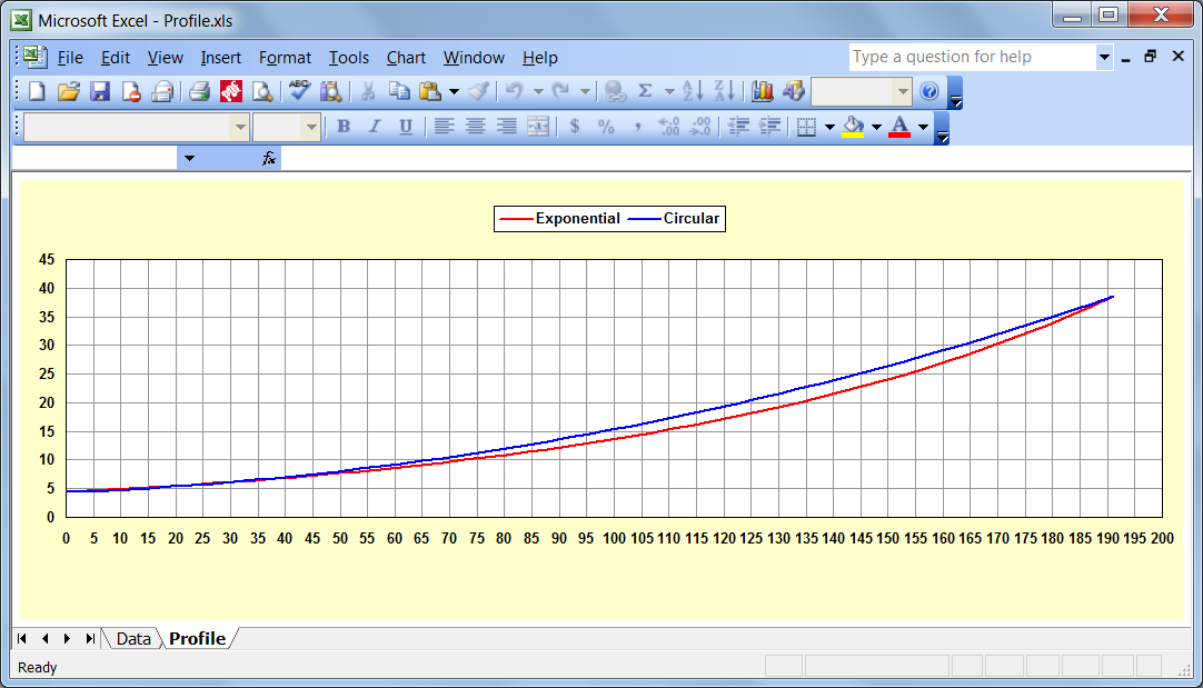

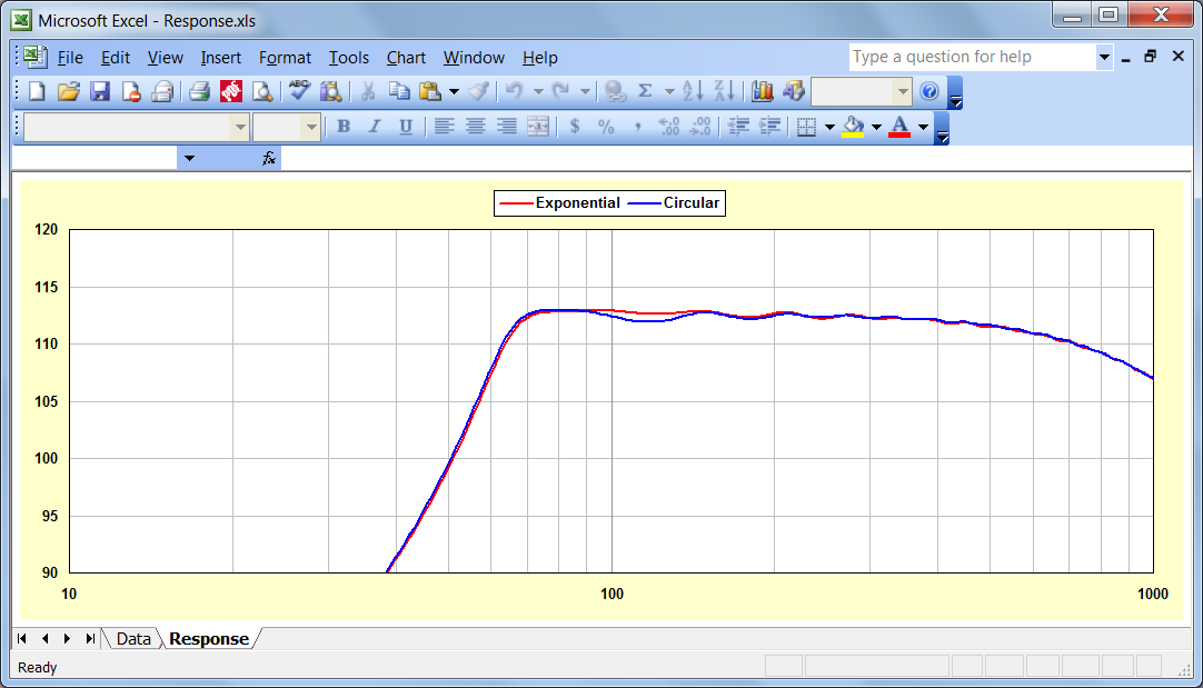

My curiosity got the better of me - I couldn't resist comparing a circular flare horn to an exponential horn having the same throat size, mouth size and length. For the chosen example, the difference in power response is not that great, although the exponential horn is still arguably slightly better (flatter response) - see attachments.
When I look at an exponential flare profile I see very little difference between that and a section of a circle, visually anyway.
As mentioned in my previous post, it depends on the radius chosen for the flare profile circle. What I hadn't realised at the time though, was that you were automatically assuming a radius value that most closely matched a given exponential curve :).
In the attached example the circle radius is 700 cm. The flare curvature could be increased or decreased simply by changing the radius. As the radius tends towards infinity the flare will become more conical.

Interesting, I had a feeling that the "linear" expansion of the circular profile would possibly result in incontinuities in the response, it is not as pronounced as I anticipated. I was surprised that the very lowest end response was just as good, ever so slightly better, than the exponential.

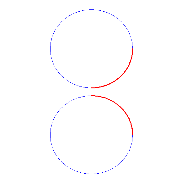

Great observations. I was imagining the semicircle beginning parallel to the axis at the throat and curving out to the edge of the mouth, the length and mouth size determined by wavelength of the lowest frequency desired, all accounting for the environmental condition. So throat, mouth and axial dimension would determine the radius of the circle. I don't know if that made sense but I simply noticed that the curves were quite similar.

I'm having trouble visualizing what you mean, can you put up a sketch?
Hi Dan,
The horn flare profile is generated from the partial circumference of a circle - the red lines in the attachment show the profile of a "circular flare" axisymmetric horn having a mouth flare tangent angle of 90 degrees.
Look carefully at the profiles in my earlier post - notice how starting from the throat, the "circular" horn profile (blue trace) increases at a slightly slower rate than the exponential horn profile (red trace) for about the first 28 cm of the horn. This is the reason for the marginally better predicted low frequency response.
Not in the more general case - given only S1, S2 and L12, it then becomes necessary to also specify a radius. As mentioned previously, the radius effectively determines the amount of curvature in the flare.
