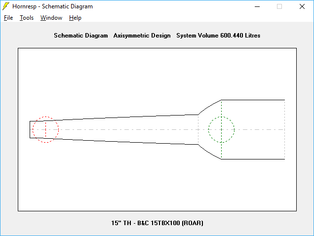

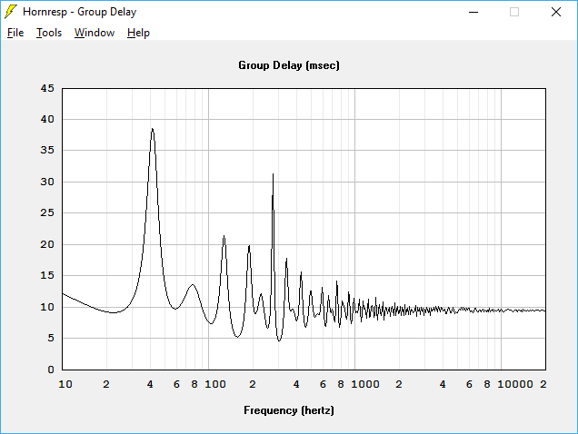

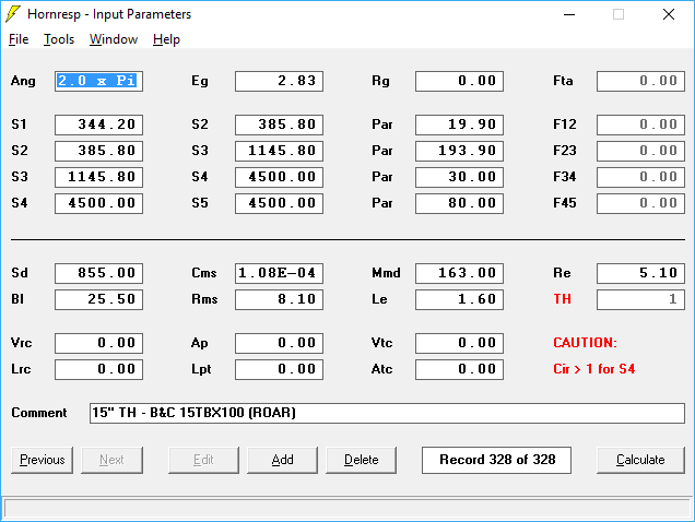

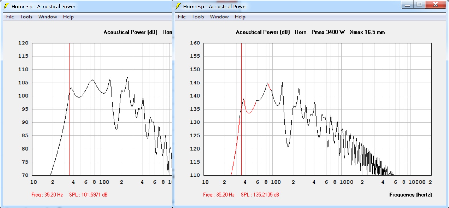

From the images of the sim posted in post #114. I entered the parameters into HornResp, and got this:
The posted 600 liter simulation is a stock THAM15 (not 600 liters) and an add on foldable resonator (only a few liters when folded together for transport - as the other horn-extenders in this thread).
Do you compare the simulated volume of the Horn extender/Wave guide for all the designs discussed in this thread with other THs? I proposed the front resonator as an horn extender - as per the main topic in this thread.
I don´t understand why you suddenly want to compare non-extended THs with a stock THAM15 with a add on front resonator?!

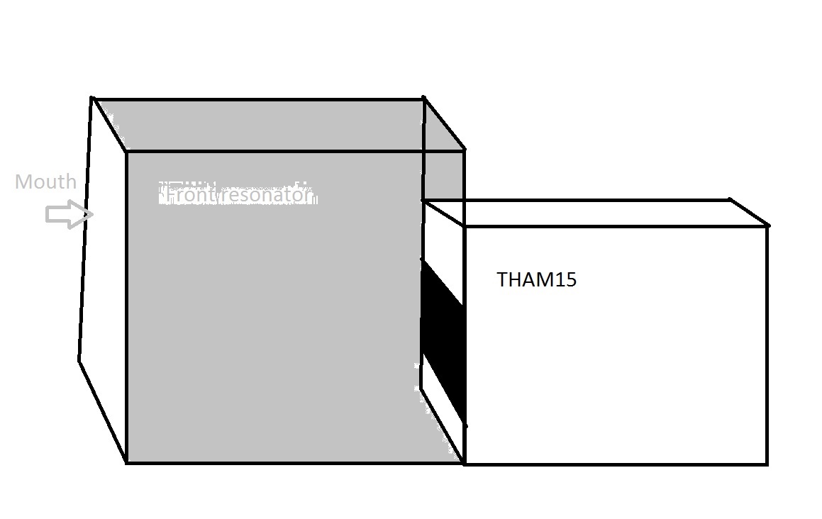

Hi Johannes, not sure I understand what a THAM15 connected to front-resonator will look like. Will it be a THAM15 extended with a ROAR15 cabinet ?
I did have a look at the ROAR range in the link you provided. If you can please post a picture of THAM15 connected to a front-resonator. The sim looks good, thanks.
I have never tested a THAM15 with a frontresonator so I don´t have any pictures.
It is a simple large duct attached to the front of a THAM15. 4 pieces of plywood held together with hinges in the four corners. All attached somehow to the front of the THAM.

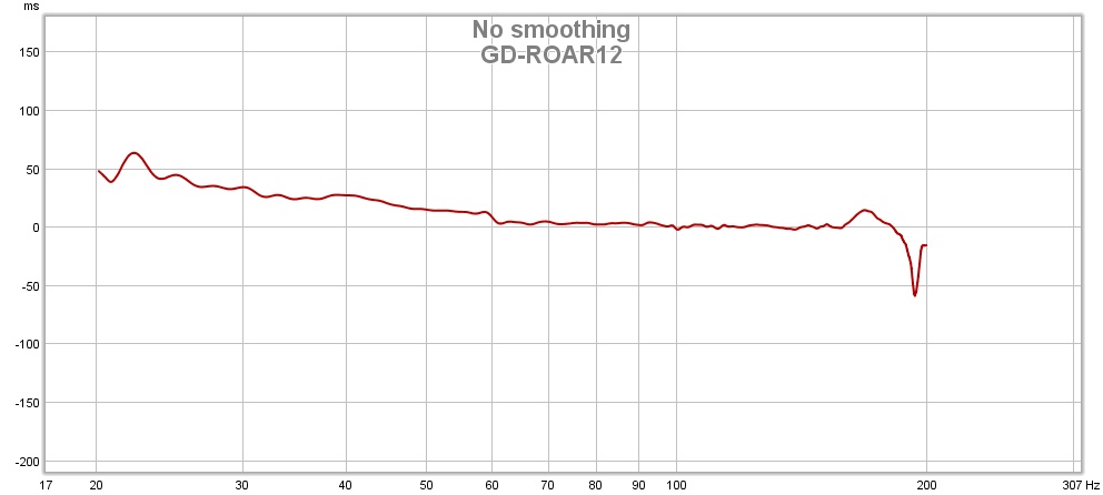

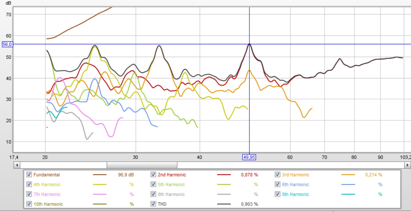

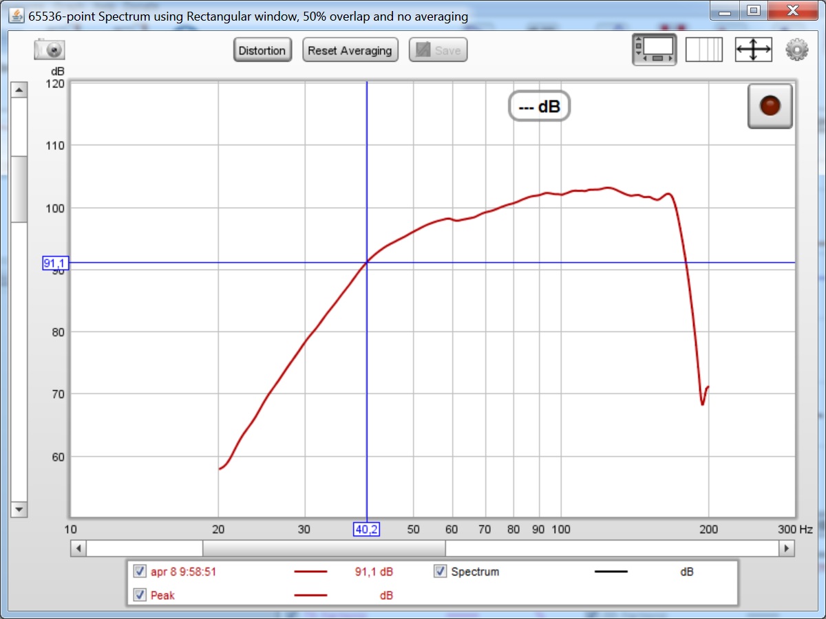

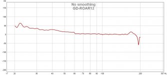

I made some crude simple measurements of my ROAR12 today. I have just started playing with REW and my Umik. I got the microphone yesterday, so I have not had time to learn much yet. Please excuse any noob-mistakes, of which I am sure there are plenty...
The driver (B&C 12PS100) is brand new. I have been plying some low level music through it for an hour or two. Once the suspensions are soften by use, the low end of the passband will increase in level. The suspension feels rock hard at the moment.
Or you could build the large duct/front resonator as a large box with one side open and a large cutout on the other side of the "box". This way it would be easy to transport the THAM15 inside the duct, and just mount the duct onto the front of the THAM15 when you are rigging the soundsystem.
Johannes
(These measurements are made with a raw driver and does not portray the real ROAR12 response.)

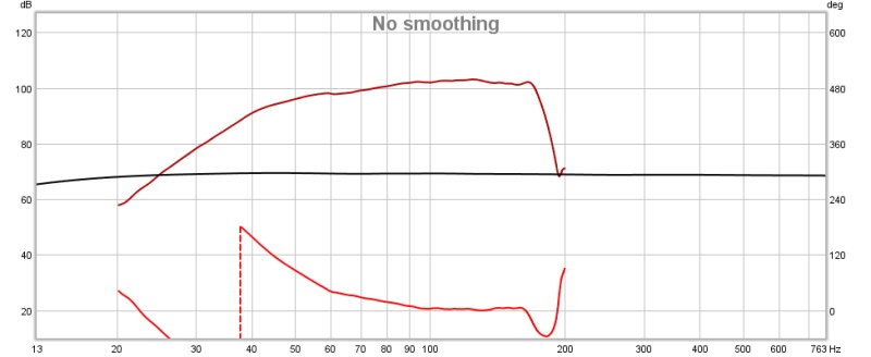

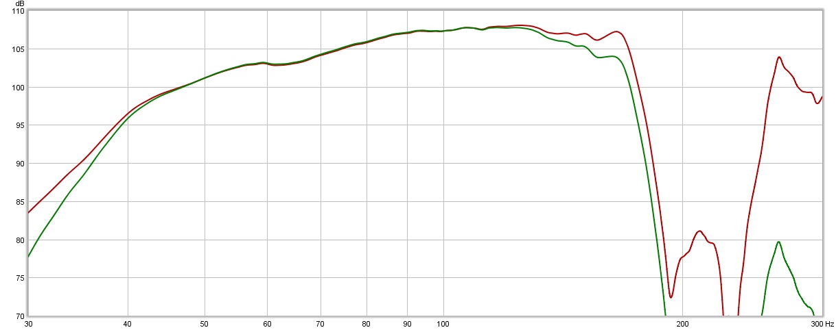

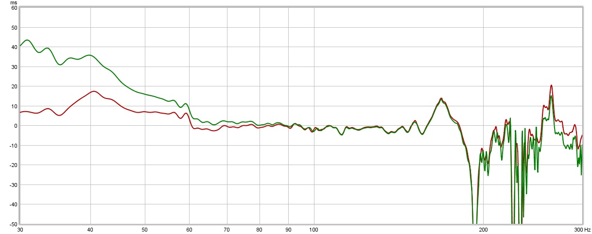

Here are two better measurements.
In the spl-response I show the raw response of the ROAR12 (red trace) with the new and raw driver, which needs several hours of 500 watts program power to loosen up.
The green trace shows the response with a 48 dB/octave 30 Hz HP and 48 dB/octave 180 Hz LP filters. All the filtering implemented with a MiniDSP 2X4HD.
Even though there is a 13.6 ms hump at 168 Hz I would not hesitate to use this ROAR12 up to 180 Hz.
The group delay graph shows the same with or without steep crossover bandpass-filtering typically used in live pro use.
I post this as an example of a front-resonator enhanced tapped horn (tapped pipe in this example).

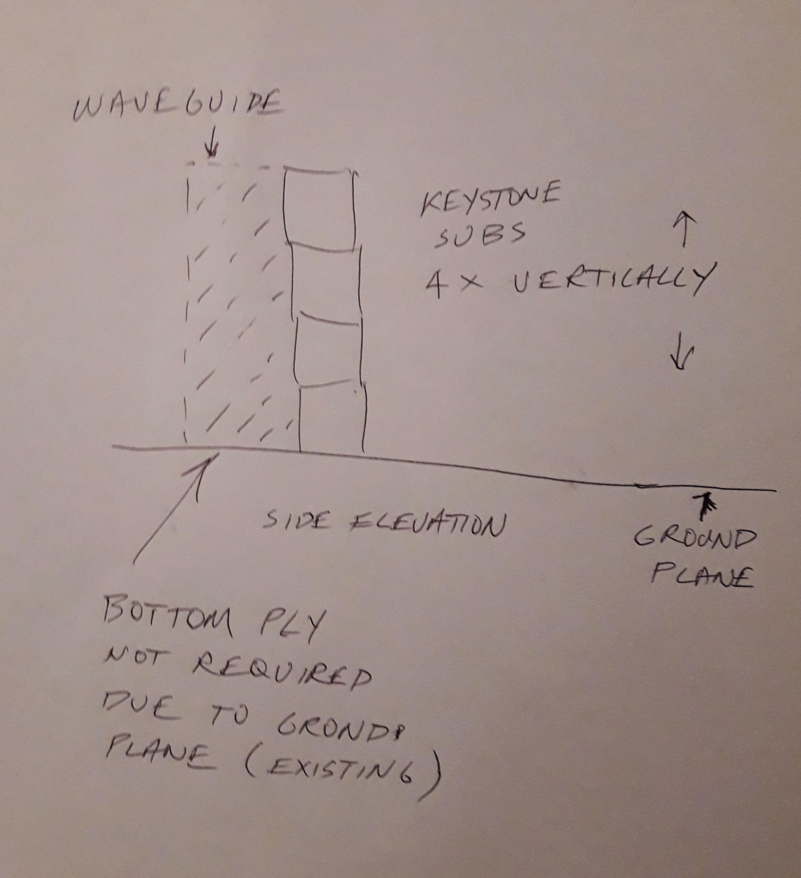

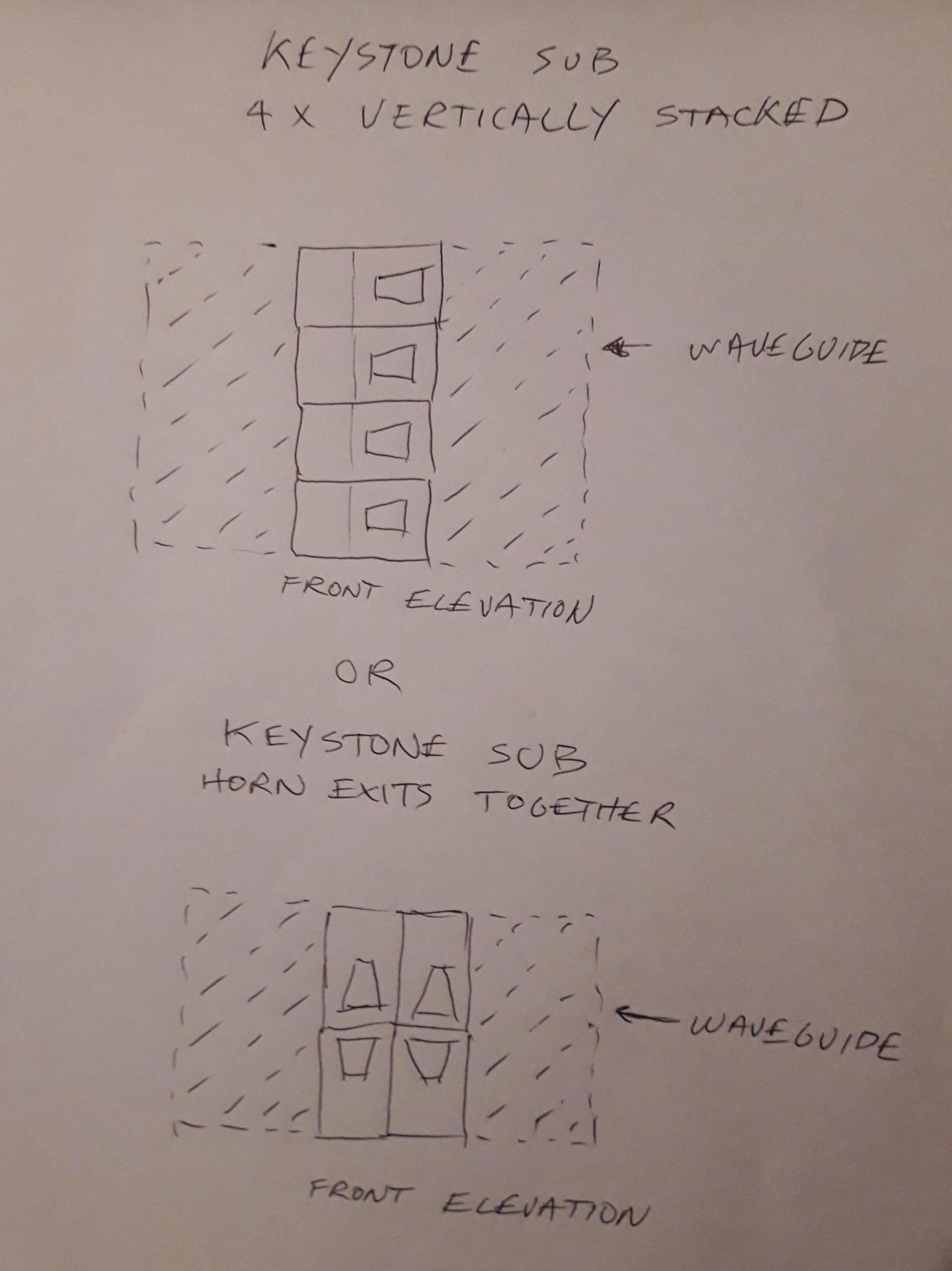

Hi Art,
loving the 2 keystones I've built so far.
Question: see attached sketches - would there be a slight increase in summation / SPL if the horn exits were together as opposed to just vertically stacked?
I'm progressing and building another 2 for a total of 4, and adding waveguides for a mono stack.
I plan on tieing the bottom waveguides, of the stack, together with a box section of aluminum tube - as I believe the ground plane eliminates the need for another ply boundary.
Thoughts ? - cheers Art
