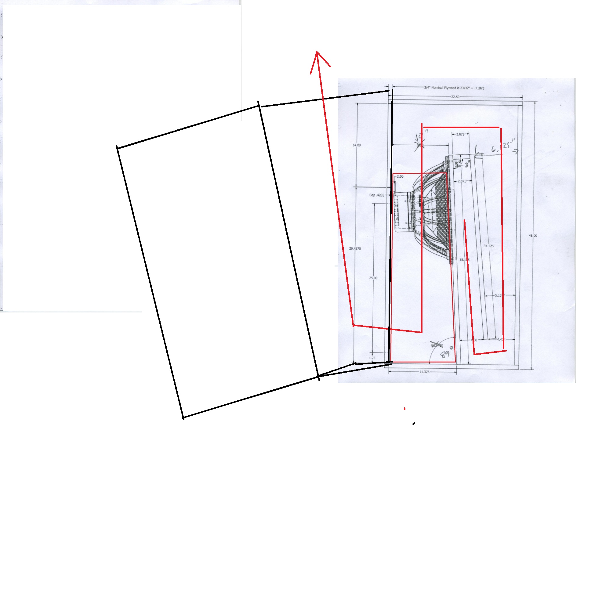

Can't seem to put this thing to rest. After some thought, I don't think a v plate could lower the system since the v would create a kink... But, if another panel was made to join the pair (on bottom) creating a "w-plate" maybe? I don't think it would too hard to build and install. I just eyeballed the angles and drew up my thoughts in paint, but I suspect this would really add to overall pathlength since it's so narrow, my guess its' like 15deg.
I have to admit, I did start to think about the KS mouth... Would the concept above work for a sub without the KS exit, like SS15/TH18
Hi Zwiller,
It works fine for almost any TH as long you don't want an extension that drops to low. In that case you need to redesign the complete thing and make a balance between best performance for both (both, with and without extender, will not be ideal).
Djim
