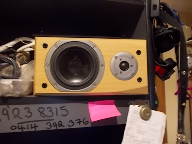

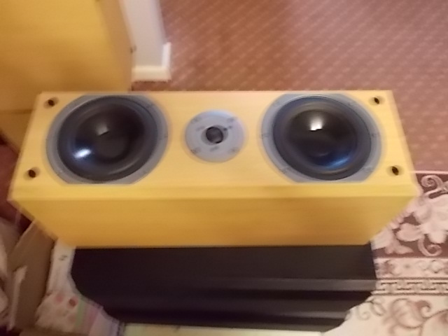

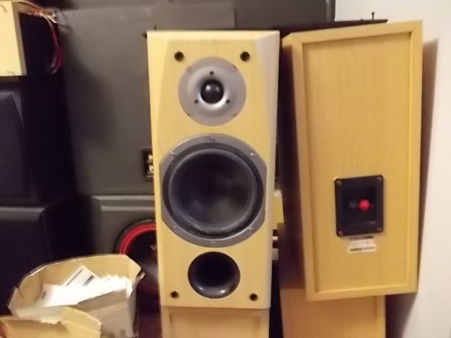

Sorry fellers
My first set of HT speakers were this "Set" of Sansui speakers.
Typical 1990s array with big main speakers using a 155mm woofer and a 25mm silk dome. a twin woofer front using the horizontal MTM using 110mm woofers and a 20mm silk tweeter with the surrounds being using the same little 110 woofer and 20mm silk tweeter in MT vertically
I've never been happy with the audio balance; to me the sound is always much clearer when all speakers are exactly the same
I've just bought another set of these Sansui and have 6 of the main L&R units
Not enough speakers for 7 channel audio

If you can find the speakers, look for two more of the MTM centers for the front three. Set a pair vertical, one horizontal (all ear level), then you'll have a noticeable improvement/upgrade.
Also there will be plenty of speakers to go around for the 7.1.

Looking at your Sansui pictures, is it true that the closed box surround have lower efficiency than the larger vented fronts?
They don't sound as good as the bigger units tho
I've tried that setup F R & C already and wasn't impressed after listening for a while
If I do use them in the new set-up where would you recommend?

yes the larger speakers are naturally louder, much louder in fact; although I haven't measured them and lost the documentation about 3 house moves ago.
The little surround speakers are actually vented, to the back but they sound better sealed and that's what I've done by stuffing the vent tube with compressed polyfill and using some fibreglass in the boxes
I wish I could remember the Sansui model number for this series; if I could find the large Fronts it would make things a lot easier for us
