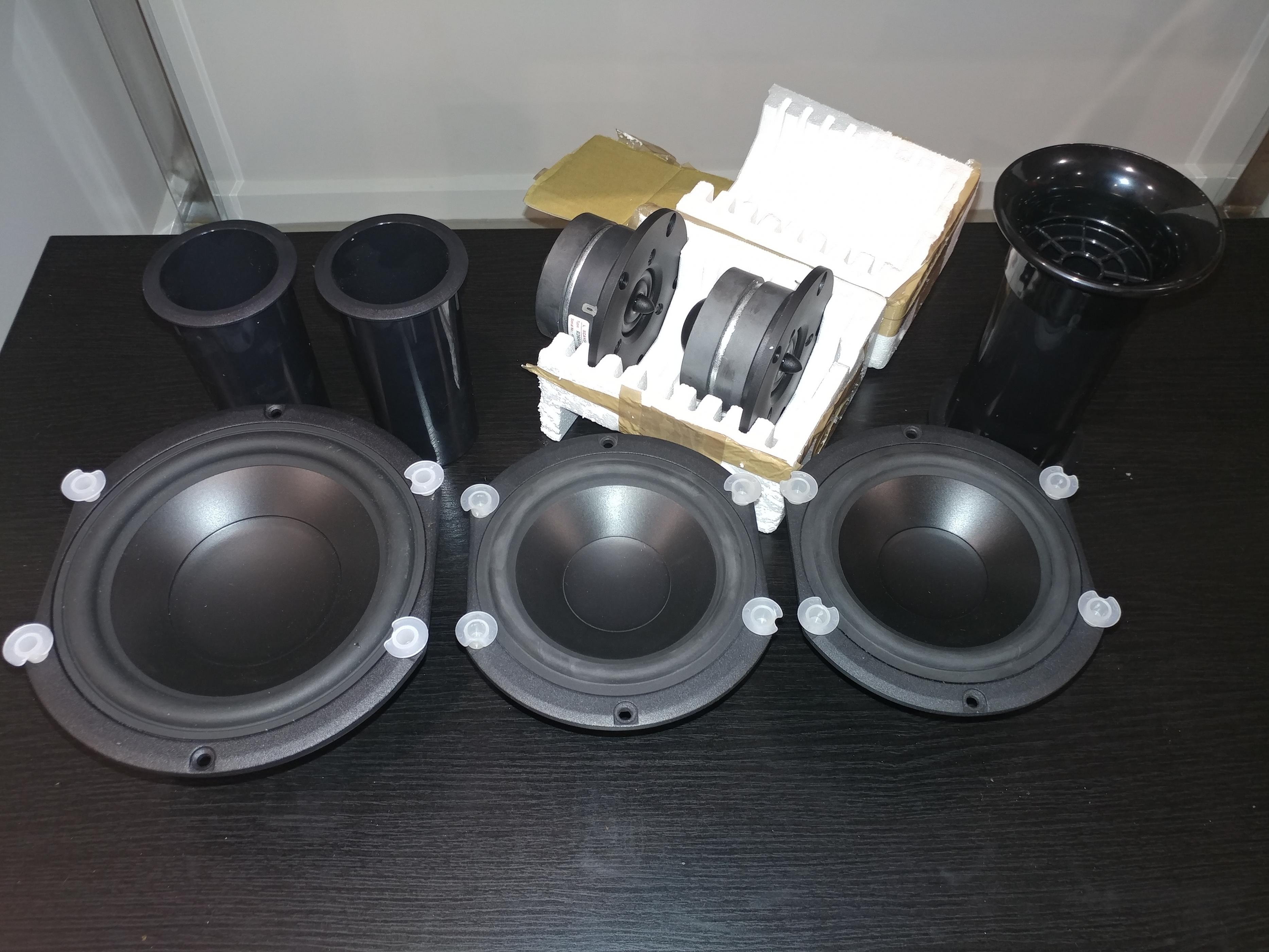

Thanks guy just going through all you said now, thanks. The Drivers arrived today yay!
Whatever happened to these crisp new drivers?
In some cabinets. Using them as surrounds. I used dayton caps, ceramic resistors, air core coils in a pretty stock standard LR2 crossover. 40mm port. I have a pair of 830860 aswell that I want to put into a desktop mono mtm bluetooth speaker. Im eyeing up a TC9 build for a smaller bluetooth speaker too but when I look into it I keep getting stuck with going a 2.1 amp board or a 2.0 board with a simple crossover with a woofer that integrates with the TC9. But thats all for well down the track.

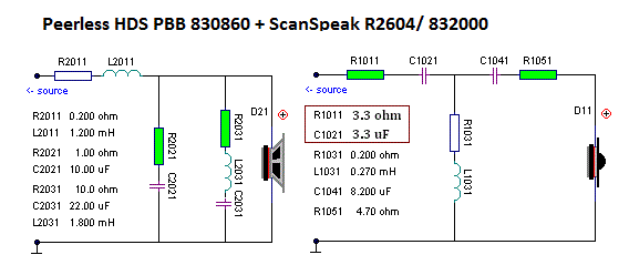

Here's a nice MT design with the 830860:
Peerless HDS PPB 830860
The R2604/8320 is just the smaller magnet version of your 8330. 2dB quieter so an easy resistor adjustment on the tweeter circuit.

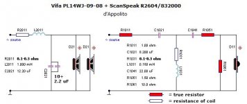

D'appolito conversion is also easy. Vifa PL14WJ-
That circuit will work with almost any 5" drivers. Below.

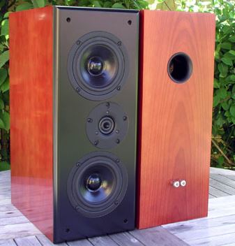

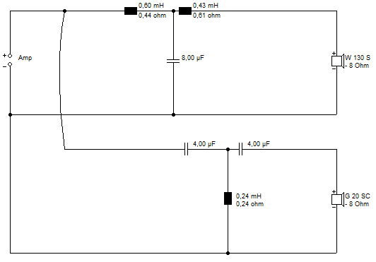

I have some pleasant 5" speakers which use the rarer BW3 idea which Joe D'Appolito advocated for MTM style too, this has different and better dispersion at crossover:
627369d1500943361-classic-monitor-designs-monitor-audio-ma7-crossover-png
627367d1500943361-classic-monitor-designs-monitor-audio-r300-md-ma7-top-jpg
http://www.diyaudio.com/forums/multi-way/147632-classic-monitor-designs-45.html#post5139615
IMO, at least 10-12L reflex per driver. 5" can surprise you with bass.

They need a LIKE button! Thanks friend! I will check this out. What Program is D'appolito using?
I use a very intuitive interpretation with Visaton Boxsim.
Find a similar project and similar drivers and you rapidly get an idea how it works. This Couplet Light MTM bpj project can be copied to the projekte file and fiddled with.
This is particularly useful if you need to reduce tweeter level 2dB in Troels' circuits. Which are easily inserted into projects like this. IMO, most good circuits will work with a whole range of similar drivers. It's easy enough to look at a frequency response for two similar drivers and figure out how that affects loudness.

I think you are in quite a happy place with your drivers, especially the 5" Peerless 830860 which is almost ruler-flat. We know the R2604-8330 tweeter is about 2dB louder than the 8320. Shouldn't be hard to build this MT Troels design: Peerless HDS PPB 830860
My old mate Troels is probably as lazy as the rest of us in using an existing 8L cabinet. But, IMO, you can use 12L and shorten the port slightly for deeper bass. R1011 possibly should be adjusted to 4.7R for correct level.
All you have to do for his MT design is adjust tweeter level down about 2dB. A very nice 5" speaker with a pleasant sounding ring-radiator. Possibly expensive scanspeak have higher quality control than cheaper Vifa. My only advice is that a 5" speaker doesn't go terribly loud without distorting. Just how it is. All, in speakers, is compromise.
