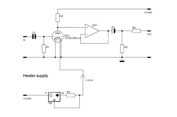

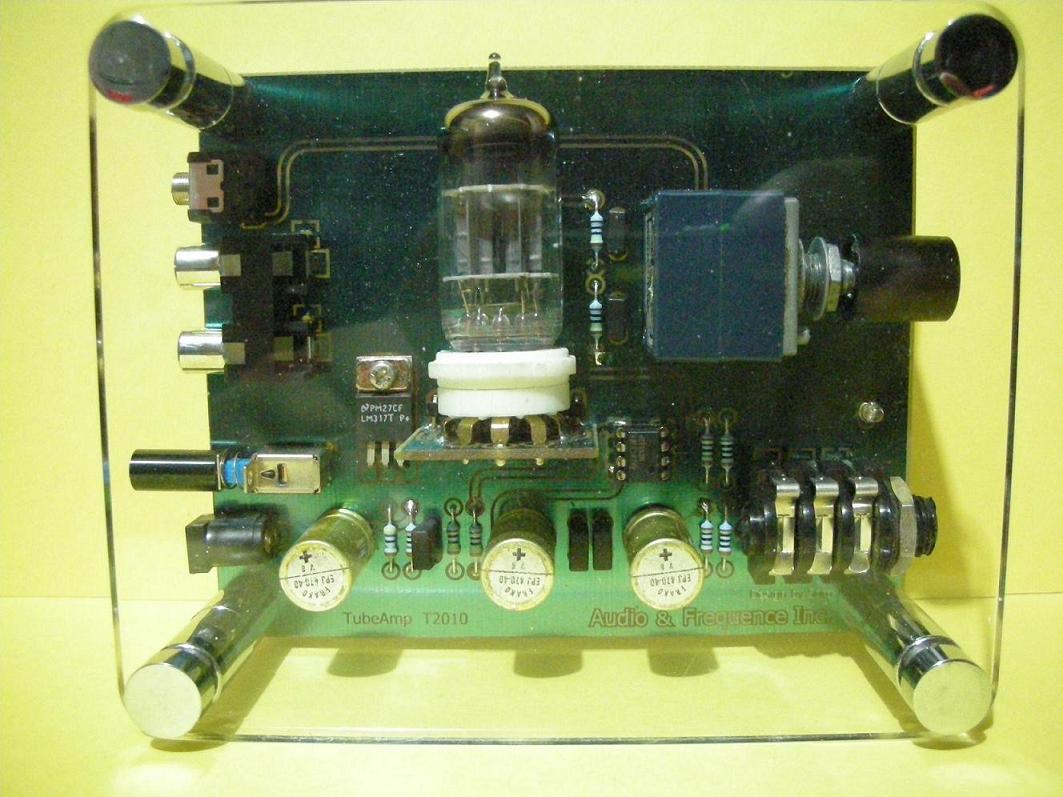

maybe you can try this one.
IT can ues 12AX7 or 12AU7 6DJ8 6922...

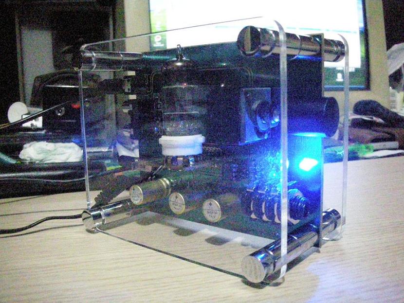

I used to have a 32V B+ mantle radio, which used standard miniature valves, the high plate impedance of Valves does not lend itself to low voltage operation, car radios and military field radios used vibrator based power supplies with normal 250 or 300V B+ You probably could make a small mosfet based voltage multiplier to get 32 to 60V B+, don't much power output though.
