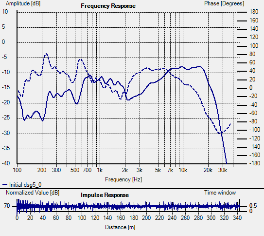

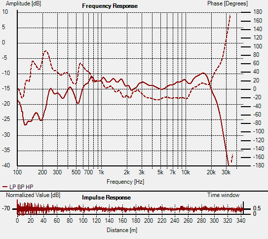

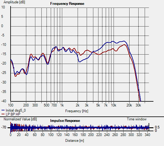

Attached is the before and after of my 3-way I am designing now. My mic is not calibrated yet so I am careful not base too much on the measurements except for the obvious.
If anybody has any thoughts on the curves I am open to them...

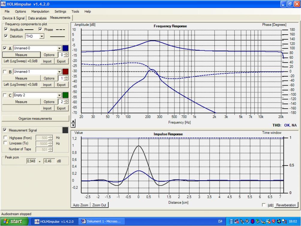

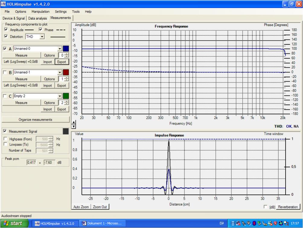

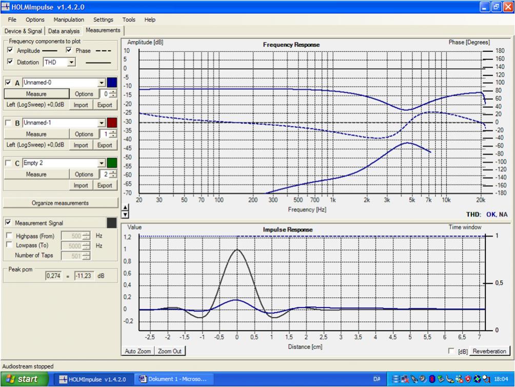

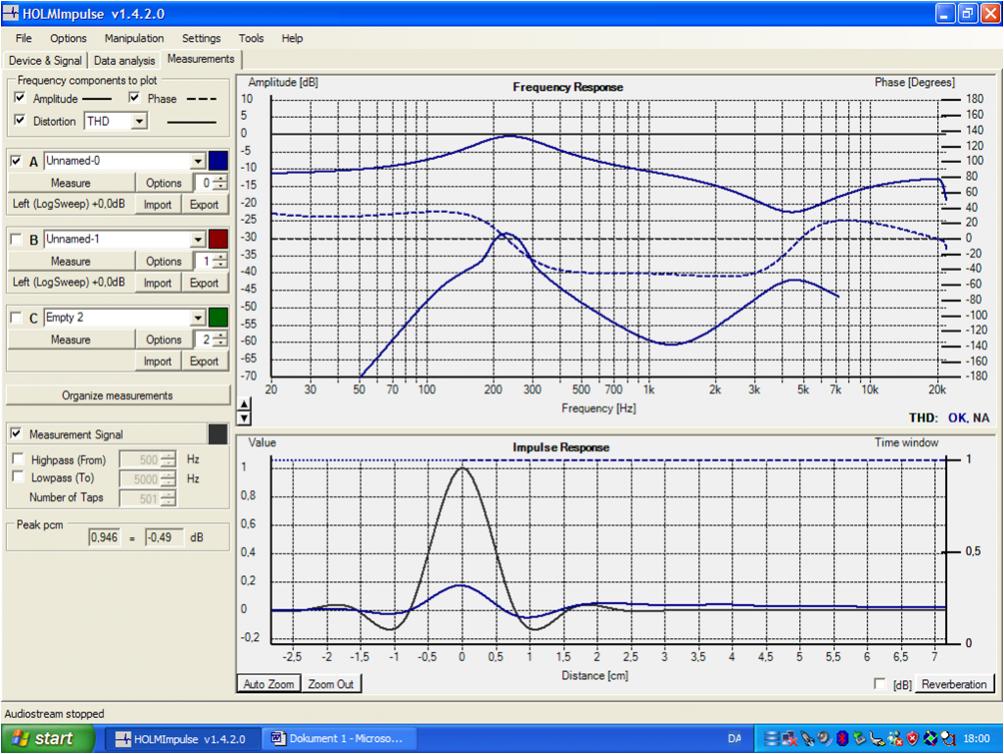

Ask asked me, at the recent DIYAudio event in Denmark, to measure how 'bad' a graphic equaliser really is. Here are the results:
First picture is all pots at 0
Second picture is 250Hz pushed to +10dB
Third picture is 4kHz lowered to -10dB

...And finally 250Hz at +10dB and 4kHz at -10dB at the same time.

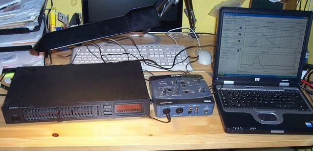

Second picture is the setup.
The equalizer is a Onkyo EQ-25, modified with paralleling elctrolytics with MKT.
Thanks to Ask for a super-easy measuring program.

Please notice taht I changed the scale for the impulse from the first measurement to the rest.
Please also notice that in neutral (all 0) THD measurement says "OK:NA".
....An I think that even in use, the phase-angles are not too bad, but ofcourse the THD rises quite a bit.
