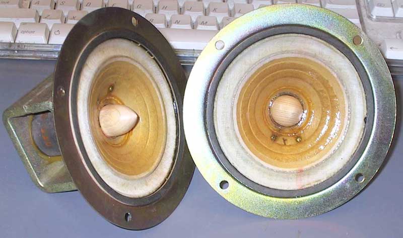

Old thread...loving the coral holey basket
Reviving a VERY old thread here I know, but just wanted to say that these little Coral "holey basket" drivers are superb. I've run them against a lot of bigger, and far more expensive drivers (lowther, supravox, altec 755, visaton, etc.) in an antique open baffle cabinet, and these are the drivers that live there for good now. Several years now in our living room system and NO ONE who hears them can believe the magic coming out of these little things. Its unreal. I own 3 pairs now...just in case. For what it worth...

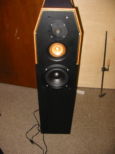

Found this thread a year or so back when I was trying to figure out what to do with a pair of bull nose cab large Advents. Loved the bass, hated those orange things.
Pulled the orange things and the crossovers, refoamed the woofers. Made sub baffles for a pair of holey Corals. Cobbled together a 2-way active crossover. Been in love with these speakers ever since. Darn things actually still surprise me sometimes at how good they sound.

Thoseare closely related to the Coral Holey Basket, but that is not the right basket. It is called the Coral Holey Basket because the basket has holes in it.
