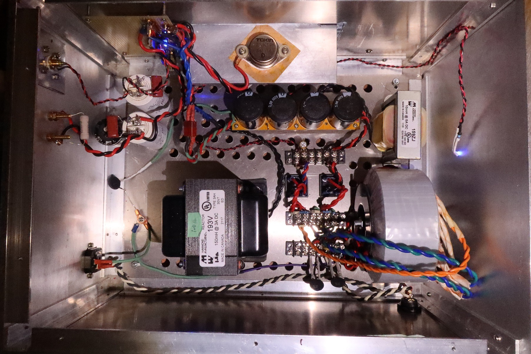

The Wakefield-Vette thermal pad in action in my 2SK180 choke loaded follower mono-block, dissipating approximately 90W:

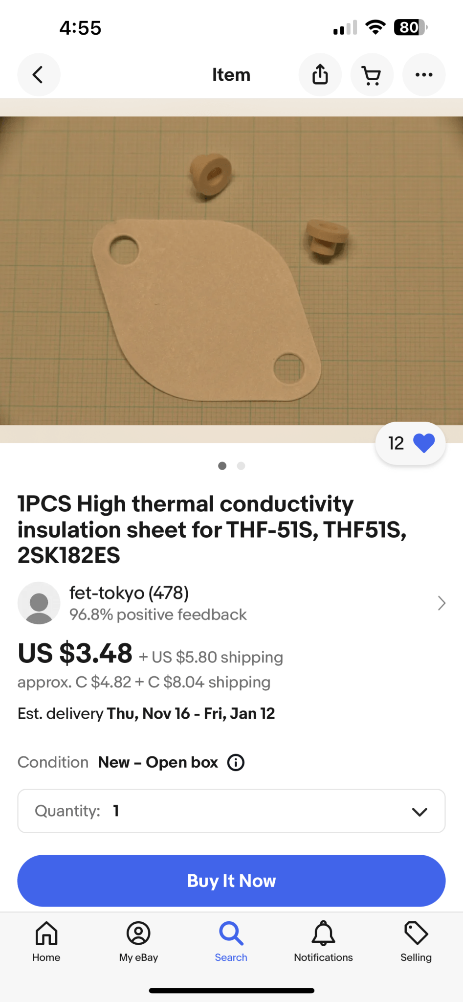

I would still like to pick up a few of those white insulaters for the 2sk180. But
the only listing I can find was on canuckaudiomart and that listing has expired.
I know there are other options but those white insulators would make a good
guide when drilling holes in my heatsink and I just like the looks. Oh I know
there are several other solutions but would prefer to use the white insulators.
Or if not does anyone have a drilling templet for use with these,

Are you talking about these ?
