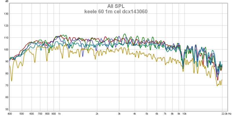

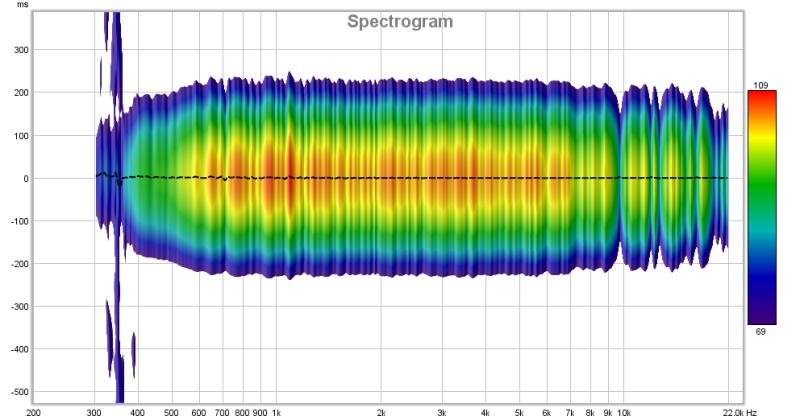

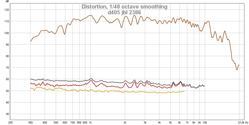

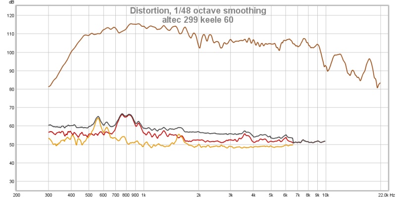

Celestion midformat cdx14-3060
I always like the small format celestion drivers so now i have the mid format driver to evaluate.
this is measured in room 1 meter in ev keele conical expo 60 degree horn. big horns - i attempt to measure at axis 15, 30, 45, and 60 degree. not so easy

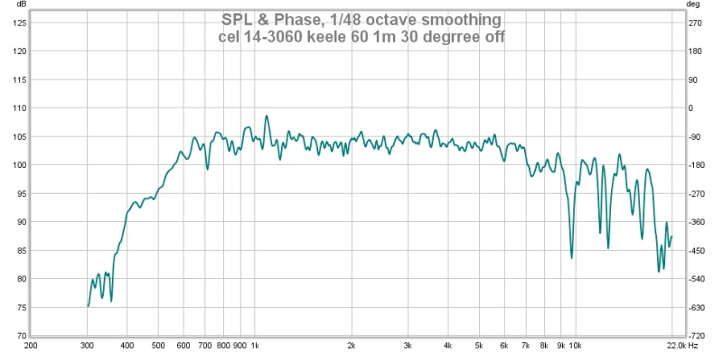

and here at 30 degrees, probably what to expect at listening position
this combo is a very high end upper midrange low treble system

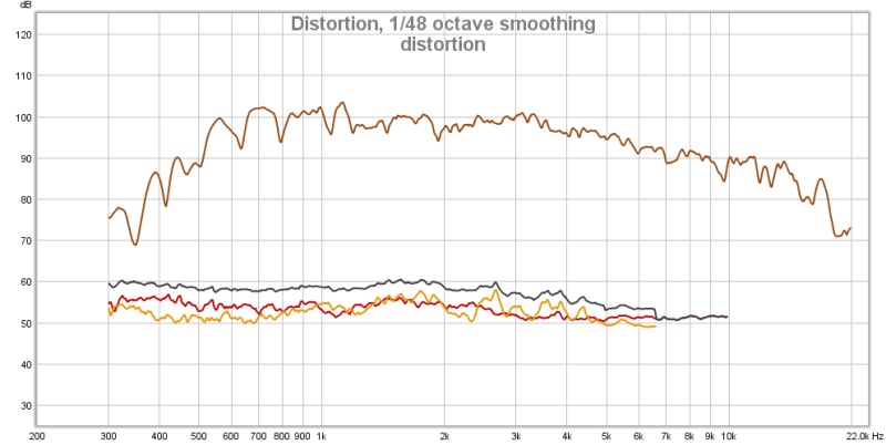

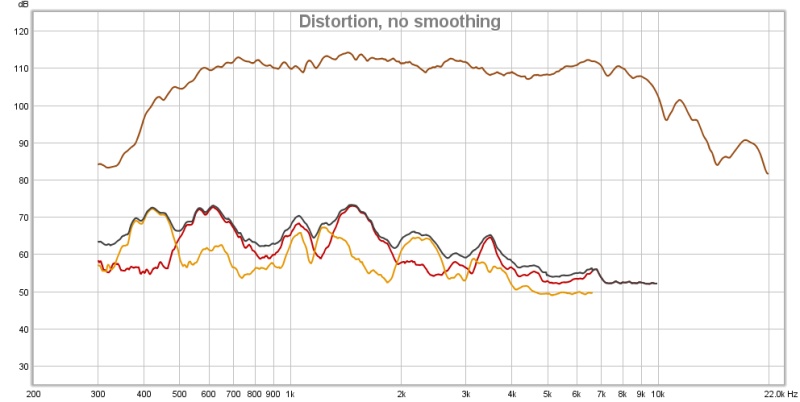

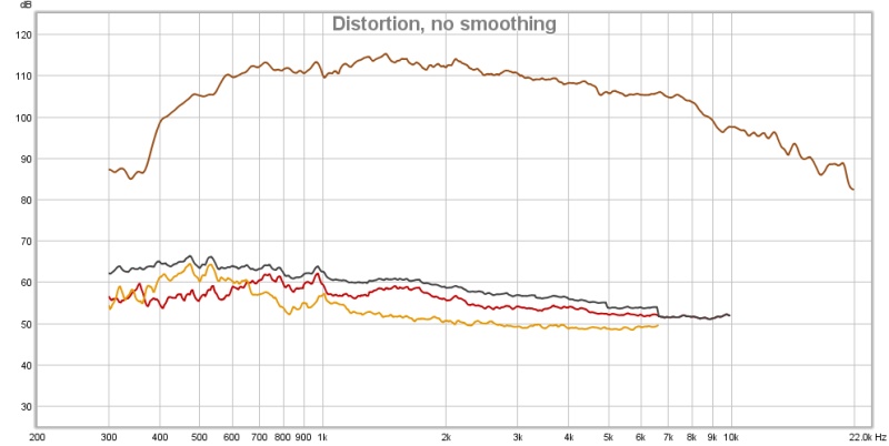

distortion is not too bad, real large format 4 inch drivers can be better bit this is much better than the be jbl 2435 and altecs 288, 291, 299 i have here

Can you do the graphs at 5 Db increments please, I thought it is normal practice. don't mean to sound rude but for us newbies it is a bit distorting and the bigger the scale the better it looks. We all need a refrence to what is good n bad
