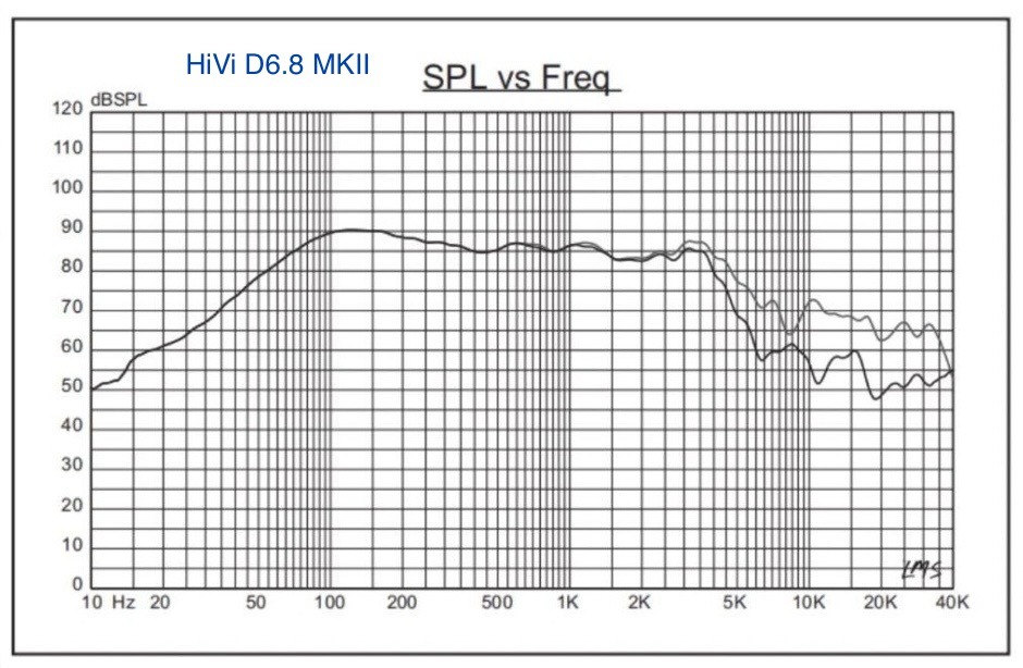

Next, I was curious to see how the new driver would perform in the same enclosure volume and vent dimensions, so I ran some WinISD simulations based on the provided data. What I was hoping for is less bass compared to its predecessor, mostly because of some unpleasant room modes I was experiencing with the Swans speakers before. Don’t get me wrong, it’s not that I don’t like bass, but what I wanted to accomplish with the new speakers is to overcome the typical problem with so many vented speakers nowadays – the excessive bass as a result of non-flat bass reflex alignment:
Many speakers are intentionally designed that way. I reckon, this is a great selling point for the speaker manufacturers – everyone loves bass and this is a way to squeeze lower F3 from a relatively small enclosure. Unfortunately, it comes at a price – degraded transients, lack of punch and somewhat loose bass. The way I understand it, this could be a consequence of using a driver with higher value of Qts (>0.4). With slightly lower Qts than its predecessor, the new D6.8MKII has prompted me take a closer look at it as a potential candidate for my new project and the WinISD simulation turned out to be promising:​
For comparison the two graphs look like this:

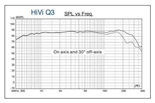

While not really what I wanted to see, it seemed like the new driver would do the job I was hoping for. Eventually, I decided to build this MKII version of the same Swans speaker kit with the new mid-woofer from HiVi. As for the tweeter, I have opted for HiVi Q3. This tweeter has relatively low resonant frequency and its frequency response is nice. Besides, it matches the visual aesthetic of D6.8MKII and it fits perfectly well within the recessed space which is originally meant for Q1R:

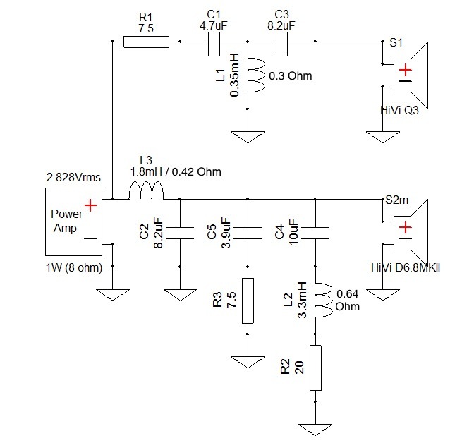

With these speakers I wanted to challenge myself and see if I could do a better job in terms of proper phase tracking and baffle step compensation. The result is a combination of 2nd and 3rd order electrical filters (for the woofer and the tweeter respectively). I have aimed to cross at around 2 KHz:
Since the value of R2 and R3 are a bit unusual, I’ve put 8.2 and 22 Ohms resistors instead - don’t think that there’s a big difference.
Below are the snapshots from XSim with normal and inverted tweeter polarity:

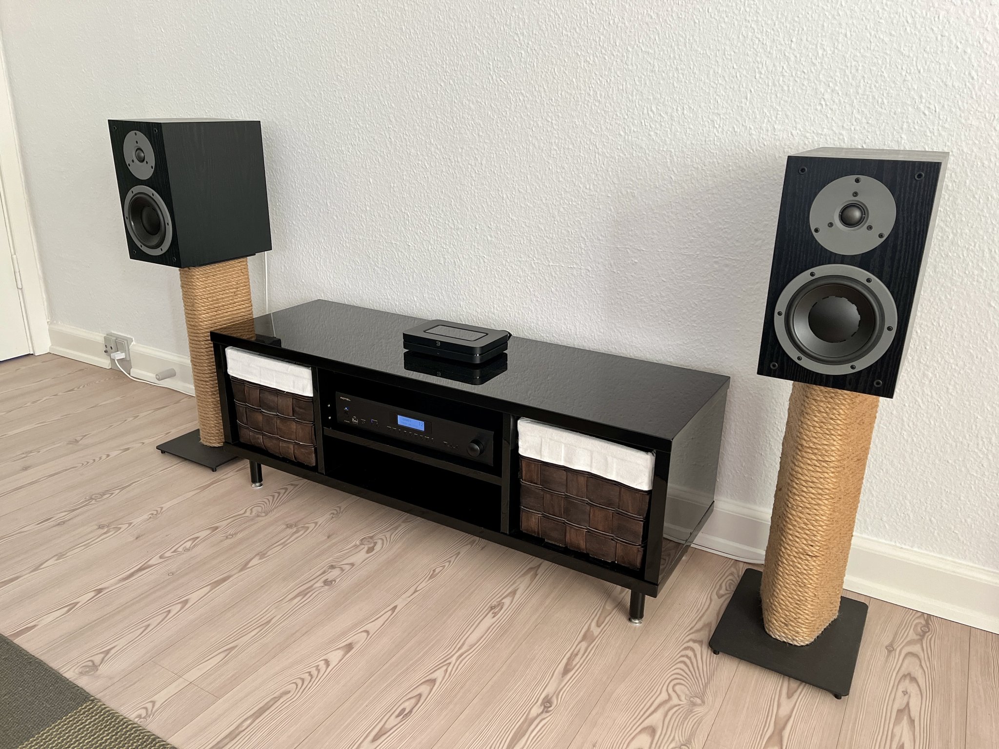

Lool it looks like Dynaudio copy
Yes, that’s right – they bear a striking resemblance to some Dynaudio models. For someone who used to have Dynaudio speakers before, I have to say that there’s more than just the physical similarities between them. That being said, it was the disappointment of the Dynaudio brand in general that drove me to the world of DIY. I don’t say that they can’t make decent speakers, but for that one has to climb up the price ladder significantly. In my experience, their entry-level models are rubbish, and they are not cheap at all.​
I like the dual-purpose stands. Looks like a good design. Thanks for sharing!
Thanks, you’re welcome. As for the dual purpose look of the stands, I don’t have a cat if this is what you’re implying. It’s just for decoration purposes as my partner can’t stand the original look of the stands. It’s simply the spouse approval factor in action :)
