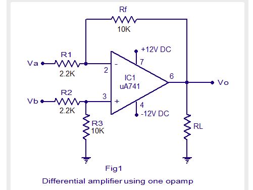

Thermal noise in amplifiers and sources is inevitable. It's one of those features of nature. Jodrell Bank space radio telescope would cool it's receiver in Liquid Helium to minimise it, but it it's to do with Boltzmann's constant and the laws of thermodynamics. :)
An amp designer has to balance many features for a good sound, and the best you can do is minimise it for good signal to noise ratio and efficiency, wide bandwidth, low distortion and good common-mode rejection. It may be your speakers are on the efficient side at 4 ohms, and without a valve like impedance matching switch, you are just stuck with it. After all, the object of good engineering is not perfection, but performance that satisfies 95% of your customers.
The simple circuit below will have better signal to noise with low value resistors, but then loses efficiency and is harder to drive. Trade-offs. :D
