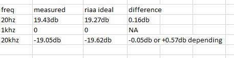

Ive tried putting the tubes in but that doesnt seem to be affecting it too much. However,
from the article....
"Trimming the RIAA network isn't too hard. Adjust the buildout resistor R7 to get the 1kHz response to be 20 dB below the 50Hz response. Then adjust C4 to give response at 20kHz at about -19dB with respect to 1kHz (if you're using the Missing Zero) or -19.6dB if you're not."
1. Im finding that lowering R7 (20k) reduces the ratio between 50hz and 1khz not increasing it.
2. According to the RIAA db chart ive found I think that the 50hz to 1khz should only be 16.95db, 10hz to 1khz should be 19.74 (close enough to 20db).
3. Reducing my R8 (I used a 3.15k resistor) with a 15k in parallel sorts the ratio out almost exactly.
4. Adjust C4 to get between 1khz and 20khz. Shouldnt that be C2?
So,
Sticking 15k across R8 (giving ~2.6K) and an extra 3n3 on to C4
gives me the following
Im not using the 91R resistor, thats just shorted but that seems to be giving me the response as if i were.
I really dont think i could hear 0.5 db at 20khz so i think thats probably close enough.
