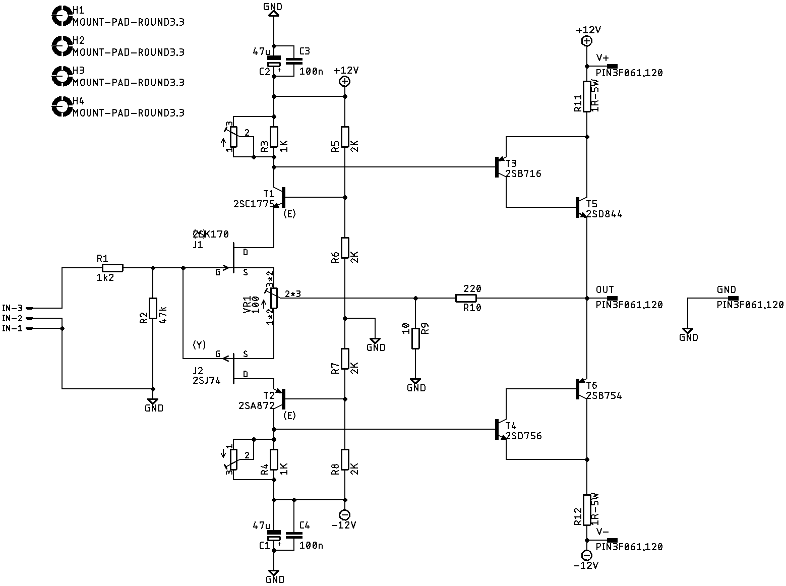

The drain and source of jfet pins are inverted in your layout and schematic.
Hello bluevas, Isnt source and drain reversible for JFET? I see some layout where drain is connected to trimmer pot and some layout have source connected to trimmer pot.

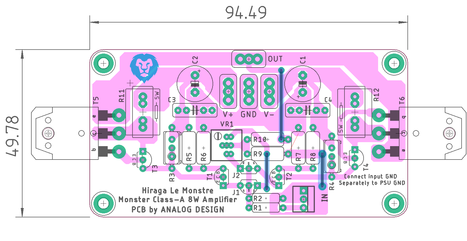

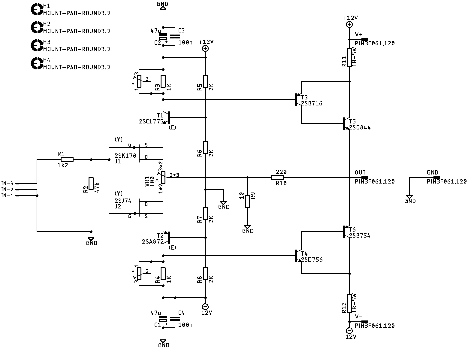

Though I got confirmation from 2 builders regarding JFET orientation makes no difference, here is the one with JFET drain connected to BJTs.

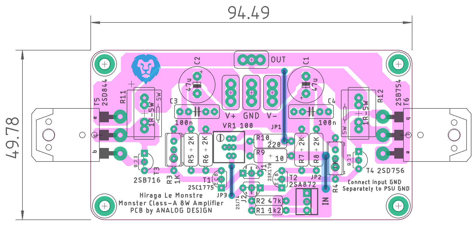

Hi Prasi
This is the way I usually see the jfet being connected.
Looks like double sided pcb. Is it possible to get the Gerber for this latest edition? I haven’t verified the pcb but I like what you did ! Pls check, there is a red line inside R7.
Maybe I’ll run a small batch, it’s been a while I haven’t send one to PCBway.

Hi Eric,
Sure , will share the pdf and gerbers here. The redline indicates that Input ground is to be connected to PSU ground, which is already mentioned on the PCB, so no problems there.
