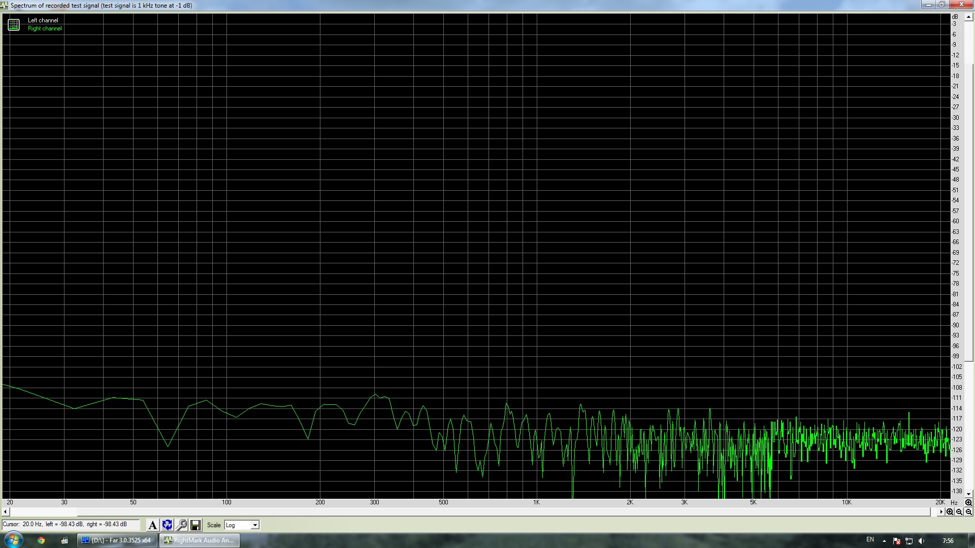

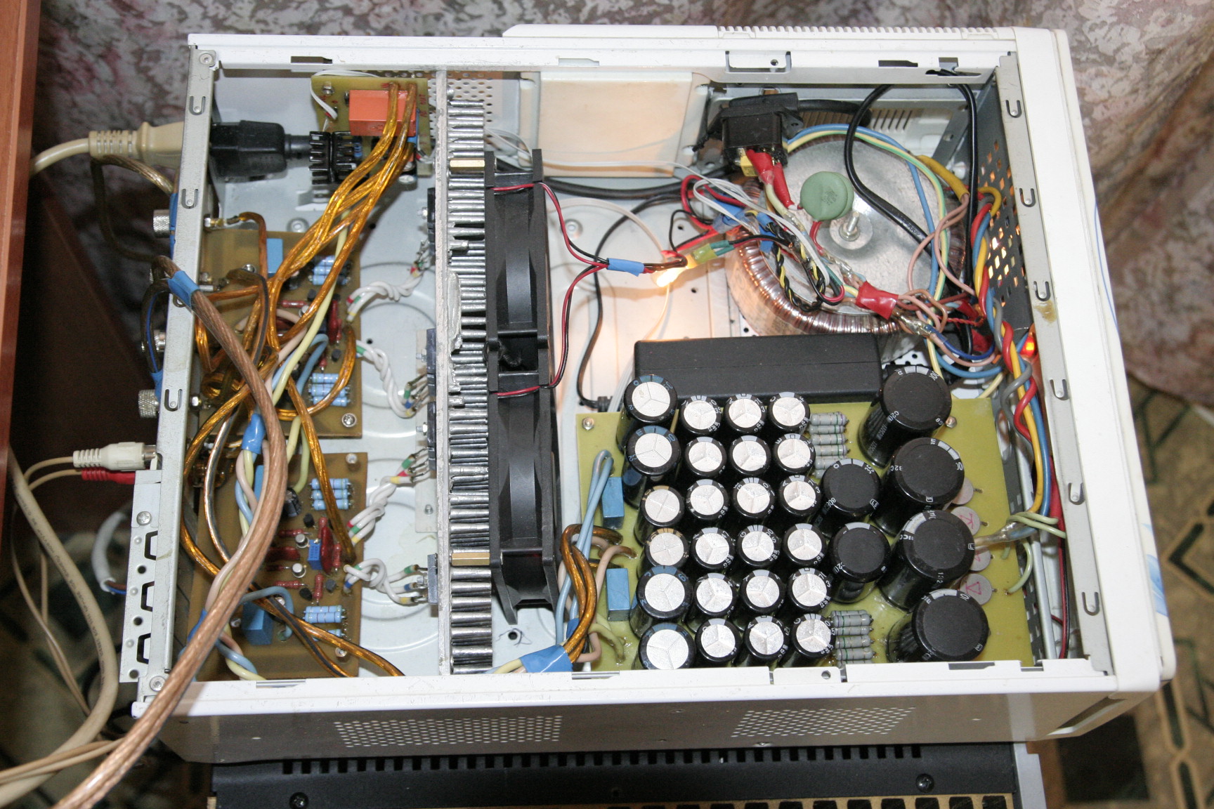

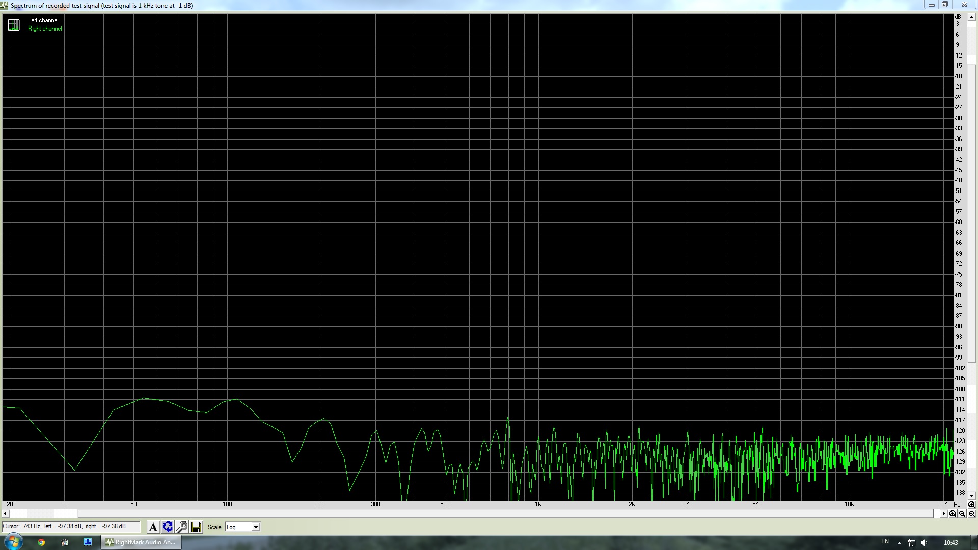

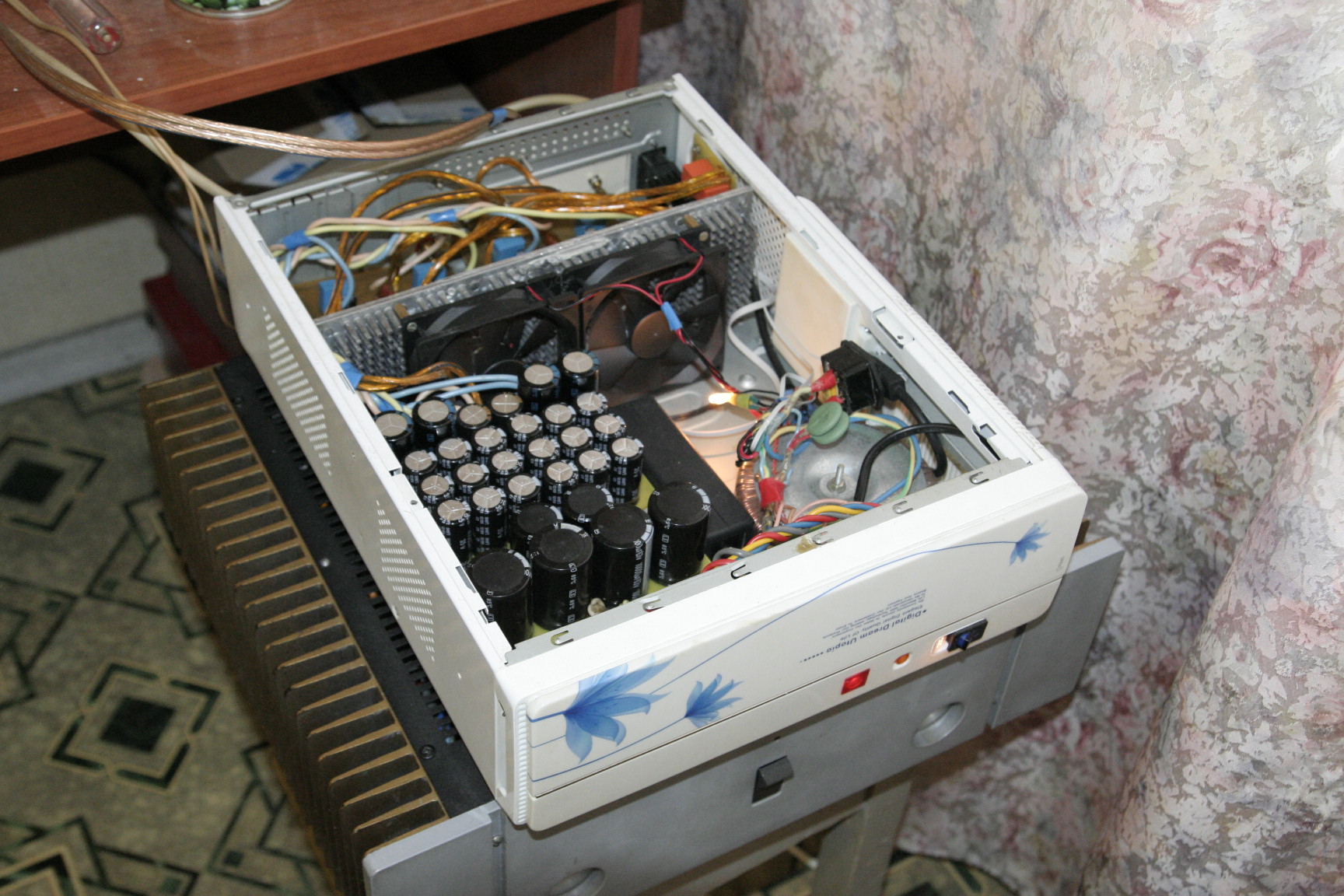

Le Monstre 8W Test Board. (maximum self noises level -110 db, small 0,18F filter, transformer 2*18V*4,4A, Resistors 0,25W 0,1% 5 ppm, ECAP on board - Nichicon VZ 470uF*25V+Epcos MKT 1,5uF*250V and mica 560 pF on input RC, bias 0,7A).

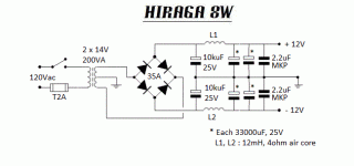

Would the attached schematic work ? It works great (CLC) in reducing hum with tube amps and it did the trick when I built the De-Lite amp.
With a bias current of 1A/ch would the amount of capacitance be enough ?
Thanks,
Eric
Thanks,
Eric
Use PSU2 to model it and see what you get at the output. You want the ripple to be less than 1mV which is a tall order indeed. You probably need more capacitance - but the good news is capacitance at these voltages is relatively cheap.

Having an inductor with a DC resistance of 4 ohms is way way too much. (is't it 0.4 ohms? Can read the schema good enough)
The CLC values look good although for a first cell a lower C would be good (reduce inrush). having CLCRC with R=0,2 ohm is also good imho.
Of course it is small but the L does a good job.
Hiraga had in the base concept something like 3x33.000 uF but these were the big screw can types - nowadays everyone has smallish units that even boast a good low ESR on paper - but in practice they cannot sustain a high ripple (for instance in a first cell).
