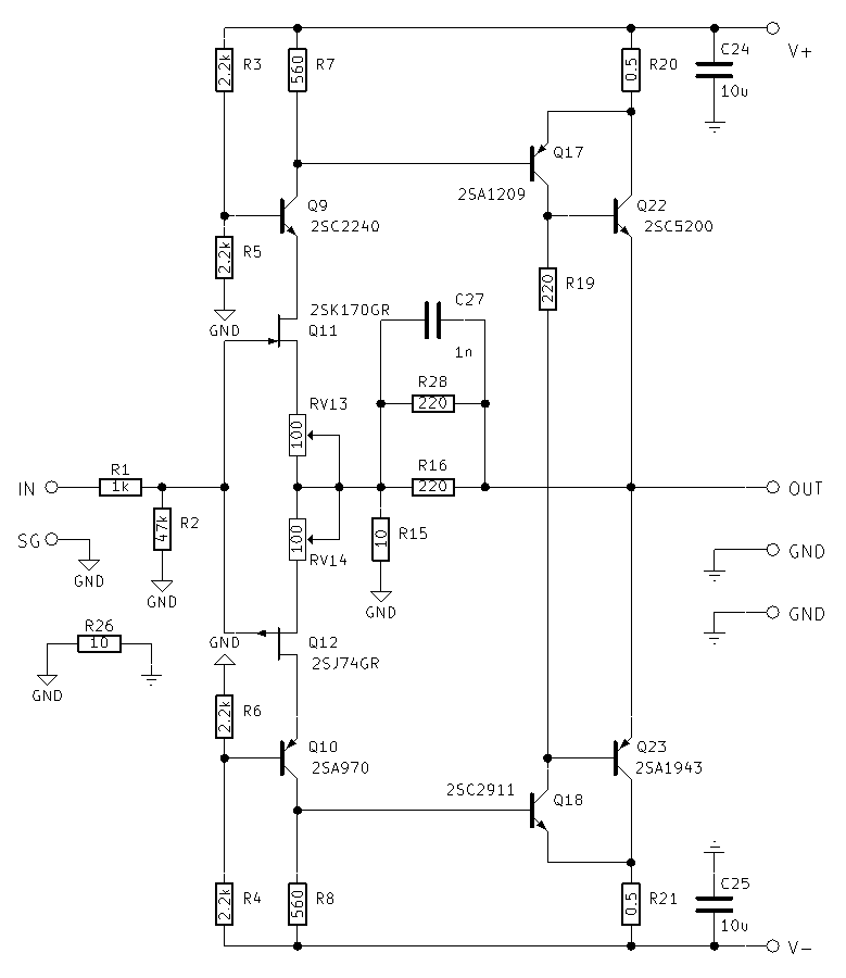

I post the Schematics for the higher power Hiraga Le Monstre, maybe it will have some interest and we can order PCBs together (run a small GB). Herald Knut uses 18-0-18VAC power TRANSFORMER. This would produce enough power it could drive my Visaton speakers with ease.

Apparently the first link doesn't work. So try again :
www.diyaudio.com/community/threads/hiraga-le-monstre-2024.413301/post-7695896
See PDF attachment :
"More Power for 4 ohm ?
Knut Harald Nygaard [1] did post a 24V version of the Le Monstre on his website, using GR grade JFETs, Toshiba BJT cascodes, Sanyo 2SA1209 / 2SC2911 drivers, and 2SA1943 / 2SC5200 for the output. But for +/-12V output into 4 ohm, 19V rails and 1.7A bias would be more optimal, with the output device dissipation limited to 33W, pretty much standard in numerous Class-A projects. The temperature above heat sink for the output devices is a healthy 30°C, but now the drivers will have to take 300mW each. 3x Onsemi TO92s in parallel would be required if we do not want to sacrifice the high hfe. Alternatively, KSC3503 / KSA1381 could be used, keeping the low capacitance and providing much more reserve for current delivery, at the expense of 3x lower hfe. It is worth mentioning the addition of a 220R resistor by Nygaard between the bases of the two output devices, “introduced to limit the current variation in the driver transistors”. It adds 6mA to their DC bias current. At least in simulations this does not seem to improve things. The open loop gain, just like the Pass F5, is load dependent. With 4R load, this is halved compared to8R. To compensate for this, one could reduce the gain by increasing the 10R feedback resistor to 20R. The output impedance is still something in the order of 0.7R. So the speaker should have relatively flat impedance over the audio band."

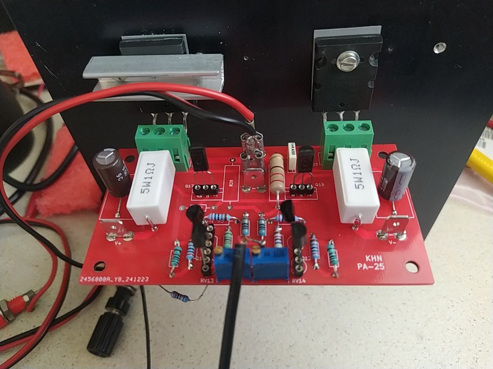

Just another Le Monstre builder here.
I have finished one channel, using Knut's modified design and PCB (thank you Knut!). I used BL JFETs, with resistor current bypassing, original cascode and driver BJTs and Toshiba 2SC5200/2SA1943 output transistors. It was powered from a laboratory PS, in order to have a first impression (I always do that, before I decide whether I like the built project, before finalizing it with proper PS etc.).
I'm playing it with 12.5 Volts and 0.55-0.60 mA, which gives me ca. 6 W at the start of clipping. Here, I must note that I use a pair of quite sensitive horn loaded speakers (Tune Audio Marvel) with a sensitivity of 97dB, so 6 watts is ample power.
My first impressions were great. The amp is very precise, analytical, with powerful yet controlled bass, very nice instruments separation. In all, a very pleasing and accurate sound. In order to have a reference, I compared it to Juma's Cubie 2 (with Exicon lateral MOSFETs), which I considered a very good amplifier. Well, Le Monstre beat the Cubie by far.
I tried playing a little with the idle current: I increased it to ca. 0.9 A, but I immediately went back, as I found the sound quite aggressive (I remember reading somewhere here that the ideal Ideal current for the Le Monstre is from 0.5 to 0.6 A. Also, I want to try different output BJTs that I have gathered, in particular: 2SC3284/2SA1303 (Sanken), 2SC2837/2SA1186 (Sanken) and MJL3281A/MJL1302A (On Semi).
So, I think that, so far, Le Monstre is a very promising amp. Next step is to build the second channel and listen to full stereo.
