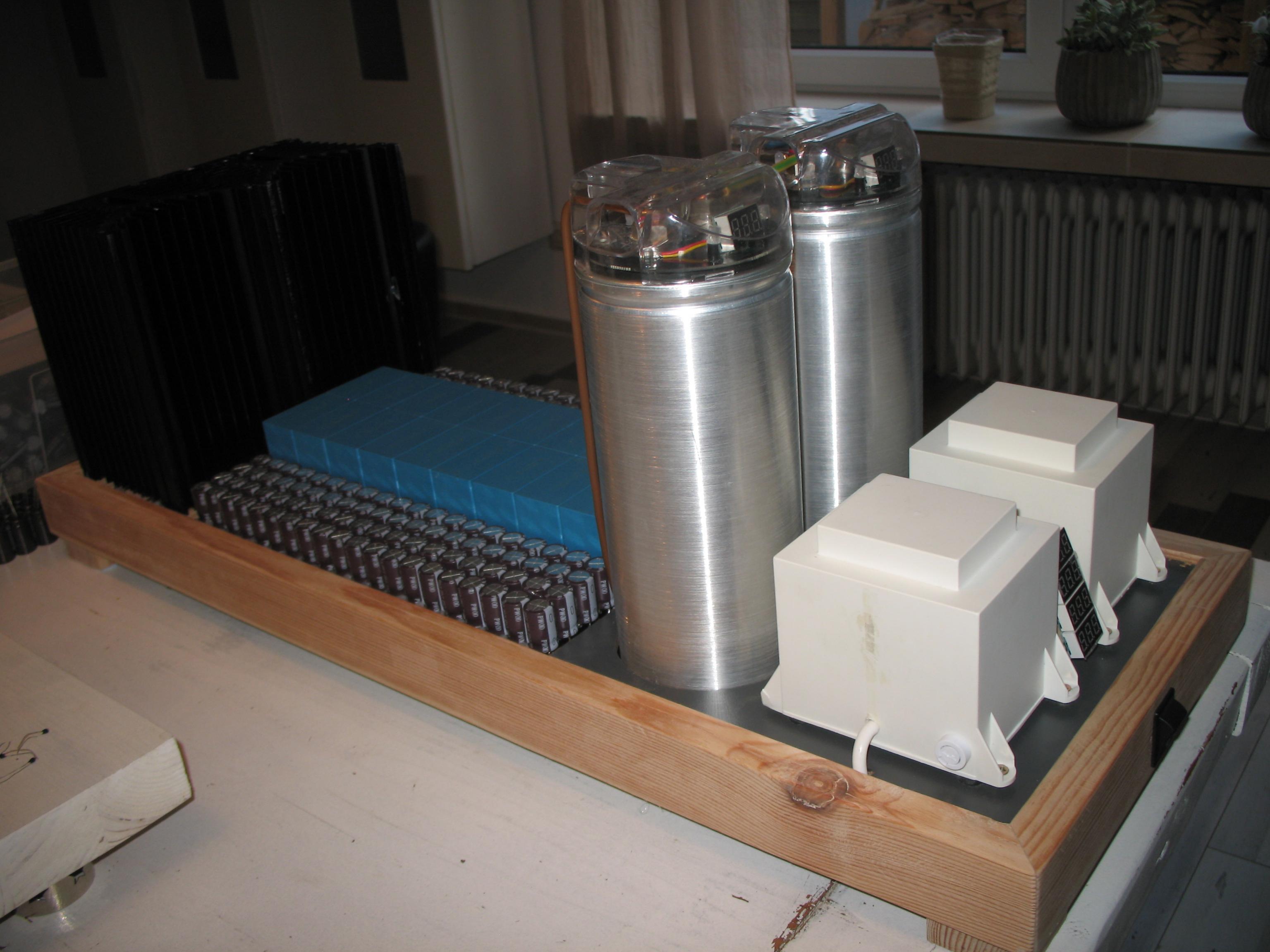

Probably the latest supercaps are better than the car caps.
If i remember the reason why the supercaps where used some decades ago was not something like low ESR but just the effect they had on the stability of the dc voltage.

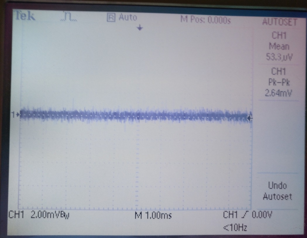

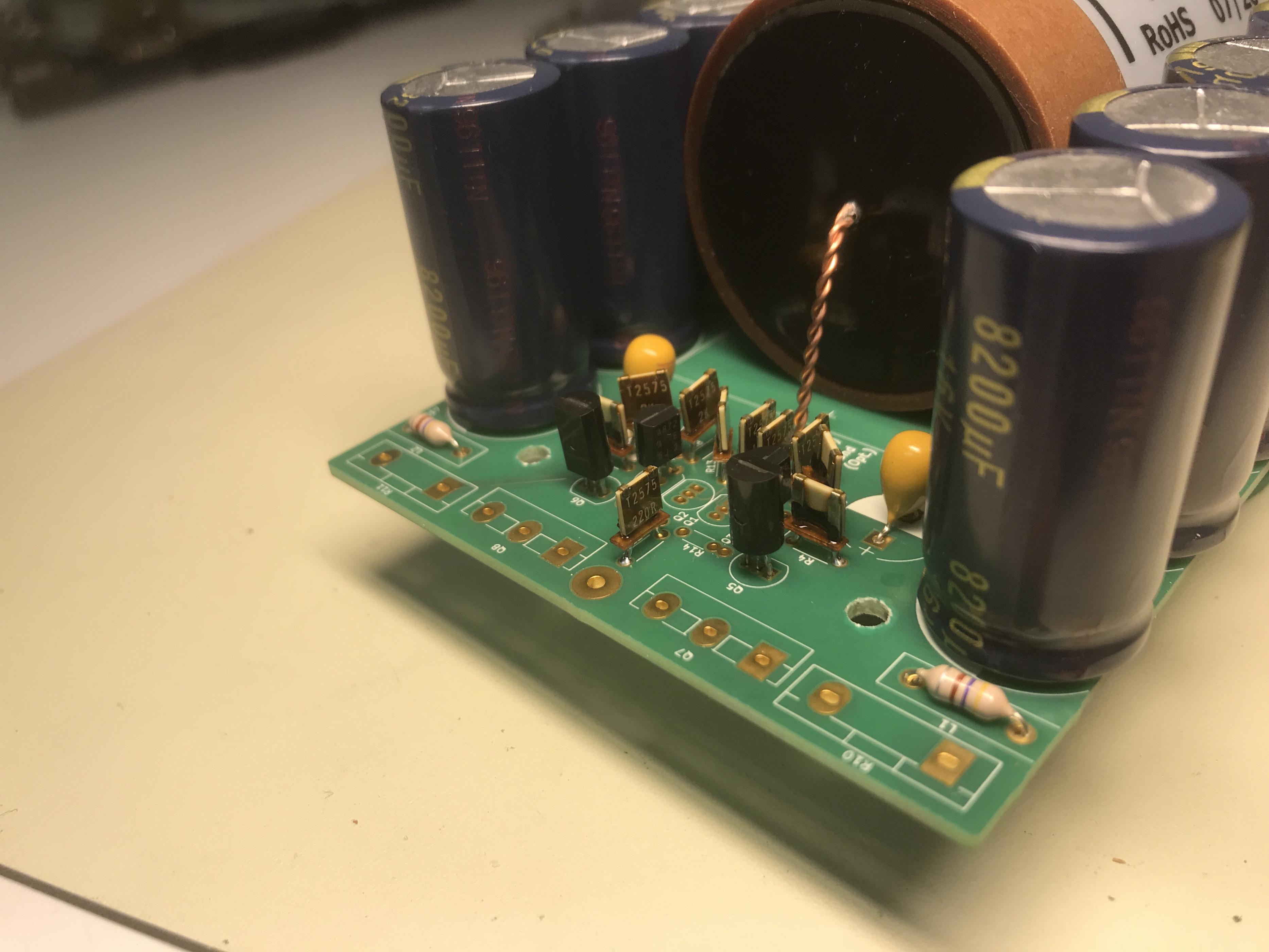

A couple of days ago I replaced the references in the regulators in my Le Monstre, instead of the LM329 I made four Walt Jung LED references for 6.9V. I am very pleased with the result, the change in the sound was immediately felt, there are more details in the sound, the highs are more fluttery, the bass has a kick and it is more controlled.
Unfortunately I don't have the equipment to measure the noise of the regulator because it is below the sensitivity of my oscilloscope, but after the change in sound it is immediately clear that the new LED reference is better than the popular LM329.
Something like that.

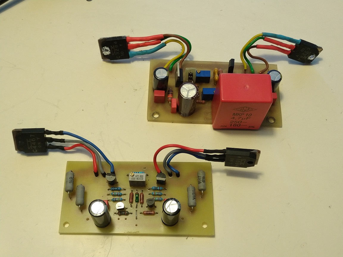

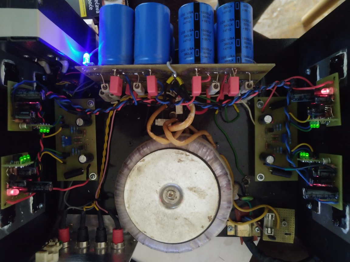

Le Monstre replaced the JLH69 a little over half a year ago and since then something has been improved though not as much as on the JLH69.
I changed the output and driver transistors, and inserted non-inductive 0.5R resistors, and now these new LED references in the regulators.
I am very satisfied with the sound, I listen from classical to electronic music and it works great with everything.

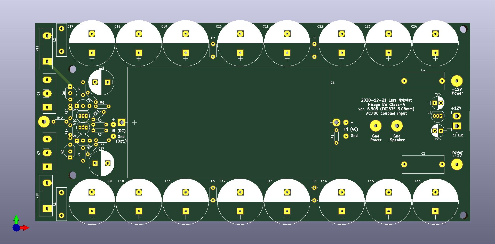

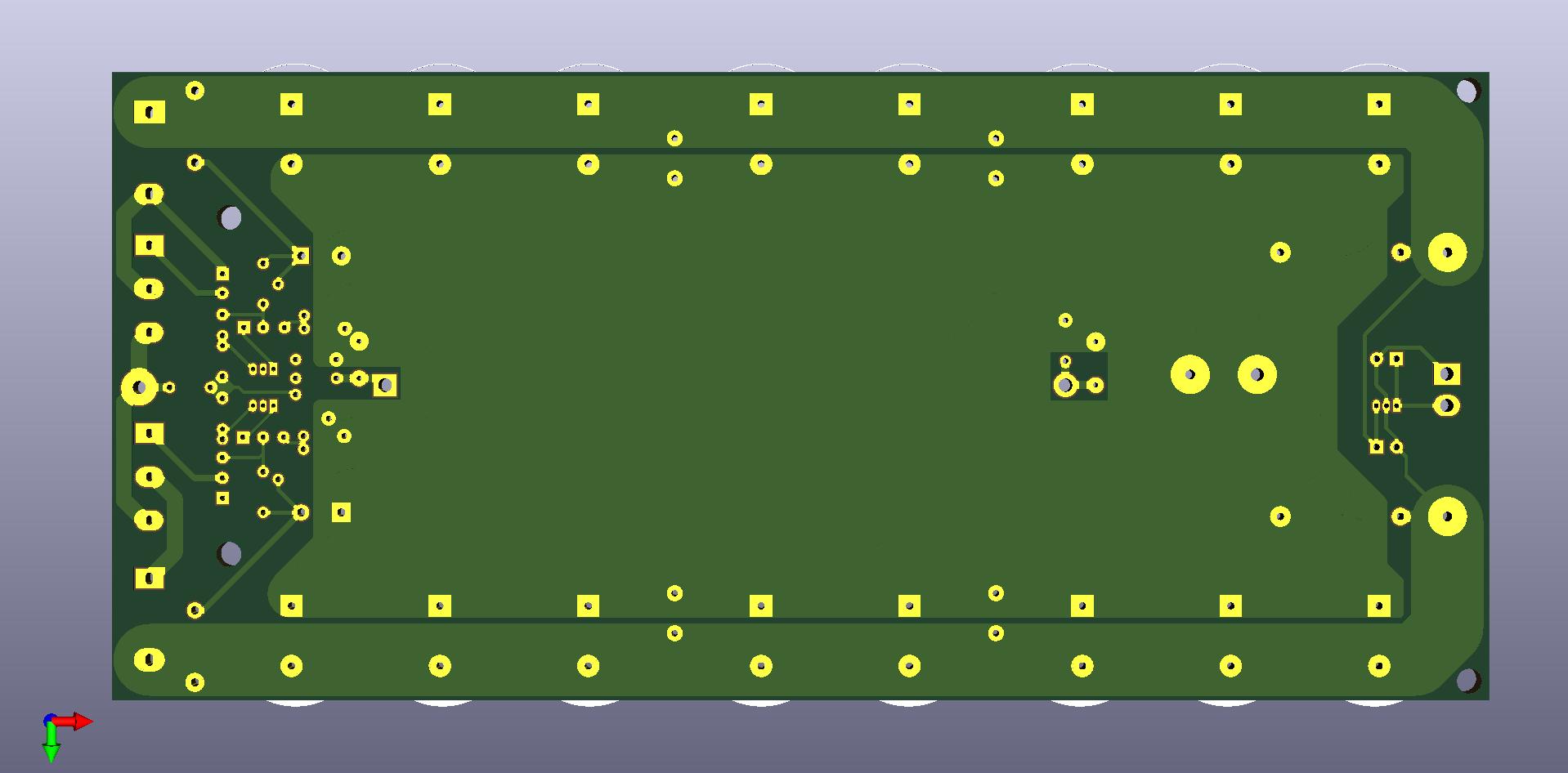

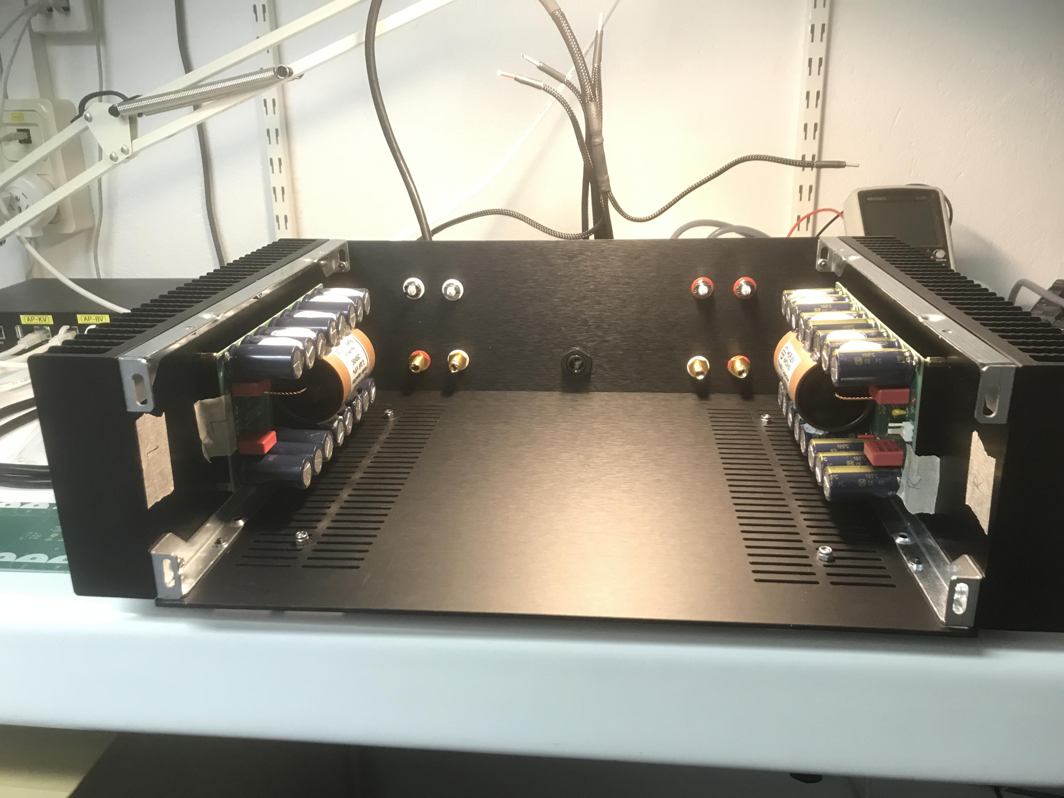

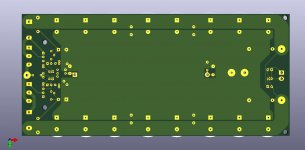

I found this Hiraga forum now.
I am building my second version of the Hiraga amplifier right now.
Designed my own pcb with KiCad to get the design I want.
All input transistors are tied together for example.
Almost finished now but missing the 2SJ74 jfets, delivery problem.
Waiting for 10 ordered sj74 to get 2 matched pairs with my waiting 2SK170´s.
My first version is using the BC550c and BC560C, TIP3055, but this amplifier is original.
Using TX2575 resistors, Mundorf 30W resistors and 2x85Ah AGM batteries in this version.
I have 2 inputs, one AC input with a 2,2uF Miflex huge capacitor and one DC coupled input if you know how the output is from the source.

Finally some pictures
Sorry for my stupidity, found the right way to add pictures.
Of course, I can send the Gerber file, but I have to adjust some minor glitches I discovered when I started assembling the components.
The mounting hole to the Mundorf 1ohm resistors was a bit small.
I would please like to finish the project to see if all is ok first.

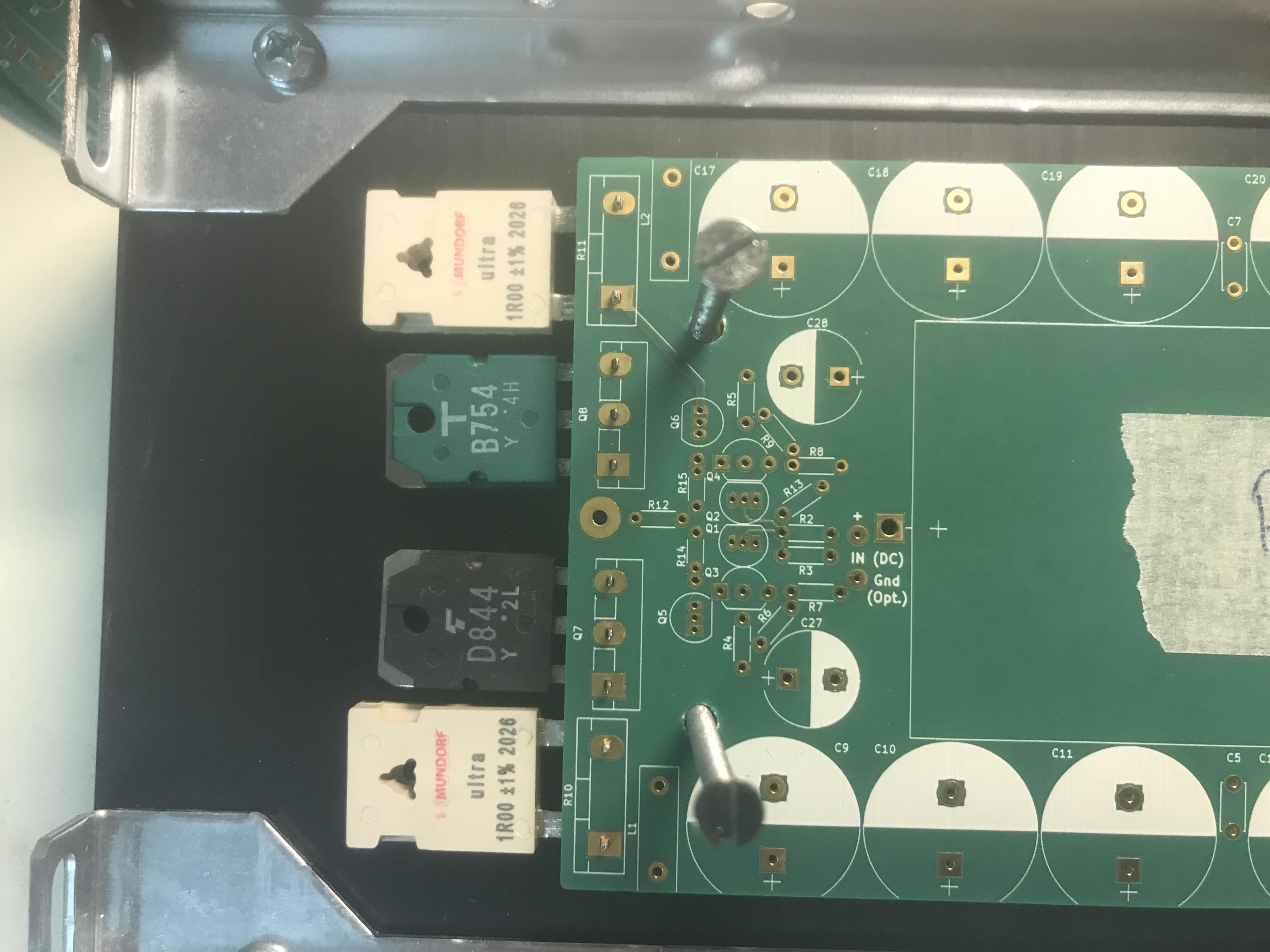

Discovered the 2sk170 and 2sj74 Y-grade with IDSS 1,3mA is very hard to find.
Stuck right now missing them.
I have GR grade but this is not optimal because I have to replace the 1Kohm resistors due to the higher IDSS current.
Like 520 ohm and I do not want to buy any more TX2575 resistors because they cost about 20$ each with customs and VAT from US.
The side effect is also a drop in gain in the input stage of about -5dB.
Anyone know where to get the Y-grade jfets?

Both 2SJ74Y and 2SK170Y are not available anymore. The G's become's rare, the B's are limited. The Pchannel is not available actually. In the Pass-section there's are topic about replacements, but it is a meager yield. You should have checked this before designing your board.
Lowering the value of first stage drainresistors lowers the open loop gain too with 6dB. One should do a full open loop calculation (or simulation) to see if there's enough margin.
Also the transconductance is higher of the G's and B's (if available) and this can push the design near its limit. Divirting a part of the drain currents through fixed current sources in parallel with the drainresistors (say enough to keep the 1kΩ's) to the rails is only possible when both sides are controlled and of the same value (an extra control circuit is needed). This will make this nice simple design way more complex, and no guarantee it will sound as good though.

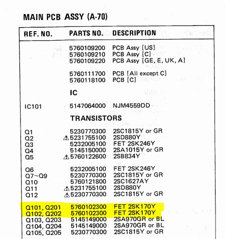

Thanks for the information.
I am currently researching Service Manuals för some vintage Hifi amplifiers containing the Y-grade jfets.
Found Teac A-70 so far with 4 piece of 2sk170y in the parts list.
Will continue to search old hifi components.
