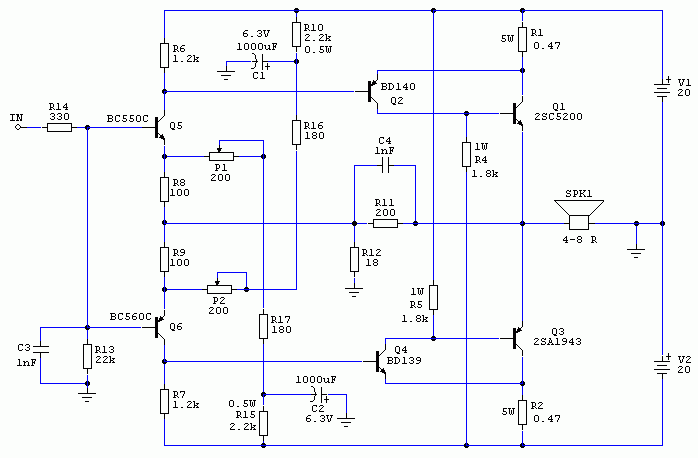

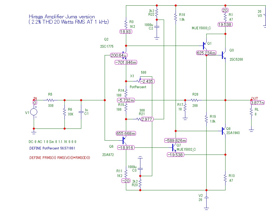

Hi Hylle,
it will work this way: bootstrap circuits (P1,R17,R15,C2 and P2,R16,R10,C1) polarize the input stage and qonsequently determine the output stage bias and DC offset at the output.
Start adjusting with P1 and P2 at half of their value (which translates into about 1A through Q1,Q2 i.e. 470mV over R1 or R2) and spin both, in small steps, alternatively, until wanted bias and zero DC offset are reached.
Stability should be the same as in the original design and it depends also on BJTs used, so some testing in vivo with different types might be needed. Sufficient heatsinking is a must.
To preserve the original gain of the amp the R12 has to be a bit higher (18 instead of 10R) beacuse it has emitter circuits of Q5,Q6 in parallel.
I calculated the values for +/-20V PSU and if higher or lower voltages are to be used, the value of R10, R15 has to be changed proportionally.
Thanks Juma, i might play with this circuit when i find some time. one question. is it the only way to use the bootstrap circuit, or is there other ways. Do you like this solution? I am not that happy about the big 1000uf capacitors involved in the circuit, but maybe I dont need to worry about them.
Hi Hylle,
the bootstrap circuit is actually an emulation of constant current source so yes, it can be done in numerous different ways and this one is quite OK.
Yes, the capacitors are evil things - stay away from them at any cost, don't use them at all, not even in the power supply (where they are more involved with signal then here)... :D
Jokes aside, there are more dangerous beasts to fear than simple caps - all active parts for example, their non-linearity is hard to match. ;)

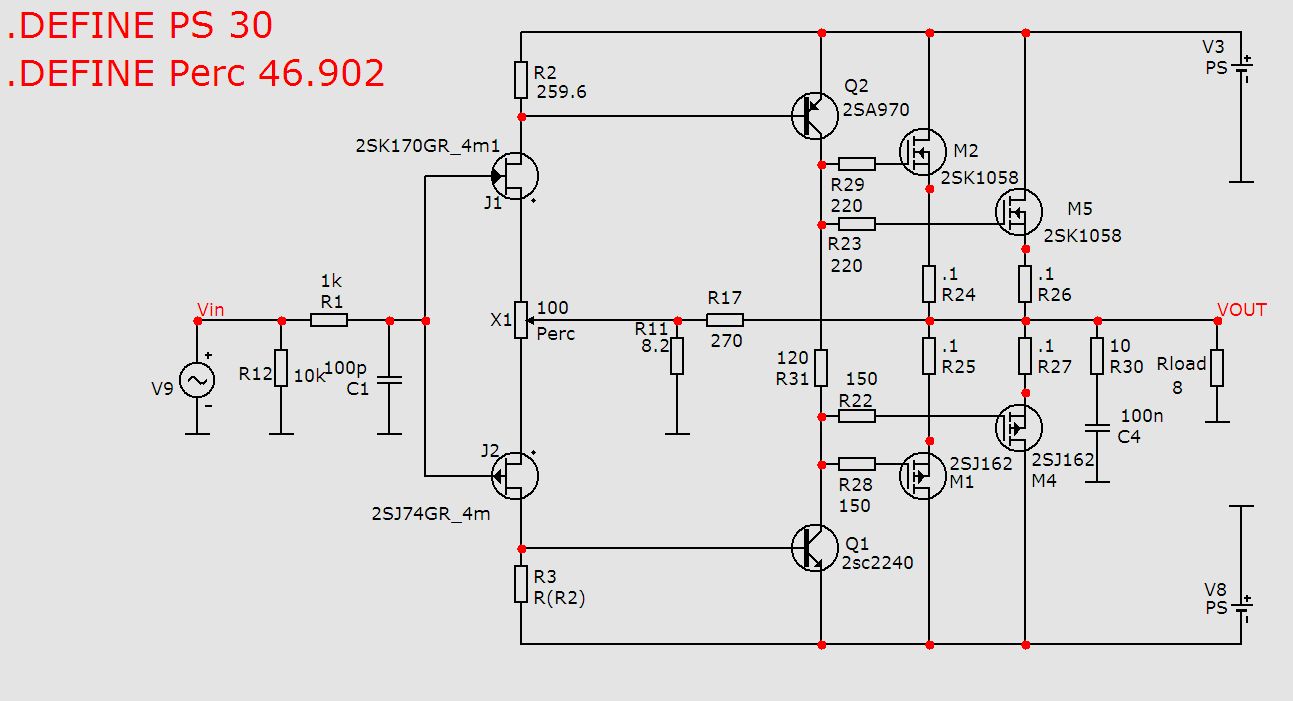

Sigurd's schematic look like a Zenquito
2A & DIY
At the time we were playing with Le Monster and he came up with this. I stand corrected and I must take your word for it if it is Zenquito I did not know of its existence. There were a few variations we tried at the time. The idea was to mimic Hiagara's THD distribution with slightly different configurations. I guess that everything exists somewhere in the world, whether it is know or unknown, nothing is ever unique even if you think it is.
Thanks for the web reference anyway seems interesting.
