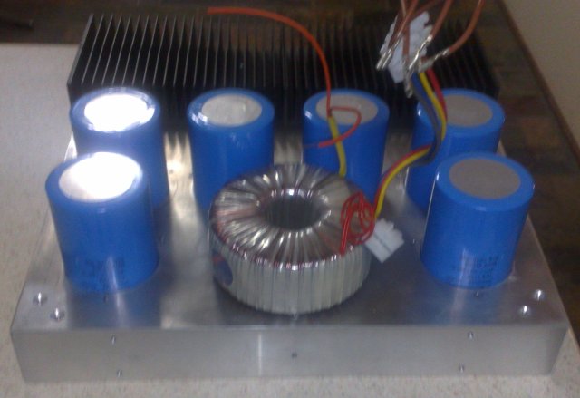

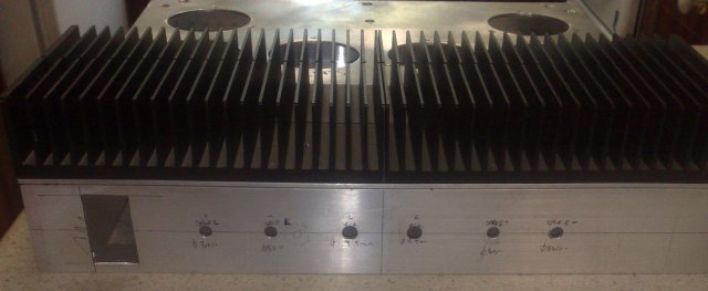

- also the heatsinks will be bolted flat to the chassis as is,
so the chassis itself will have some contribuation to heat dissipation.
which it will regardless.
I have actually tested a smaller version of this heatsink and it is capable of running cool enough to touch without burning someone. running 1.5 A bias. on the hiraga.
the pic may be deceptive of the heatsink(s) overall size.
it is ~35 x 150 x 420 mm total.
Rth by calculation is 0.12025 deg. C/W for 80C rise
(in practice the rise is nothing like 80C this is just maunfacturers data used in calc.)
so i expect about 25K rise.
34V*2(supply rails)*1.5A=102W*2(channels)=~204W total
204W*0.12025deg. C/W = 24.531 K rise.
-Dan

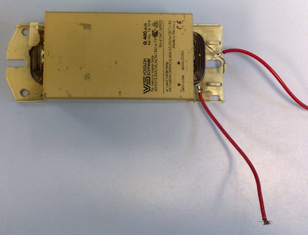

Choke input or no choke input.
To use a choke or not to use a choke....
I have quickly done the test in my lunch break....
Circuit:
Single rail linear supply with bridge rectifier.
Xfrmr and rectifier common throughout.
Results:
first test:
100 000 uF 63V RIFA industrial high current cap.
ripple @ 35V 3A resistive load = <8mV with or without choke.
clearly this cap is doing the job. but doesnt help me with my test...
second test:
10 000 uF 40V no name brand low quality cap
ripple @ 35V 3A resistive load = 647mV (no choke)
easily measurable ripple. its time to see if the choke helps much
third test:
choke input filter (using common lighting choke 1.7 Ohm DC res. ~170mH from measurement.
10 000 uF 40V no name brand low quality cap (after choke)
ripple @ 35V 3A resistive load = 47mV
So for me the results are pretty clear.
The choke makes a huge difference to the supply ripple.
The choke i used has been used alot and is discoloured from being overheated. The choke is a fairly standard lighting ballast.
Which are available for less than $50.
I think i will have to take Eduard's (good) advice here
-Dan

Its funny that you replied today because last night i marked out the chassis for the pcbs and out put stage to be mounted to.
I have built an external DC detector circuit and mounted the heatsinks to the chassis.
once the last few holes are drilled the chassis will be painted.
I will post some pics up soon..
-Dan
