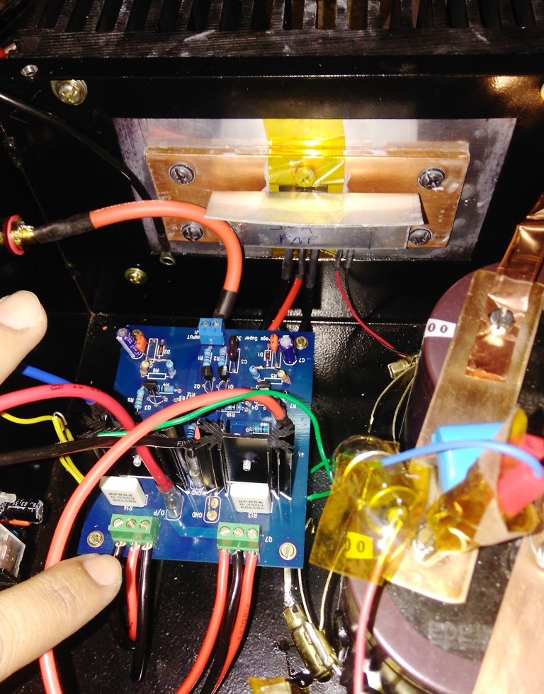

hi friends!
finally i got my both Hiraga mono blocks singing..
for starters there is absolutely no hiss or noise!
excuse the messy wiring, this is the best i could do. working with those thick wires is a PITA.

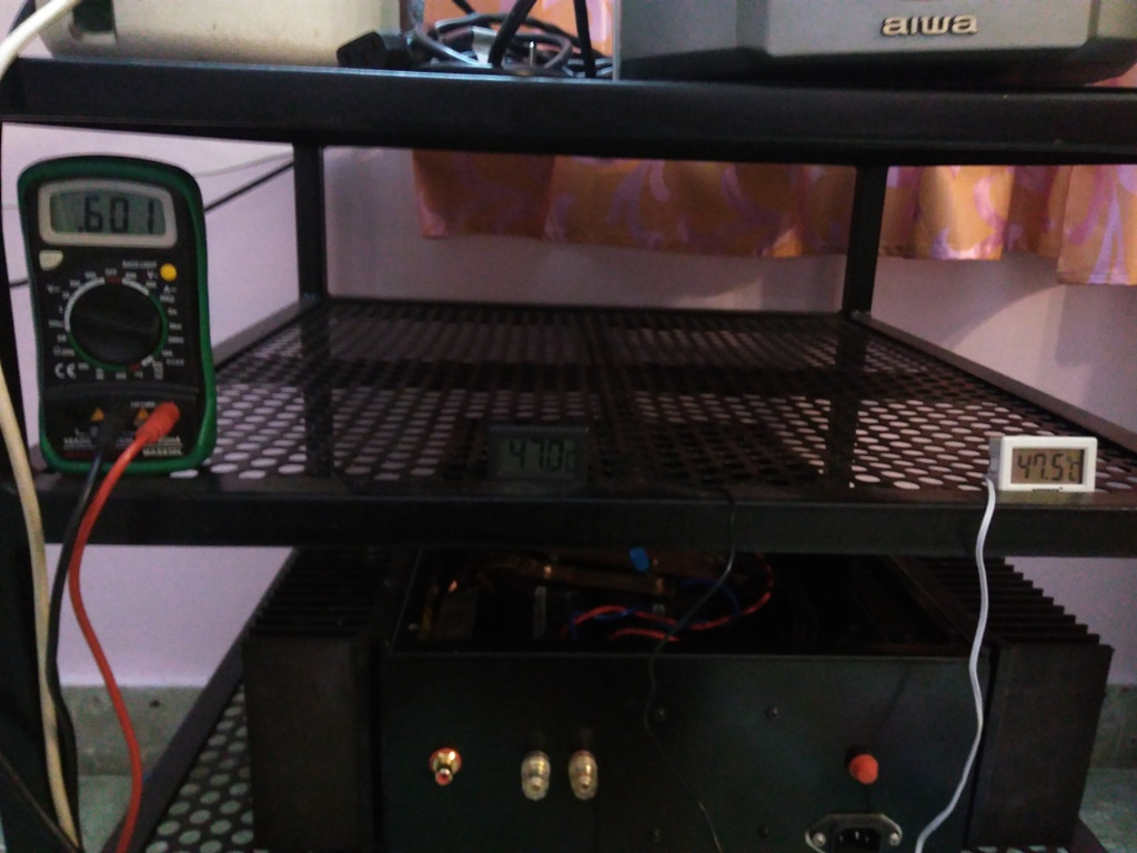

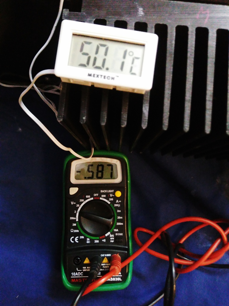

but i do have one concern: on one of the channels, bias voltage hovers around 0.6 Volts resulting in bias current of around 2Amps!! but the amp seem to normal -no overheating, music sounds the same between the 2 monoblocks. bias voltage seems to be settling at around 0.595 volts DC across the resistors. hope it won't turn out to be an issue. rail voltages are 29VDC . with or without load not much of a difference [30VDC without load]. probably due to 400VA transformer!?
attachment.php
been running the amps for around 1 hour in this configuration.

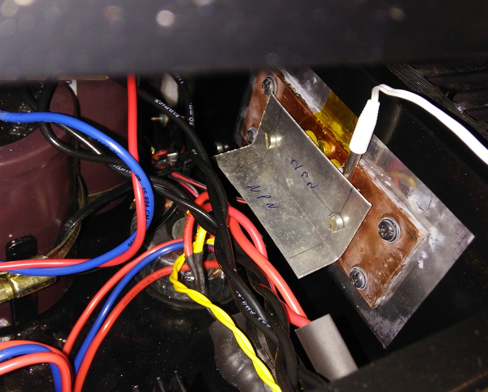

max temperature recorded is around 52 degree Celsius. ambient temperature is around 25 degree Celsius. i can comfortably place my fingers on the heat sink for as long as i like - it doesn't burn. also, my soft-start module has a temperature sensor which will cut the power if the temperature reaches 75 degree Celsius.
attachment.php
i've mounted transistors on Copper spreader which is bolted onto Aluminium heat sink. each monoblock weighs around 18kgs. i'll put up a detailed write up after some time.
The thing with the bias is that you can barelly hear this difference, but if you measure with a DMM on the output you will see that this channel has more power. With very sensitive speakers you will definetly hear this. So better adjust.
The transformer is doing just fine. The voltage drop of just 1 V is ok, dont worry about it. This is the case on each built (about 1V drop). I would sugest you measure the trafo temp also on the 2A bias and on the other channel and compare to see wich temp is more lower and convenient.
This is very good!! But i would recomend you should measure directly on those L shape Al pads on the outputs and see how hot the outputs are. The lower the temp the better for long time exploatation. Usually its best they dont reach 65 degrees celsius or above.
This is very good, especially when its time for house cleaning.. :). My whole amp has 34kg and rests on a stand with wheels. Now i wish i had made it smaller and separating the channels entirely.

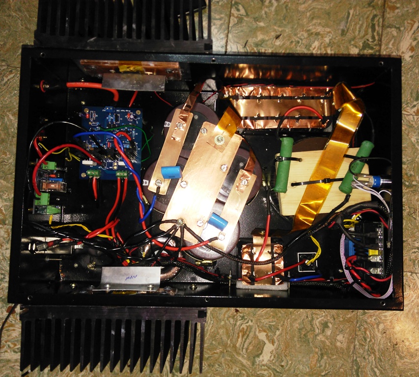

Only one thing i would strongly recomend in your case, because it seems that you are using toroidal trafos: shield them.

the temperature recorded is near the transistor [between al plate and copper]. those aluminium pads are quite hot to touch. i think the temperature sensor may not be efficient since the probe is cylindrical in shape [they have firm contact between the surfaces though]. but even after 3+ hours of operation i didn't see them raise above 52 degree Celsius in the afternoon.

i think bias current i quoted is wrong [even for approximation!]. max bias voltage noted is around 0.620 in the past 2 hours hours of operation resulting in the current of 1.87Amps [0.620/0.33]. rail voltages now are 30.3 VDC [it is almost 1 A.M. here now]
trafos seem to be running cool, i didn't find them hot to touch [tested now after running for about 2+ hour]. resistors in CRC are warm to touch [0.25Ohms, 30W rated].
yes, i'm using toroidals, what kind of shielding do you recommend ? steel bowl? for now it is bolted directly on chassis [epoxy potted center] and a small wooden plank on top to support CRC resistors.
