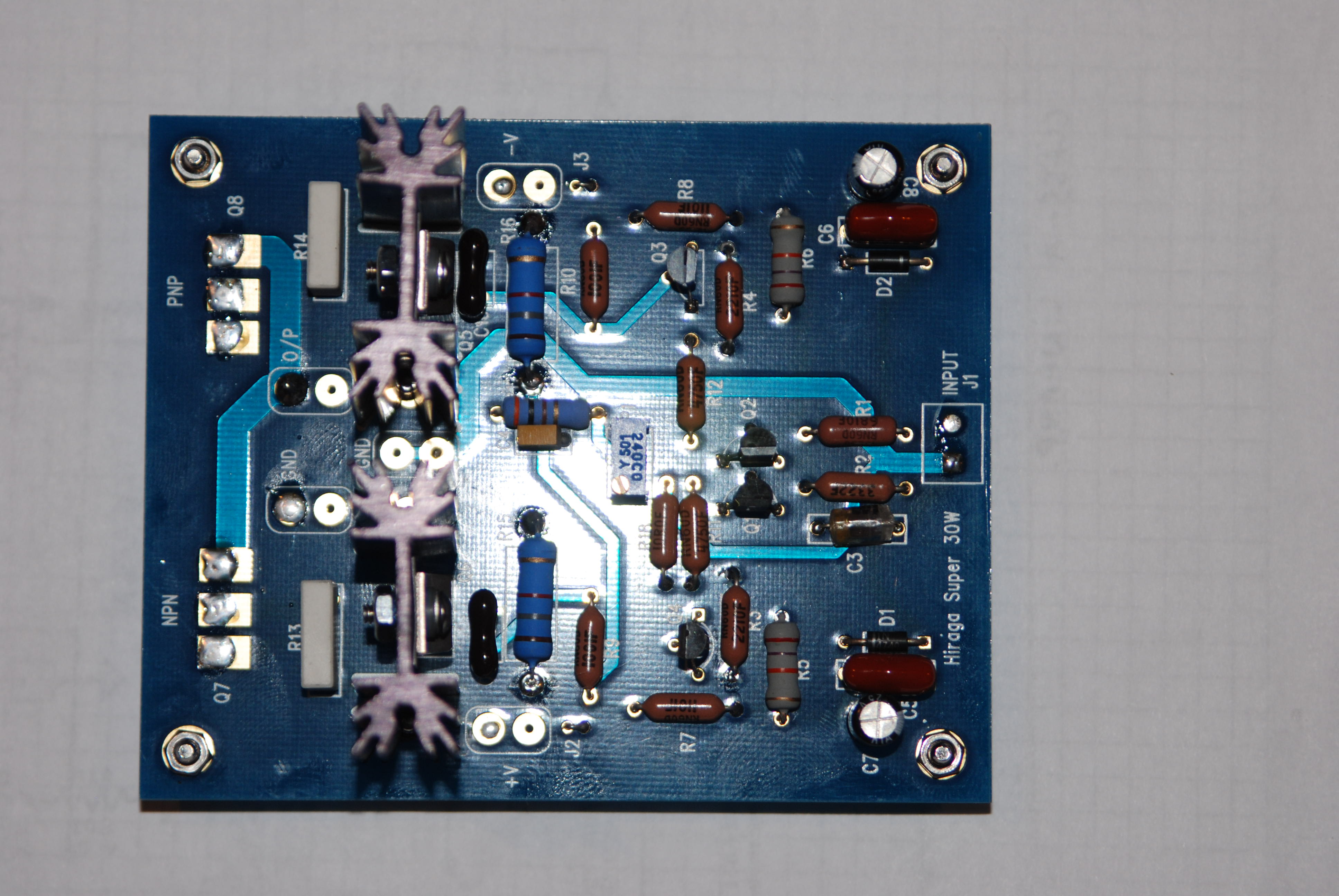

Just stuffed aboard with the Fairchild KSA992 and the KSC1845 for the input, used a set of MJE15028 and 29 for the drivers and a set of 2SA1342/2SJ5199 as outputs, works like a champ. Bias resistors at 27K ohm results in 900mA bias current, will have to adjust that later for more current. R3 and 4 I have at 220 Ohms.
What is the criteria of selecting the imput trannies for this amp? Do we have to use the devices with maximum gain or with matched close gain? Just asking becuase of the diffrent values of the 200 respectively 300 ohms. I assume that they are there with different values because of this aspect. What do you say?
I used 220 Ohm for R4 and R4 and measure 980mV over R9 and R10 right on target with 0.8 to 1.0mA. I use 300R for the feedback resistor. I get most of my parts form Mouser and did not do any matching on the devices just picked them form the bin. I would assume that one could use the MJE 15030 and the MJE 15031 for drivers too

Rail voltage is +/-31V and get 18V over a 8ohm load before clipping = 40W RMS
Square wave looks very nice too with no overshot or ringing, theres some slight rounding on the front edge when paralleling the 8 Ohm load with a 4.7uF cap.

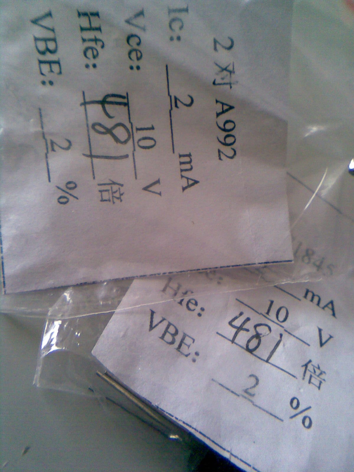

The Input set I bought. One left! Be quick.
The sale from the link isnt valid any more..
The Input set I bought on Ebay.
here is the set I received:
very well matched, it looks like (but of course at a premium price).
The difference between 200/240/300 ohms in the base is for matching differences in the base resistance; that will have an effect on the saturation; so in has nothing to do with tight matching of Hfe imho.
Saw also 2SA970/2SC2240 matched quartets, for USD 15 free shipping, is a good alternative too I think. Rbb is quite low as long as they are originals (I am so suspicious.. these days of fleabay)
