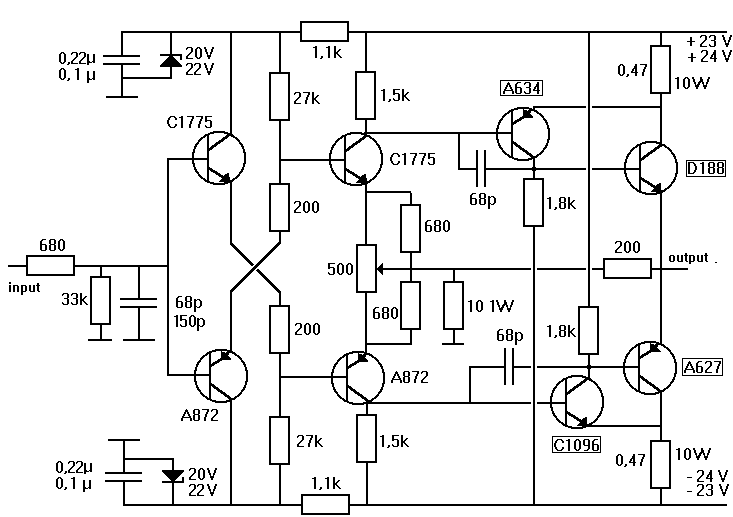

These is the Class A Hiraga there is no J Fet at the input but if you do some mode let me know please.
If you think about the M Hiraga yes that use J Fet input.

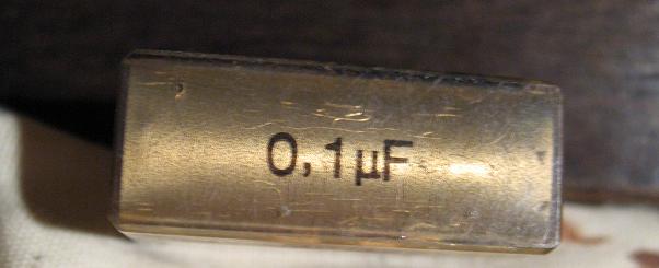

I used 0.1uF Rifa AC capacitor there. That was the best to me.
I ordered some Solen thin foil caps to but good for nothing, I did try several other caps like Wima, Yellow Philips, Evox so on, these Rifa was the best.
If you can get capacitor like these I think that is good enough.

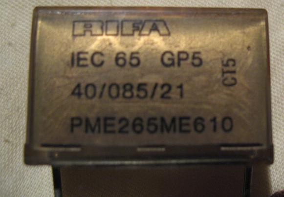

Gaborbela,
Are those Rifa caps the ones used as X2 for mains supply filters, etc from years ago? Still available or a current production equivalent?

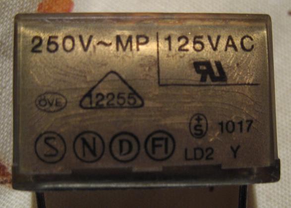

I do see a Y in the bottom right hand corner.Ash,
The Y is not in the familiar format Y1, nor Y2. I suspect this Rifa does not qualify as an X nor Y rated capacitor.
Ah, you have better eyes than me, Andrew -
I wonder if that part number is PME206, 260, 286, ? - a discontinued cap from awhile back?

Hello
Andrew those are old Rifa caps...
They are very old production but some places still available. I use those the last 20 years or so.
Usually I used them in the PS on the electrolytes (mounting caps) but these great on the PC board to, if you have place because they are large.
Some people advertise on Ebay as a paper capacitor. I don't know.

I never open up one to see what is inside.
Better than the Evox which also Rifa product. I also used in PP EL84 tube amp.
It has well balanced sound but with great dry deep bass.
Please chose which does not have built in resister! Many company use them in EMI filter.

I plan to make a variant i think like Hiraga mentioned in his article, with a FET-based Darlingnot.
Perhaps this one? (Fig. 2.)

Hello
Yes that is what I wrote if you want the 20W Class A (Hiraga) you do not need JFet.
For the Le Monstre you need the JFet .
I built both and I would pick the Class A over the Le Monstre always!
I posted somewhere the circuit on the forum at the input with 20 or 22V Zener diodes. Use that not the 13V Zener type schematic.
I built them all, the orig 22V type sound much better. Look like you need that voltage on the input BJT.

Hello
Here i the schematic.
Please send me a PM with your address and I look up the lay out to you and I send it, probably I have somewhere.
Also you can buy on Ebay from Jim's audio good quality PC board.
I would do that all do I have many years experience manufacturing home brew PC board.
Those are good quality and cheap.
For the first 2 stage I advise use the orig BJT even do hard to find them.
For Power transistor ON Semi MJ11022/23 or MJ11024/25 TO3 metal case transistor.
Driver On semi MJE15030/31 MJE15032/33
I have the opportunity to test the original Hiraga transistors, these what I advise to you sound far better! Deeper bass, better sound stage, more control specially in mid-bass area. All over cleaner and better sound! The heart of these amp the PS! And use solid wire to hook up the TO3 transistors. Min 400mA but I would go 500VA transformer 2x18VAC.
Do not replace the small BJT transistors!
