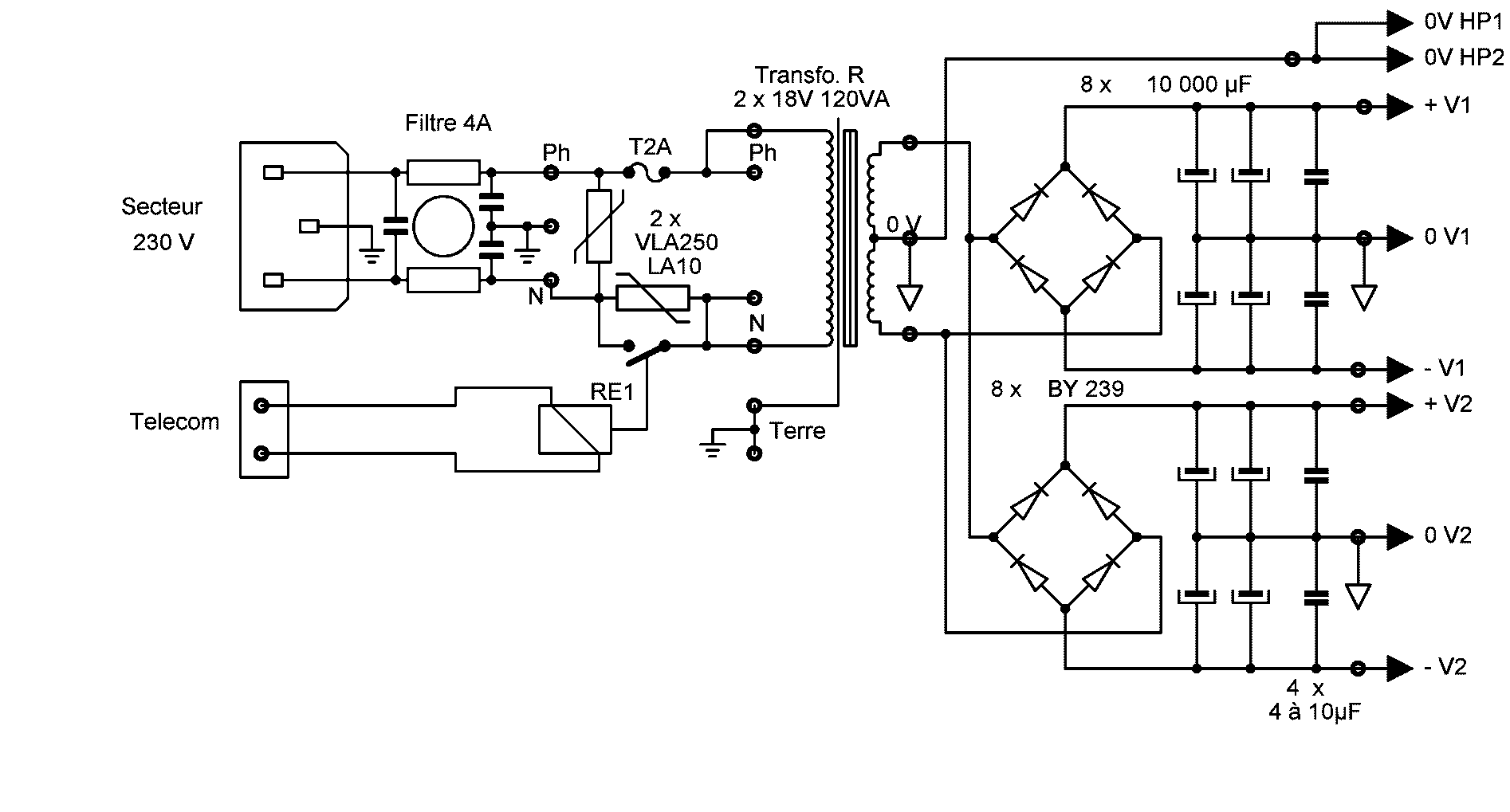

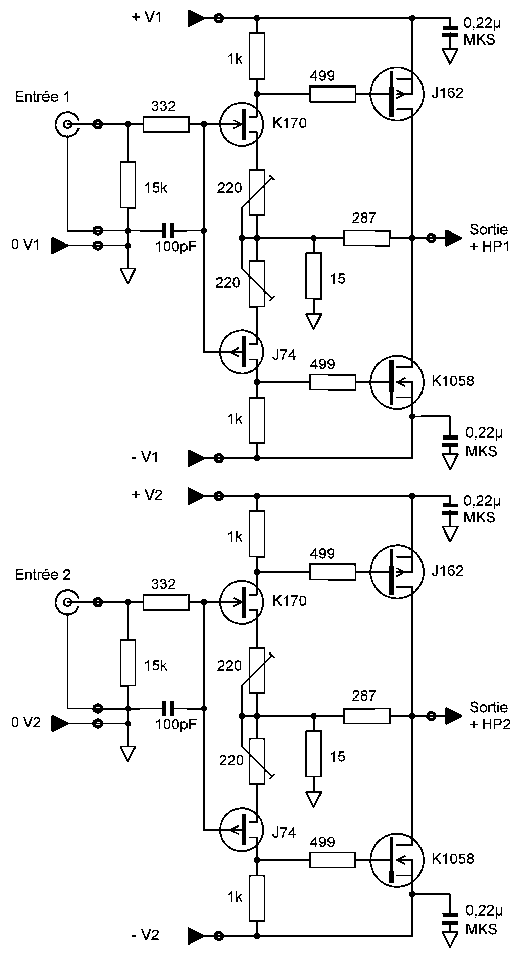

Hiraga 20W class A
This is true, but depends on the output transistors used. I guess that you are using some of the biggest ones from on semi, which have the sweet spot around 1.1A, but also like more VOLTAGE (unless you cascode them).
I didnt check the datasheets, but I'm pretty sure that the original ones chosen by Hiraga were doing their best at 20W output power, or he would just have proposed a 30W amp :)
The outputs chosen were not very high powered; the maximum power depends on the heatsink thermal resistance.
Additionally: the current amplification is matched with the driver transistors, such that this becomes a combo that performs well.
Even the input pairs must be 'better than' the commonly proposed BC559 type, as the flat shelving of the amplification is needed, that reacts to a difference in the Vce-difference. Hiraga spent quite some time in matching, each choice is tricky.
I can confirm that, as I ran a slightly higher voltage and power on my first build and killed the output transistors (and a 12" woofer). The heatsinks were big. Be careful with the bias.

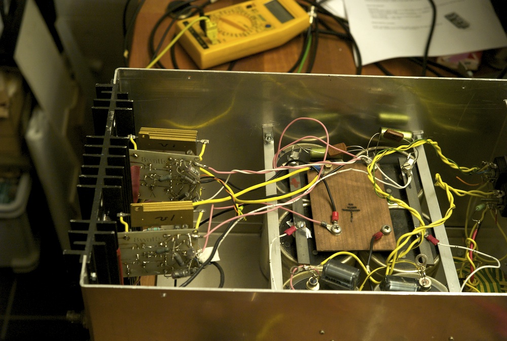

8 W Hiraga implementation
Hi Dan,
here you go:
this is my second implementation with regulated power supply. The first one had passive and in total 12 of those large capacitors.
Note the extra large 1 ohm resistors! They still get hot.
I have decoupled the transistors in the cascade stage with solid tantal caps of 27 micro farad.
I have noted that the quality of the feedback set is very important.
regards
albert
what is the power rating of these extra large 1 ohm resistors when you choose to use them without a heatsink?
What is the Rth j-a of the resistor without a heatsink?
Hi Andrew,
these resistors are 50W but in air this is lower. I can't find the thermal resistance in free air - just the derating, which is 35% in such a closed box.
Of course the current is some 750 mA, but the inside of the cabinet reaches easily 35 degrees, and the resistors are some 45 degrees to the touch.
albert
