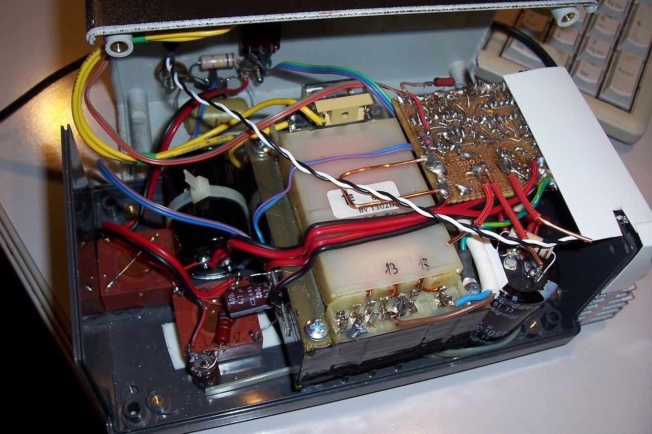

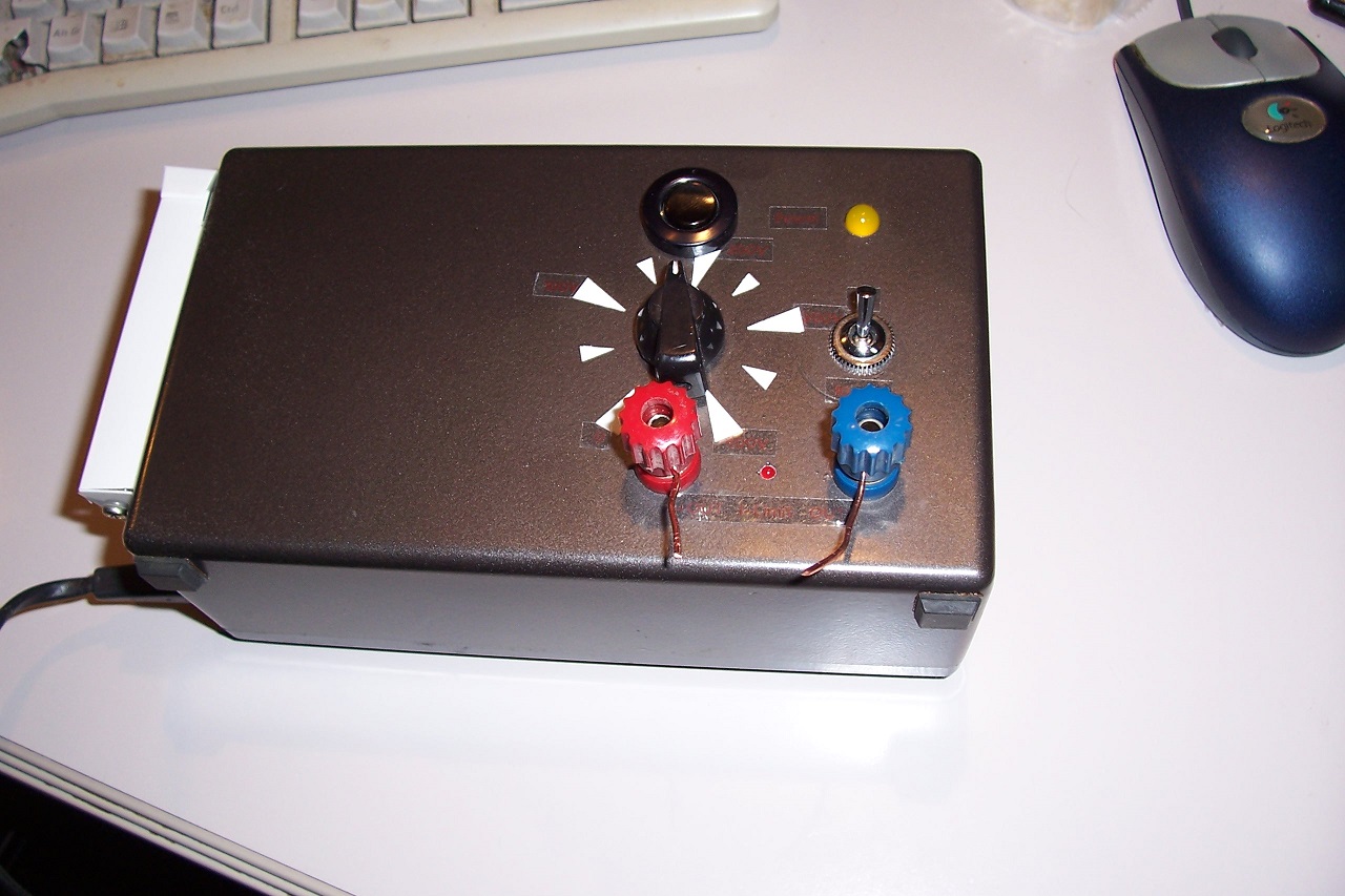

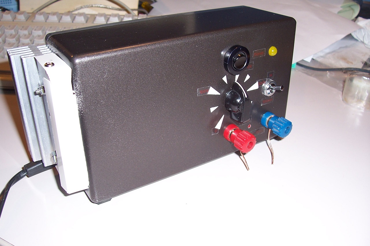

I have encased the combo supply. I managed to cram everything into a 19x11x7.5 cm³ box (7.5x4.4x3 in³).
It has the pleasant look and feel of a solid cast iron ingot, just a little bit heavier.
Unfortunately when I tested it, I realized that it had had a disastrous effect on the noise residues in the output: with the proximity of everything, inductive and capacitive couplings had predictably become unmanageable.

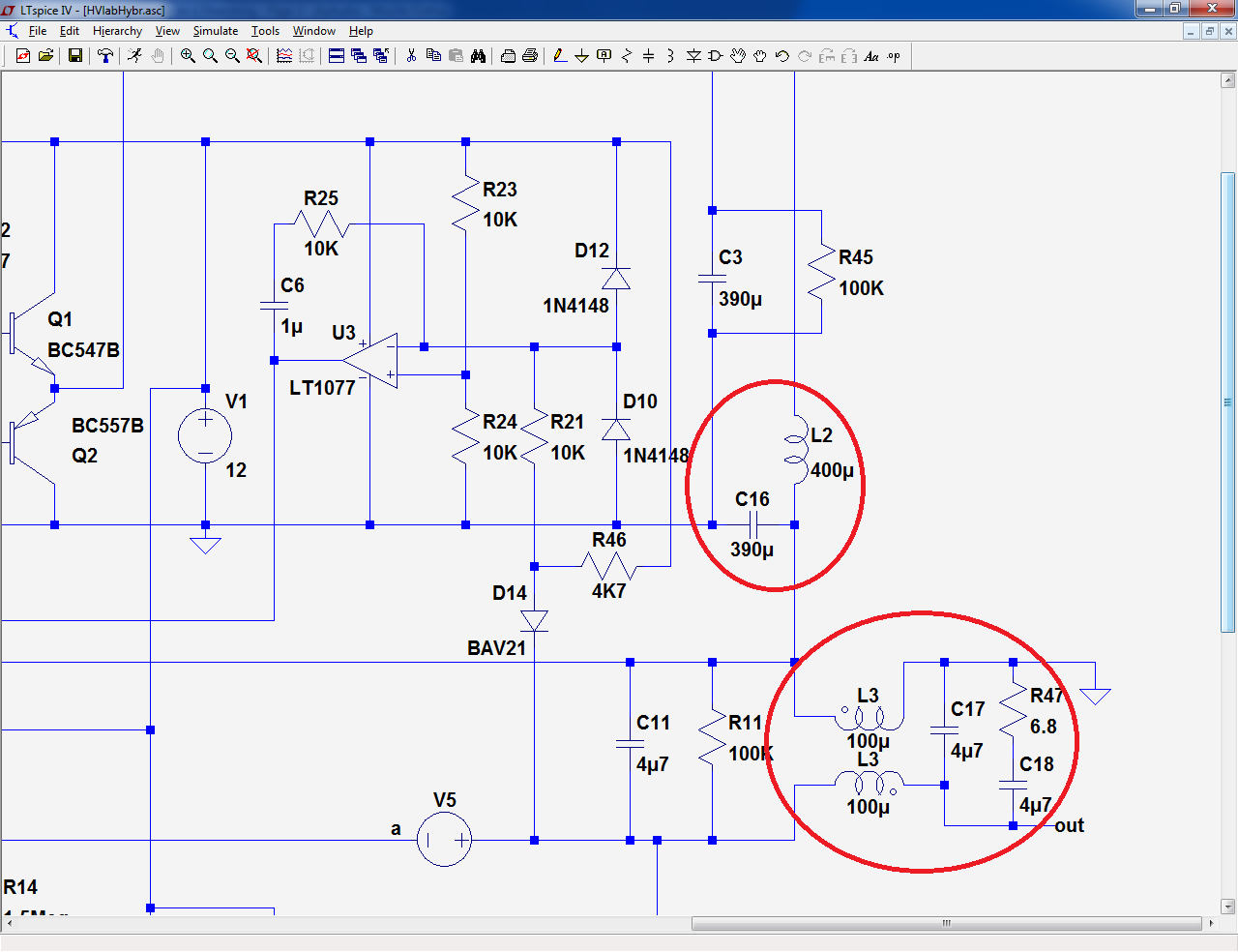

Since I didn't want to go back after such a feat, I had to add supplementary LC filters: they saved the day, and the worst case noise level is now a mere 50mV pp, very much less in rms.
The output goes smoothly from 0 to 400V, with a 1.1A current up to ~100V, and 250mA at 400V.
I have also added makeshift heatsinks on the main rectifier bridge: with the huge current, the 3A diodes became unbearably hot.
I even have some spare space in the box: maybe I'll add something one of these days: a meter or a standby switch.

No problem, but note that these are problems of my own making: each bit taken separately and with enough space to breathe worked satisfactorily." I had to add supplementary LC filters" Can you explain or show were the LC filter goes with an updated schematic.
Only when I tried to cram everything into an unreasonably tight space did the problems appear. And as I said, they were entirely predictable. But the problem is that I had no master plan set from the beginning: I first explored the crypto concept, built a proof of concept prototype, found that it was viable and could be improved with a post regulator, added the post regulator on a test board that had never been intended to receive it, and ended trying to stuff the whole thing into a very tight case, because my lab is already clogged up with 1001 clever items.
I you don't suffer from similar behavioral troubles, there is no reason you follow the same path: you can start from a clean and well thought out layout, and put the thing into a spacious enough case.
It would even be possible to achieve similar compactness without the problems, but this would require careful thinking from the beginning; not after you notice the problems, as I did.
Anyway, here are the mods I carried out, highlighted in red: L2 and L3 are dual 100µH inductors (brick-colored in the pics)

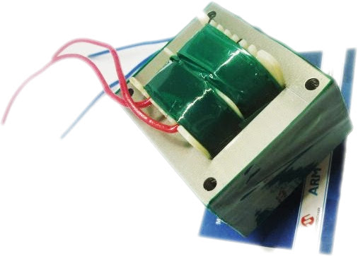

This type of transformer is ideal for this kind of supply, and 60VA for a 30W DC output is very generous since the circuit acts more or less like a PFC and has only a few watts losses.My target will be ~ 300V 100mA, I can only buy a 24VAC 60W transformer like my attach image. Do you think it is ok? If yes, I will buy it and try to measure its H.

Measure secondary leakage H with primary shorted, is that the proper method?

On my prototype, the leakage inductance referred to the primary is 75mH.In the real circuit, how much switching ripple is unintentionally reflected to the primary?
