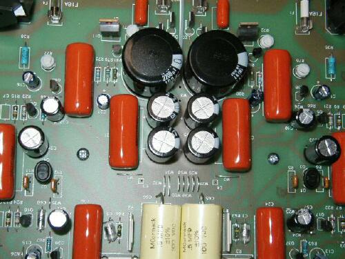

I'm in the process of upgrading my McCormack DNA .5 Deluxe amp (replacing caps and such). The amp uses the following Bridge rectifiers for the distributed power supply sections (BRUS620 - 8A)
http://www.edidiodes.com/PDF/Bridges/BRUS6.PDF
They look fairly fast (50ns) but no idea how soft they are. Any recommendations for a better replacement?
Also, if you look at the link you'll see that pins are in a straight line. Possible mplementation issue with other substitutions - thoughts?

Brus620 - 8a
These are not specified as soft recovery. You won't find many high speed diodes in bridged packages and I have seen no soft recovery types in that package. You might want to try snubbers with the existing brides.
http://www.hagtech.com/pdf/snubber.pdf
I would be very careful about changing components in the McCormack products as Steve McCormack is about as good as they come on passive component selection and that is one of the most important factors in the sound of his amps. You could easily degrade the sound of this amp. Mr. McCormack might have some suggestions though.

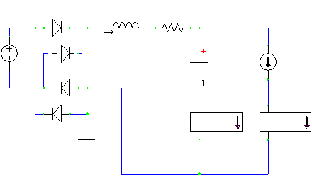

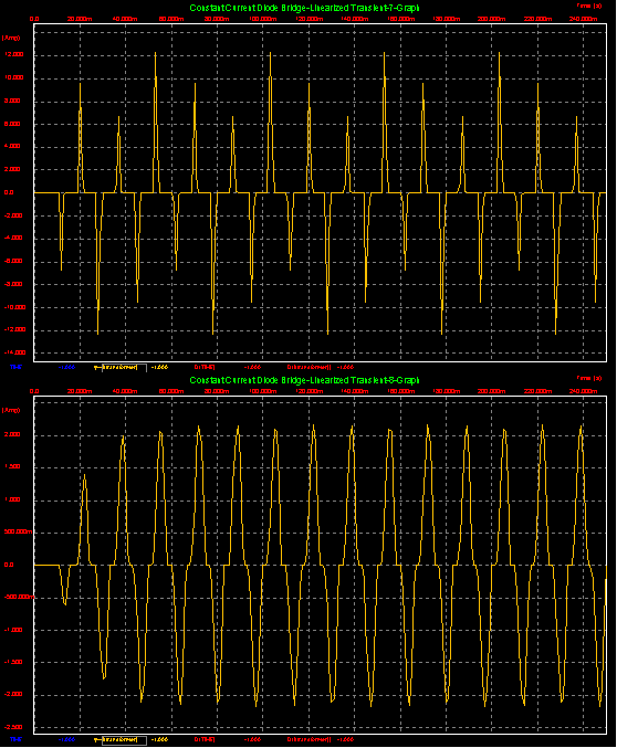

Below are two sims. The first one the current through the transformer using an ordinary bridge/capacitor network (5 Ohm resistor at 10V p-p from the transformer seconary). The peak currents through the diodes is over 10A.
The second graph is the current through the transformer using a 2.7mH inductor in series with the bridge and before the capacitor. The peak currents through the diodes are now under 2A. This is a 1:5 reduction of peak currents by adding a small choke.
(1) The diodes don't shock-excite the RLC tank circuit, because the choke damps the response.
(2) The peak currents in the diodes are lower.
(3) The peak currents in the transformer are lower. This reduces heat dissipation in the transformer, and reduces the magnitude of the transformer's magnetic field.

Kashmire said:Instead of worrying about high-speed diodes, why not use choke regulation?
because it would look very low tech and unsophisticated.
The problem you have when you run the choke directly after the bridge is that your DC rail voltage is now ~0.9 X the secondary AC voltage instead of ~1.3X (under load in both cases).Kashmire said:1-2 mH at 2-3A can be a pretty small choke. Any losses in the choke is easily made up with the reduced peak currents in the transformer and diodes. In addition, the ripple current in the filter capacitor is much smaller.
Kashmire said:Below are two sims. The first one the current through the transformer using an ordinary bridge/capacitor network (5 Ohm resistor at 10V p-p from the transformer seconary). The peak currents through the diodes is over 10A.
