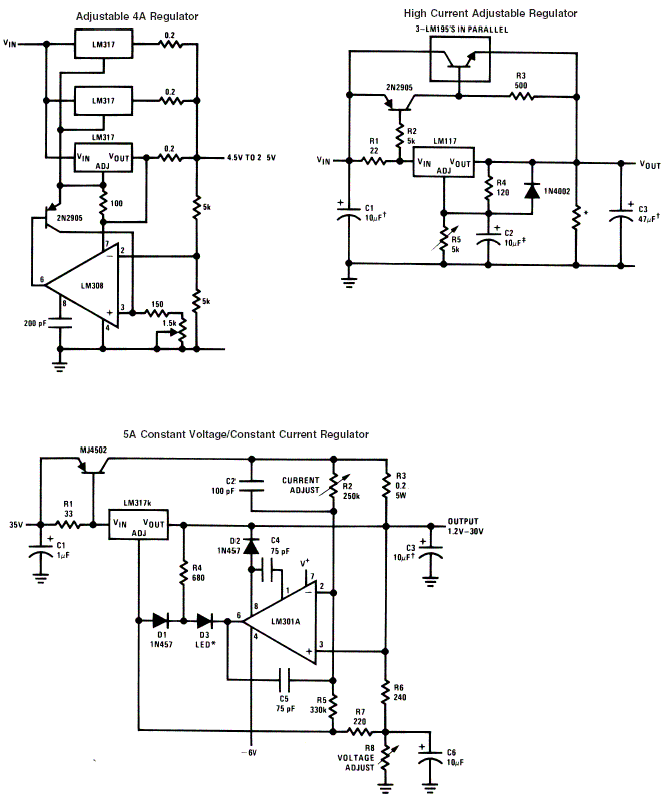

Thanks for the suggestion. Another possible solution(provided you aren't needing more than 36 volts per rail), suggested in a old National Semiconductor app manual, is to parallel LM317 (or LM337 if a negative supply is required) chips to meet the current requirements of the power amp. I am drawing on old, faint memories here so please bear with me. I'll see if my old National manual from 1982 has the info.
-Tom
I once asked this question and the general concesus was that you cannot just parrellel regulators, rather there is more circuitry that is involved. You may know this or not, but thought I'd share, in case some got some bright ideas, but I could be totally mistaken.
Looking at National's datasheet for the LM317, they show some possible high current designs.

Because, here in the US we have places called Radio SHack which stock these chips, so quick test could be hacked together quickly for a test. National also makes a IC reg, a LM138, (I think anyway), that will supply about 5 amps.
-Tom

Hybrid fourdoor said:I once asked this question and the general concesus was that you cannot just parrellel regulators, rather there is more circuitry that is involved. You may know this or not, but thought I'd share, in case some got some bright ideas, but I could be totally mistaken.
yeah i was wondering the same thing. lm317 are pretty cheap. or you could use the 5amp lm338.
