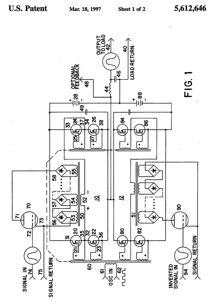

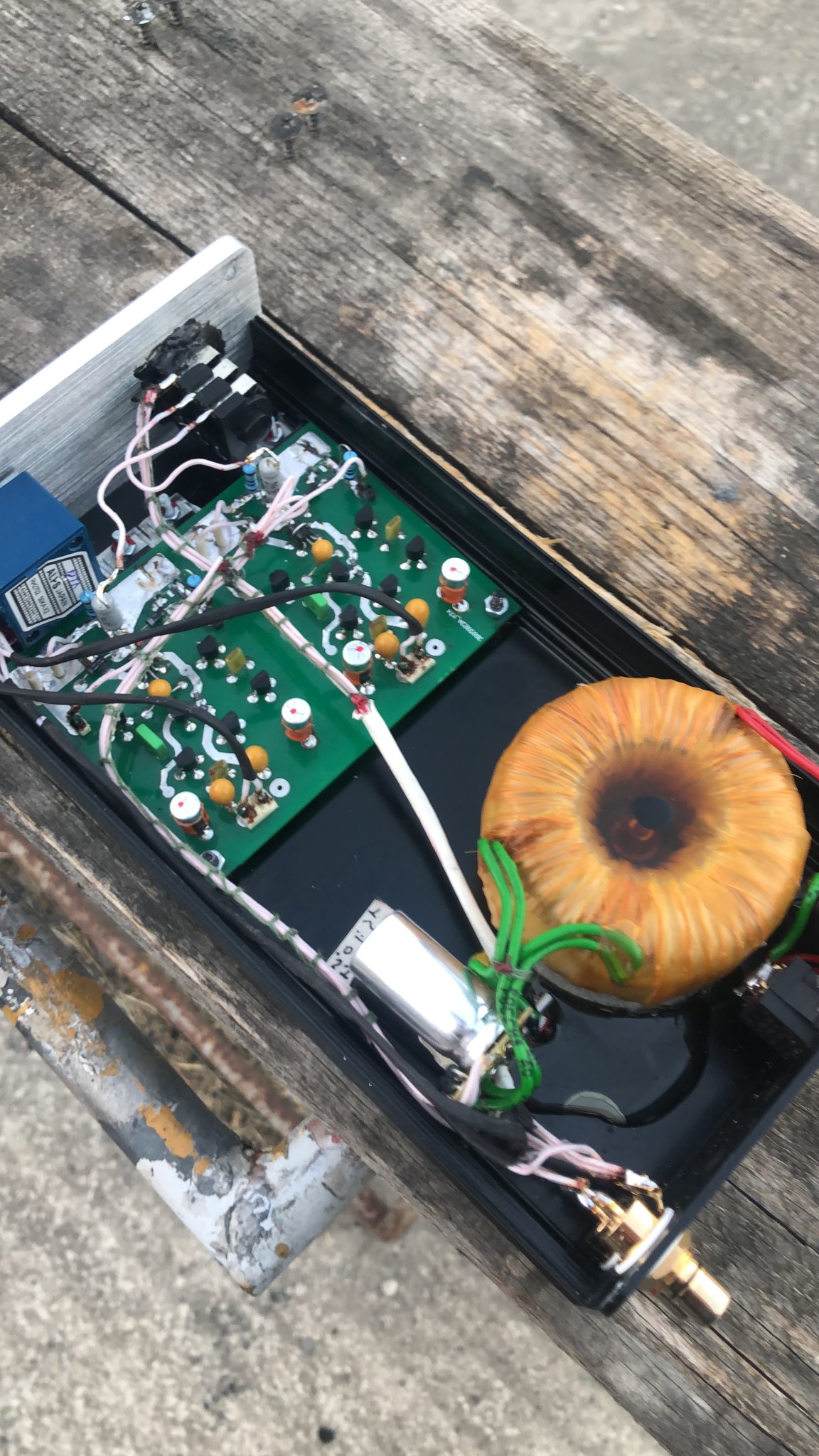

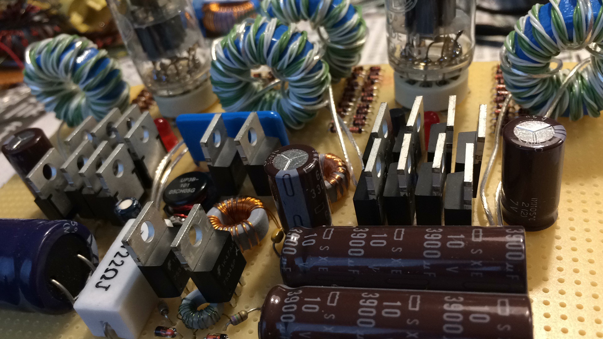

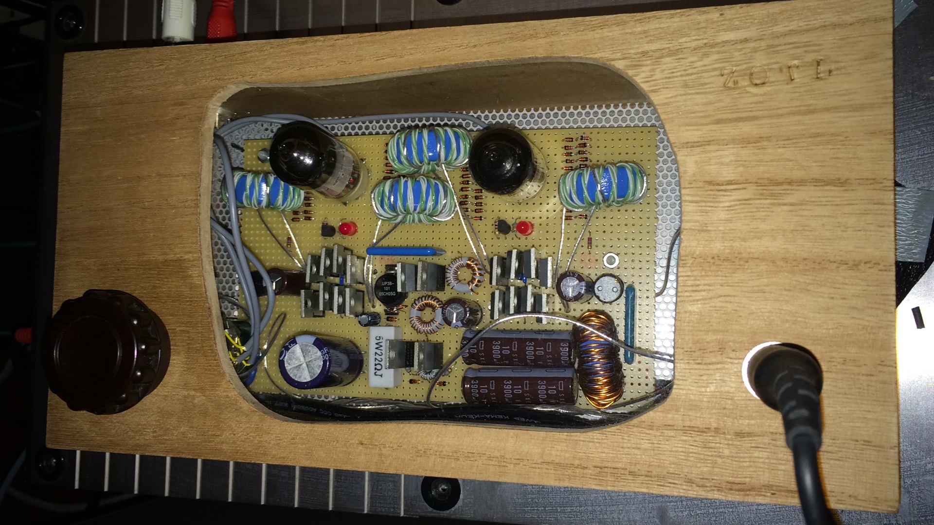

A MicroZotl can drive 4ohm speakers.

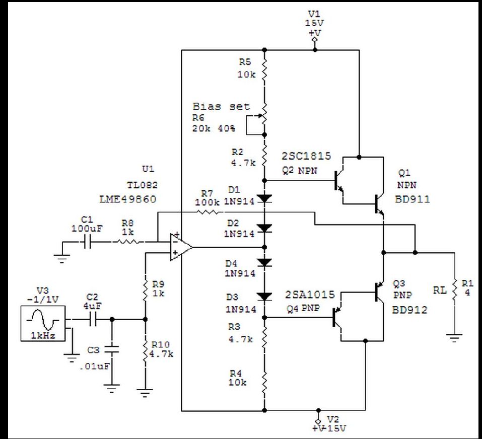

Hi There...................
Here is a little amp that may be suitable for your needs, I had a lot of fun with it, and it sounded great when I had the outputs well into a class a state of bias as described in the thread !!! ;) :D
It drove a 2 ohm just fine up to about half the supply voltage and would swing as far as the opamp would go at anything above 16 ohms.
I used every thing I had in this circuit from LT's to LME49860/720' and such, they all worked.
Surprisingly I found out (as I was still learning stuffat the time..... we never stop do we) is that you only need to change the value of one of the resistors to adjust the output current through the two devices.
I had matched up the diodes but it is not needed to be done to make it work and I still have them in a little bag somewhere as I had planned on using this as a HP/Bench utility amp as well sometime when I get to making some PCB's soon.
Cheers !!! :cheers:
jer :)
https://www.diyaudio.com/community/threads/strange-problems-with-transistors.252027/post-3837607

Wow this very power schematic with operational amplifier
