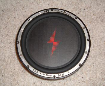

I know alot of people have been asking about Sub Amplifiers but I can't seem to find what I'm looking for. I'm planning on using a PPI Pro Flat piston 10 for my HT and music listening.
The sub is rated at 300 RMS and it's a single 4ohm voicecoil. Anyone know of a 300-400 watt Sub amp that can run continuously into a 4ohm load. I have looked at the 300w Subwoofer amplifier on ESP and was trying to find a few more alternatives.

An easy-to-build amp for this purpose is a brigded-parallel design using chipamps like the National LM3886. See National's application note AN1192. The bridged-parallel topology is basically a bridged amp, where each of the two amps is actually a parallel combination of two amps. The effective load impedance 'seen' by each amp is equal to the impedance of the speaker, and the power output is about 4 times that of a single amp chip. With the right power supply and heatsinks, it will crank out over 300 W into 4 ohms, with distortion figures of below 0.01%.
I built Anthony's symmetrical amplifiers, they're really good sounding and work great if you build them correctly. (Oy, be careful with these things.) Feel free to send me an e-mail as well, if you have any questions about it.
Of course Anthony has not mentioned he has a couple designs capable of far more power than that.
