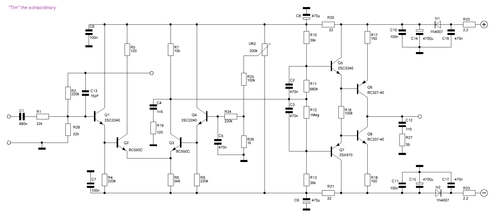

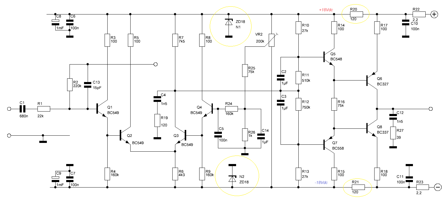

Please don't rush into the component dimensioning, I just made a quick sketch and inserted N1 and N2, most of the resistors simply scaled - knowing that this is not correct.
So,
it would basically be no problem to operate the IPS (and even the VAS) with stabilized +/-18V.
Regardless of whether there are better suggestions for low-power amplifiers in this forum or not, this is a 1980 design.
What can be done to improve this proposal slightly, or to make it work at all?
That does not solve the problem. Q6 and Q8 see the difference between their base and emitter voltages. That difference should not be affected by ripple.
N1 and N2 need to be in parallel with C10 and C11. Get rid of R20 and R21. This is a poor design even by 1980 standards.
Ed
Ed

Suddenly I remember a very simple solution to Ed's problem /point of view. Two rectifier diodes and two proper charging capacitors isolate the IPS-VAS from the shared rails. No problem any more.

To be honest, I am just too lazy to elaborate on everything faulty with that design. Even in the eighties we knew better approaches.
I do not debate the "sound" of any power stages, but the circuit details from the view of good or bad analogue engineering.
There are many aspects to debate - too many.
At this point I would like to emphasize that this circuit was not designed by me - and that it is precisely the many apparent inconsistencies that are the attraction of this project for me. At second glance, I still find the circuit clever and well thought out - but I would never adopt it 1 to 1, I emphasize “never”.
The obvious quirks or, to put it more kindly, peculiarities of the circuit can be ironed out - and the original idea of the circuit can be retained.
I am not interested in magically transforming a laboratory circuit into the ultimate, world's best circuit.
The more voices are heard shouting in unison how bad L.Stellema's circuit proposal is, the less they dissuade me from trying to win something from the circuit.

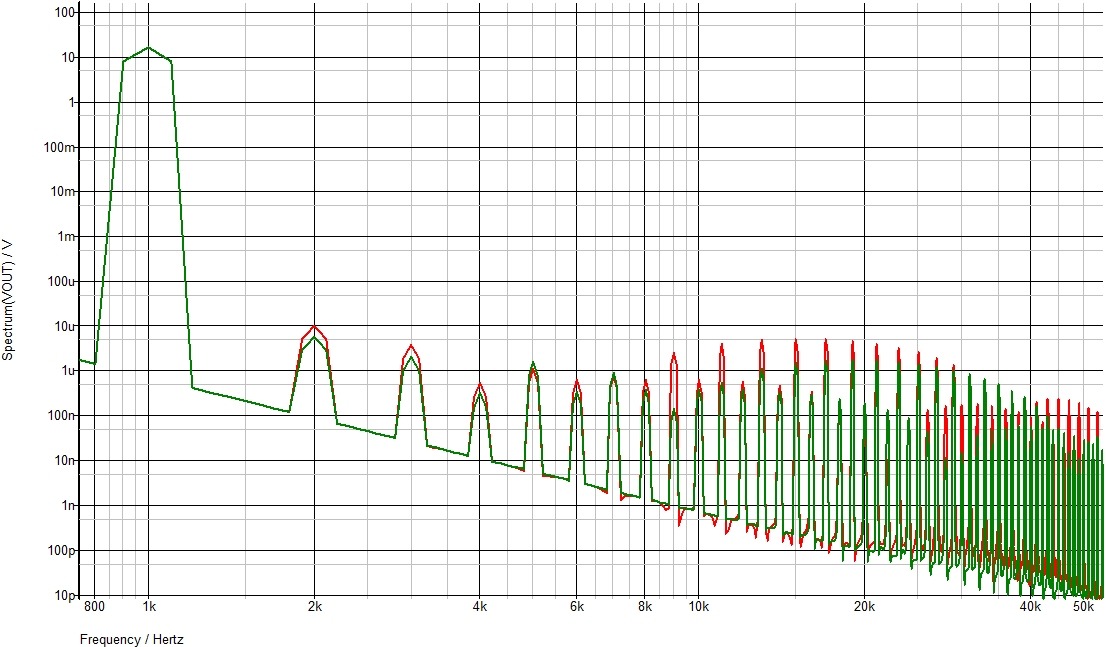

I will give some hope to fuel the debate, here what i got from two radical iterations of this weird design, but i ll warn
that it could be false hopes since even if those numbers look very good i m not really sure that it would be worth
the effort, for the time i ll just lurk by here and see where all this will end, although i have an idea of the final direction.
