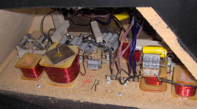

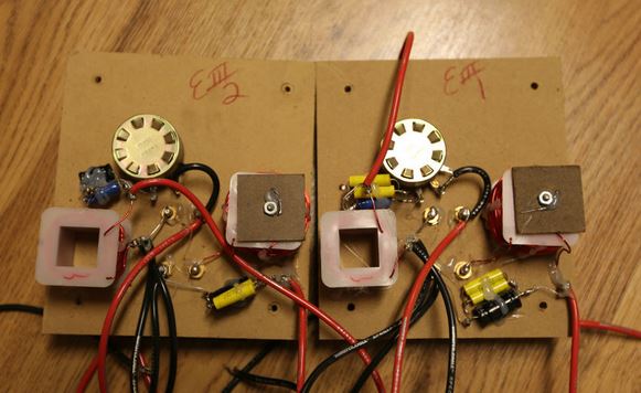

I also have a snap in my archives of a 3 way Snell A crossover. Weird, or WHAT! Also a Snell E, which is the 8" bass plus 1" tweeter. :D
