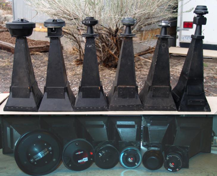

As well as various frequency response and distortion tests, this evaluation of high frequency drivers allows you to compare the recorded sound of six different compression drivers on the same model horn, (each equalized for flat response) to the original recording.
Two different crossover points were used, for each driver, 630Hz and 1250Hz.
No actual woofer was used, the woofer is "virtual" having been edited in the sound files from the original source (low passed) and added to the high frequency horn recording.
The recordings of the compression drivers were run at different drive levels using both sine waves and music.
The low level music recordings used around one watt, high level recordings were at levels up to 132.4 dB at one meter.
The recordings are normalized, so everything you hear is at the same volume, allowing you to hear the changes in character as drive level and sound pressure level are increased in the various tests.
This gives a unique opportunity to compare different drivers with your own headphones or speakers in a familiar listening environment at a level comfortable to you.
A list of the recordings and where to find them is at the bottom of the post under "recordings".

This comparison is rather extensive, some basic facts about the drivers and test results are presented first, then my opinions regarding the facts, then my opinions about how the drivers sound with music, then a seemingly endless barrage of test data, pictures, charts and recordings.
The Facts:
All the drivers tested are nominally rated as 16 ohm. “DCR” was the DC resistance measured (in ohms), for relative comparison. Sorry for the run on mess, tabs (and more than single spaces in a line) vanish after editing.
Driver name, Test name, AES, Peak, Rated Range, Exit, Diaphragm, DCR, Exit Angle, Lb.
BMS 4550, 50, 80, 450, 500-20 kHz, 1”, 1.75”, Polyester, 12.3, 12, 4.95
BMS 4552, 52, 80, 450, 500-20 kHz, 1”, 1.75”, Polyester, 12.3, 24, 1.83
BCDE82, 82, 110, 220, 500-18 kHz, 1.4”, 3”, Tit.,Polyimide 8, <1, 9.9
PSD2002, 02, 80, N/A, 1.2K-20 kHz, 1”, 2”, Titanium, 11.0, 10, 5.0
EVDH1A, 1A, 50, 200, 500-20 kHz, 1.4-2”, 3”, Titanium, 10.4, 14, 23.5
JensenD-30, PA, 30?, ?, ?, .75”, 2.25”?, Aluminum, 11.40, <0, 2.5
All the tests, other than noted, used Welter Systems Maltese conical expansion horns (13 x 13 degree horn angle) with adapters to fit the various compression driver exits. The narrow horn results in an on axis sensitivity around 6 dB more than most typical 90 degree horns, the 2 meter results would be similar to one meter results on some horns.
Care was taken to insure a smooth transition between driver, adapter and horns, requiring a fair amount of drilling, filing and cursing those that made poorly aligned adapters and drivers that have unique bolt patterns.
The Maltese horn exhibits increasing “ripple” (frequency response dips and peaks) below 1000 Hz, the ripple reduces to less than .25 dB by 2000 Hz, where the frequency response differences between drivers become large, in some cases over 20 dB. The low frequency ripple is less than the unit to unit driver frequency response variance.

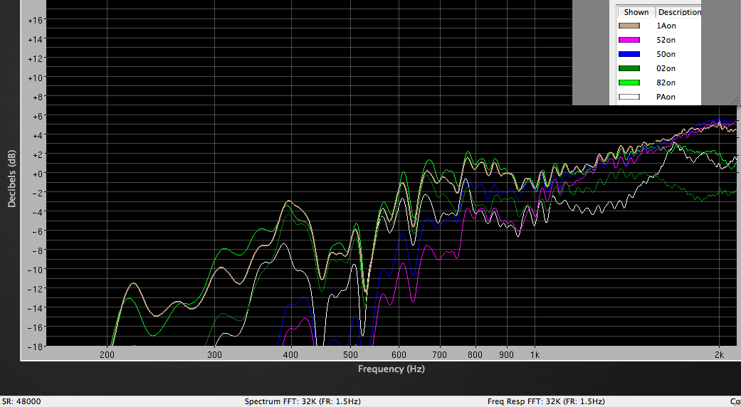

1) Size does matter regarding LF output, there is no replacement for displacement. The larger diaphragm drivers have more output below 1250 Hz, the 3” diaphragm driver’s response extending to 200 Hz. The larger diaphragms provide more output with less distortion.
The smallest driver, the BMS 4552 had the least LF, followed by the 4550, the Jensen Hypex D-30, and the Eminence PSD2002.
The EV DH1A and the B&C DE82 were neck and neck in LF response, the DE82TN having slightly more output below 1000 Hz, other than the DH1A having slightly more output below 250 Hz.

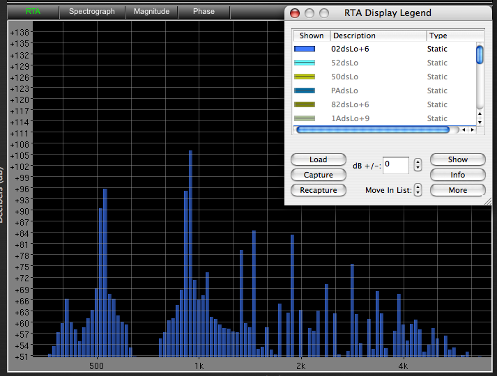

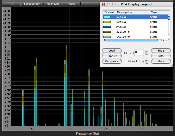

In the 2 meter dual sine wave “lo” test (about one watt at 523 & 932 Hz, two watts total), second harmonic distortion (2ndHD) of 530 Hz was >32% for the BMS 4552 at 82.6 dB, the BMS 4550 put out 85.2 dB with the same distortion.
These small BMS drivers are only capable of low distortion output down this low at a drive level lower than one watt. BMS makes coaxial 2” exit drivers with better LF response.
The BMS also had more IM distortion than the other drivers, around 14%, 409 Hz (difference frequency between the two upper tones) was only 17 dB below the fundamental tone.
The old Jensen did 82.6 dB with half the distortion, 16%.
The inexpensive PSD2002 was a surprise, with 6 dB more power, it hit 95.7 dB at 523 Hz with 8% 2nd HD.
The B&C DE82 at +6 dB did 98.9 dB, 6% 2ndHD.
At +9 dB, 101.9 dB 7% 2nd HD, the ultra-heavyweight EV DH1A had a clear 3 dB “win”.
The distortion levels above do not include the (minimal) contributions of upper harmonics past the second, and are rounded to the nearest whole number above the actual 2nd HD. Anyone willing to crunch the numbers further is welcome to look at the RTA charts and derive finer resolution. Having done so in the past to prove the point that 3rd, 4th etc. harmonics, unless they exceed the second, change THD very little.
Odd order harmonics tend to sound worse (at least from a western musical standpoint) and there are differences in their levels between the drivers.

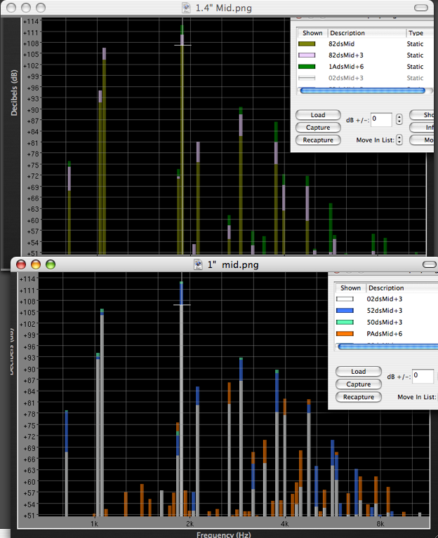

Harmonics of the “Mid” test, using 1046 & 1865 Hz sine wave tones occurred at 819 Hz ( IM sub harmonic component) and around 2092, 2660, 2920, 3138, 3450, 3730, 3980, 4730, 5010, 5620, 5790, 7760, 8410 Hz.
The Jensen Hypex PA30 driver, lacking a phase plug, had an additional 16 odd harmonics occur.
The BMS drivers had the highest IM content. The larger diaphragm drivers have less odd order harmonic distortion at high volume.

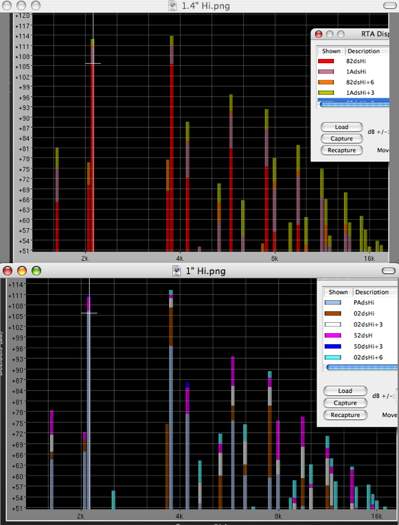

Harmonics of the ”Hi” test, using 2093 & 3729 Hz tones sine wave tones occurred at 1636 Hz (IM) and around 4190, 5360, 5822, 6280, 7460, 7915, 9100, 9550, 10008, 11190, 11640, 12100, 13280, 13740, 14920, 15380, 16290, 17010 Hz.
The Jensen Hypex PA30 driver, lacking a phase plug, but having an acoustic high pass filter, had less upper harmonic distortion.
The Eminence PSD2002, which has little output above 12500 Hz, hit a slightly higher SPL than the other 1” drivers with similar distortion level.
2) The dual sine wave “mid” test using 1046 & 1865 Hz came out with a different order at the bottom in a close race, the DH1a again the top driver in terms of clean output capability.
02dsMid+3 104 dB, 7% 2ndHD
PAdsMid+6 104 dB, 7% 2ndHD
52dsMid+3 104.8 dB, 10 % 2ndHD
50dsMid+3 105.7 dB, 8 % 2ndHD
82dsMid+3 106.6 dB, 6% 2ndHD
1AdsMid+9 112.1 dB, 10% 2ndHD
3) The “Hi” test using 2093 & 3729 Hz resulted in less disparity between the drivers, the EV still providing the most output at a reasonable distortion %.
PAdsHi 106.4 dB <4 % 2ndHD
02dsHi+6 108.4 dB, 4% 2ndHD
52dsHi 110.3 dB, < 6% 2ndHD
50dsHi 110.7 dB, 6% 2ndHD
82dsHi+6 111.1 dB, 5% 2ndHD
1AdsHi+3 112.9 dB, < 6% 2ndHD

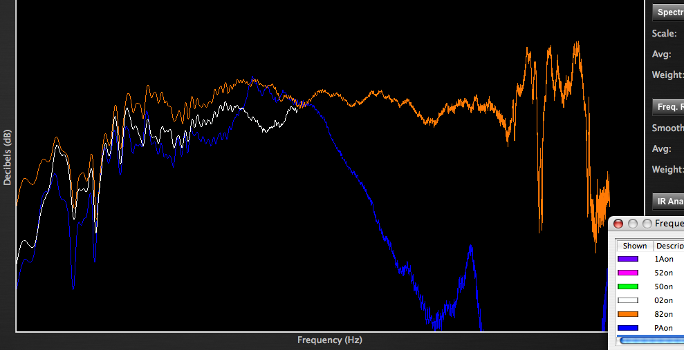

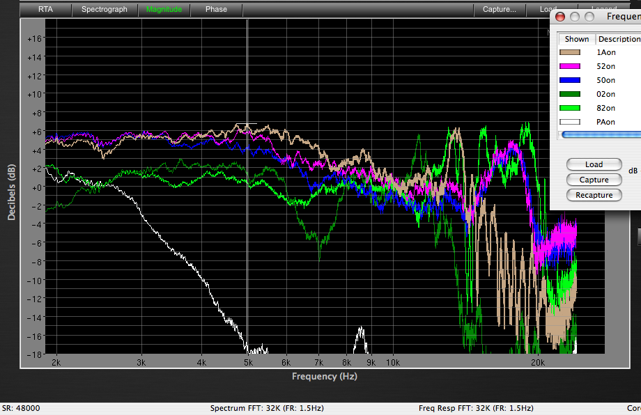

4) The B&C has the flattest response, +/- 3 dB from 644 to 5000 hz, with a peaked rising response above. The BMS and EV drivers have more output in the 1600 to 8000 Hz range.
The Eminence PSD2002 has a rough response, and little output above 12.5 kHz.
The Jensen Hypex rolls off at 2500 Hz, with a shelved upper response, more explanation in it’s test section below.

Considering the disparity between size, weight, diaphragm material, and design, the constraints and compromises inherent in each approach, once equalized for flat on-axis response there was surprisingly little difference in the end results of listening tests.
The dual sine wave tests made hearing the differences between the drivers easiest, simply stated, the EVDH1A has more output available with less audible distortion than the other drivers. The B&C, also using a 3” diaphragm, was the next in terms of high output vs. distortion.
The 3” diaphragm drivers have a large advantage in terms of low frequency output, they also had close to a 3 dB advantage in terms of HF output.
Though the BMS drivers were more sensitive in high frequency output, the smaller diaphragms and throats “run out of gas” about 3 dB SPL before the larger diaphragms.
The Eminence PSD 2002 wins the low end 1” competition, the BMS the mid-high.
I expect opinions to vary widely on this, the low end distortion in the BMS may be construed as “warmth”, and although the PSD2002, has more undistorted LF, when pushed hard sounds more “grindy” compared to the BMS.
The Jensen Hypex, once equalized, sounded surprisingly good considering it’s abysmal raw response.
When pushed hard, even with a 1250 crossover, the "s" sounds in the word “cities” seemed to get the most “spitty” with the BMS drivers, and the harmonics of the flute seemed a bit odd. The BMS drivers have the smallest diaphragms of the drivers tested, whether this type of distortion is simply the result of the higher throat SPL required by the smaller diaphragm and exit diameter, or the driver design itself is an unanswered question.
The upward masking from lower frequencies crossover masks those distortion effects to a large degree.
While recording I only listened to the HF output, what I heard often reminded me of distorted screams heard in “B” grade horror movies, I was surprised to find how much distortion can be tolerated in the presence of the low frequency output.
I can share the HF tracks separately, but will initially post the mixed output of the LF crossover with the HF horn recording.
Because of the quantity of charts and pictures to post, they are spread over several posts.
Conclusions:
All of the drivers tested showed many desirable characteristics and some defects.
The Jensen Hypex is an antique, no longer available except on the used market. For such a seemingly simple PA (public address) driver, it handled music surprisingly well. Having one sitting idle after use in a Leslie-style rotating speaker, it provided an interesting glimpse into past designs. I had assumed from it’s rolled off upper response it used a phenolic diaphragm as most thread on PA drivers, finding it used an aluminum diaphragm was a surprise.
The Eminence PSD2002, the cheapest driver of the bunch, had far more undistorted lower frequency output than the other one inch exit drivers, though upper response was lacking, and more “heroic” equalization was required throughout it’s operating range. The PSD2002 is used as an OEM driver by many manufacturers, it provides fairly bulletproof operation. Having owned many of these drivers, have found unit to unit consistency to be quite poor, the driver tested was the best of four units I still own.
The BMS 1” drivers have extended clean HF response, but require fairly high crossover points if high volume, low distortion response is desired. The BMS 4552 is by far the highest output for size and weight of the drivers tested. The small size lends itself to line array applications, the close driver spacing reducing the complexity of the driver/wave guide interface. In quantity, it is also a great choice for fighting HF air attenuation, sixty four units have been coupled to single horns using Tom Danley’s layered combiner. They have a “classic” HF driver response that would work well with many “old school” horns, yet have upper HF response extending above human audibility.
The B&CDE82 has most all the elements I look for in a compression driver: low distortion, extended bandwidth, high output capability, relatively low weight and cost. It was not the most efficient driver, but was the flattest overall, and appears to handle the extra power it requires over the others with no problems. The only small complaint are some response glitches at the very top end of it’s response, BMS makes other drivers that have all the other great attributes (other than price) that address those small issues.
I was hoping to find a lighter weight replacement with sound quality exceeding the ElectroVoice DH1A, but it simply was the best sounding driver in every metric I can think of: low distortion, extended bandwidth, high output capability, and durability with prolonged unit to unit consistency.
It appears to me that although LF transducer technology has made some definite improvements in the past decades, HF driver design constraints have limited improvements to voice coil and diaphragm survivability and lighter weight.
Of course, if any manufacturer’s would like to send me pairs of free compression driver production samples to evaluate, I’ll be happy to re-evaluate my last conclusion upon finding a driver with better overall performance than the EV DH1A or DH1AMT.
Until then the ten DH1AMT and single DH1A drivers I own will remain in their present cabinets.

The sum of two different signal powers is roughly + 3 dB if the two powers are equal . Dual sine tests start at -20, about two watts of power, one watt at each frequency.
C 523.251, B flat 932.328 523 & 932 Hz ”Lo”
C 1046.5, B flat 1864.66 , 1046 &1865 Hz ”Mid”
C 2093, B flat 3729.31, 2093 & 3729 Hz ”Hi”
Dual Sine wave 2 meters =driver abbreviation, “dsLo” “dsMid”,”dsHi”

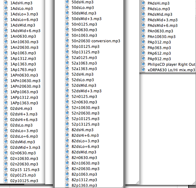

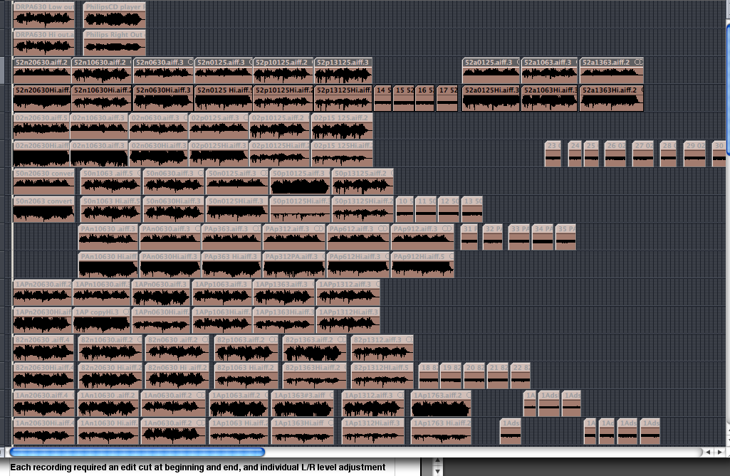

An excerpt from Ed Kabotie’s song, “7 Cities of Gold” with voice, acoustic guitar and wood flute was used for a music piece.
Ed Kabotie Freedom Songs - DreamCatcher.com

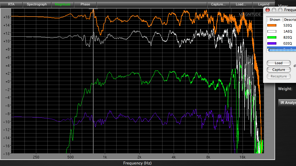

The drivers were equalized to as flat as possible from 630 to 16K using a DBX DriveRack PA , then the excerpt was played to determine what input level would make the amp’s clip light illuminate so power levels could be compared. SPL level dBA “Slow” read about 12 dB less than peak ( dBA impulse) reading.
The Crest CC 2800 used is rated 1400 at 2 ohms, 965 at 4 ohms, 595 watts at 8 ohms, but has no 16 ohm rating, going from the other power ratings it is estimated at 367 watts in to a 16 ohm load when the clip indicator illuminates.
The various DSP settings result in slightly different drive levels, so the excerpt was played to determine at what drive level the amp clipped, then relative wattage for each level derived assuming a 16 ohm load.
Noise floor in general was about 65 dBA, various wind gusts, bird and car noises can be heard in the lower volume tests.
A 24 dB per octave 200 Hz HP filter is engaged on the Logic (similar to Pro Tools for Macintosh) recording of the horn/driver, a 24 dB per octave 30 Hz HP filter is engaged on the DRPA output which has been mixed in with the HF horn to make the recording, full range, yet with with reduced wind noise and (hopefully) similar phase response. Logic recordings have been “bounced to MP3.
The recordings of the horn only are available upon request.

50dsLo 530 Hz 85.2 dB, 1060 Hz 75 dB, 2ndHD 32%

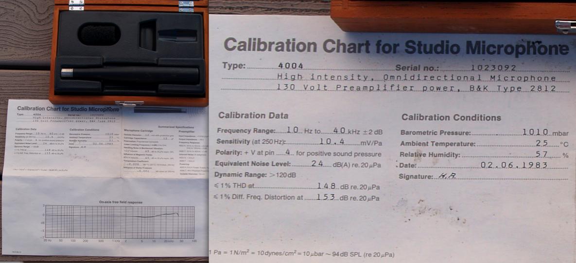

152.8 is 0 dB Full Scale for the B&K 4004 at -12 dB in Smaart
Set up photos, frequency response and RTA screen shots of the dual tone tests are attached to this first post.
Recordings:
Recordings of 523 & 932 Hz "low" dual sine tones dual sine wave recordings (“C” & “B flat) in MP3 format are attached are posted in #2.
1046 & 1865 Hz ”Mid” dual sine wave recordings in MP3 format are attached in post #5.
The 1046 & 1865 Hz for the B&CDE82TN and 2093 & 3729 Hz ”Hi” dual sine wave recordings are posted in #7.
Music recordings start in post #9, including the equalized driver frequency response.
More higher power level Music recordings are in post #11 and #14.
The highest SPL level Music recordings are in post #15.
The remaining Music recordings are in posts # 26 & 27.
Music recordings of the HF horn output only, with no low frequency "virtual driver":

The Facts:

On axis FR & Phase= driver abbreviation, “on” Maltese horn (13 degree horn angle) 2 meters (2” to 1” adapters are 6 degree, 1.4” to 2” are 7 degrees)
4 volt (one watt) 2.5K sine wave 2 meters=driver abbreviation,”oneW2.5K”
Recordings:

The 1046 &1865 Hz ”Mid” dual sine wave recordings (“C” & “B flat”) for the B&CDE82TN in MP3 format are attached, level is -12 dBFS
The B&CDE82TN reached 6% distortion +3 from the level of the first test, unfortunately that recording was missed, though the RTA was saved.
2093 & 3729 Hz ”Hi” dual sine wave recordings (“C” & “B flat”) are also included below.
Music recordings will be posted next, refer to the bottom of Post #1 for a complete list of recordings as they are posted.

The Maltese HF horn, though it loads to around 200 Hz, was designed for a 1200 Hz crossover. It does provide a relative comparison between the various drivers performance down low, but it's performance down low is weak.Ah, they all do better on the midrange dual tones. At least at low drive levels.
Though all the drivers "did better" with the mid tones, the EVDH1A really crushed the other drivers with 6.4 dB more clean output available than the top 1", and 5.5 dB better than the other 1.4" exit 3" diaphragm driver.
For cleanly reproducing brass, reeds, and drums at or near "live" levels (or louder than live for sound reinforcement) the additional six dB "gets it there".

The drivers were equalized as flat as possible from 630 to 16K using the three PEQ and 1/3 octave filters afforded by the DBX DriveRack PA. Each driver also used a specific delay compensation to align it with the LF track, slightly different delay and EQ were required for the 1250 Hz alignment.
The process was akin to aligning a dozen different PA systems, no small feat in itself.
The process “babied” the 1” drivers, allowing for the LF track to carry some extra “weight” around the 630 Hz crossover point. This is hardly evident with the low track and HF horn mixed together, but obvious when the HF horn recording is listened to alone. As mentioned in the OP, distortion is also much more obvious with the horn output alone.
The specifics and SPL level of each recording are given in the OP "Tests" section.
Screen shots of the raw and equalized response of the drivers are included below, levels offset for clarity, the LF response was in all cases exactly on the “0 dB” line. The “82” response shows the horn/driver’s acoustical response using the 24 dB LR crossover. The missing curve of the BMS 4550 was similar to the “52”.
I regret missing taking a shot of the equalized response of the “PA” driver, though it took “heroic” measures, as I recall it came out near as flat as the other drivers to around 16 kHz.
The “02” was the only driver not capable of flat 16K response without an inordinate (power wasting) HF boost. Rather than “cook” the voice coil with frequencies above 12.5 kHz, which would have made comparison with the other drivers difficult, I let the top 1/3 octave roll off naturally.

Also, while the tests are interesting, I am wondering about the transition between the compression driver's short exit/throat and the throat of the horn. If there is a discontinuity there - the angle changes - then you may have a place where there is diffraction. Might be effecting the distortion and the HF response. Wondering about that.
_-_-bear
_-_-bear
Might not be an issue. Art?weltersys said:Care was taken to insure a smooth transition between driver, adapter and horns, requiring a fair amount of drilling, filing and cursing those that made poorly aligned adapters and drivers that have unique bolt patterns.
The horn is too deep to get a clear view down the throat.Art,
can you post a picture looking down the mouth of the horn?
And lit well enough to see what is going on there??
In practice, do you array these horizontally like an old multicell to get the required horizontal coverage??
_-_-bear
The pictures in post #1 show the side view of the Maltese horn, the four horns arranged as a Maltese cross show why it was named. The 2" throat of the horn is a simple transition from square to round.
In practice, the horns were arrayed horizontally, the last time I used them for PA I used three per side, which left HF "holes" spread to 90 degree coverage, seven Maltese horns would be required for a 13 x 90 degree pattern.
