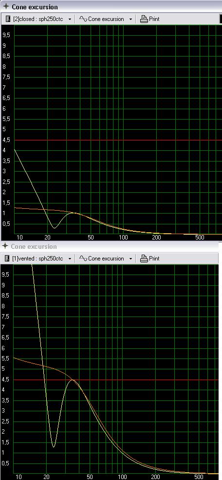

The movement is the result of the Sd area and frequency and pressure you want to generate.
How lower the frequency then the x must increase to maintain the sound pressure.
Till this isn't more possible the speaker loses acoustic resistance and the resonance frequency appears the Fs of the impedance.
With a BR system the port is tuned to the resonance frequency. At the tune frequency the air in the port resonates in opposite phase with the air in the box. Increasing the acoustic resistance for the driver.
Result the x decreases and the sound is radiated by the port and driver together. You see in the attachment the extrusion of the driver at 1 W and at 20W. The red line is the Xmax. That is the limit for linear behaivour of the motor of your driver.
At the attachment the same driver is simulated one(orange) in a closed box the other (yellow) in a bass reflex.
You can see at the closed box that after resonance the x stays constant and thus the sound pressure decreases. The -3dB point.
With the same driver in a BR cabinet the port increases the air load to the max at resonance so the impedance is then near R-DC and the movement decreases radical.
A good design has many air load because this means it radiates sound.
With a horn you virtual increase the sd. because (sd or throot) * X= Mouth horn * X. This creates a huge air load and thus SPL and good impulse behaivour.
In this design the port generates a good load for the driver so at can't resonate afterwards.
What to many a good or many bass is often a very bad impulse behaivour. So the driver resonates afterwards and creates a fat sound.
The waterfall of this driver is exceptional tight. Tight responding low frequency transponders sound not fat but do give fast peak responses and do not store energy in the system (driver box) and resonate afterwards.
I had back loaded horns they can produce very impulsive clean low distortion low frequency. But to my surprise this bass reflex came close to that sound.
So your speaker has a lot of low frequency to test if that is due poor impulse behaivour your can connect a battery and connect it for a second. Than you shout have a dry bop. If it is more a boinggg than it is a poor performing design.
Regards, Helmuth

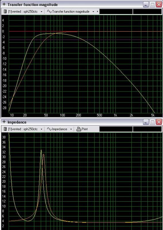

Here the attachment of the transfer closed -3dB at 50Hz and BR -3db 26Hz. That is the gain for the same driver when placed in a closed or BR-enclosure
In the attachment of the cone extrusion you can see the BR port does it work maximal at about 25Hz very low x. This you can also see when you look at the impedance. at 25 Hz almost Rdc.
When you use Winisd-pro it is easy to generate this data. This software is freeware!
You can also see when you look at the cone extrusion that the driver in the BR makes the biggest movement at 35Hz and at 18Hz. You can also see that the driver in the closed box has the same movement down to 35Hz as with the BR-system.
Regards Helmuth
