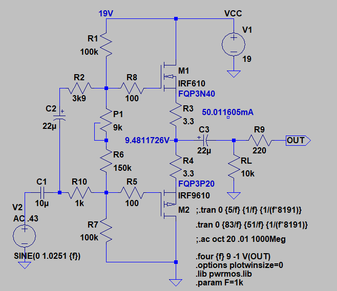

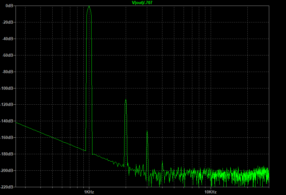

One aspect I do not like from a complementary mosfet follower is the positive phase H2 due to inherently higher gm of the N part. An asymmetric shade feedback is used here to induce negative phase H2.
