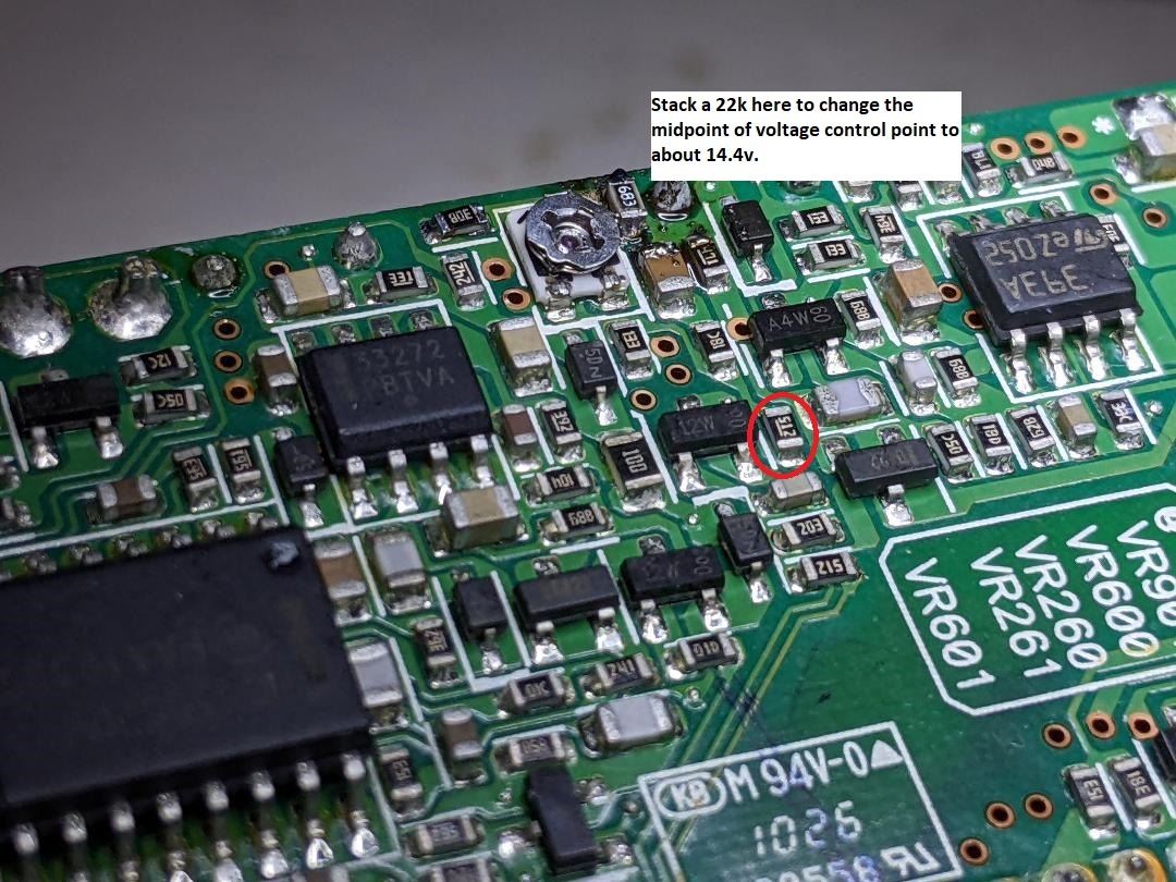

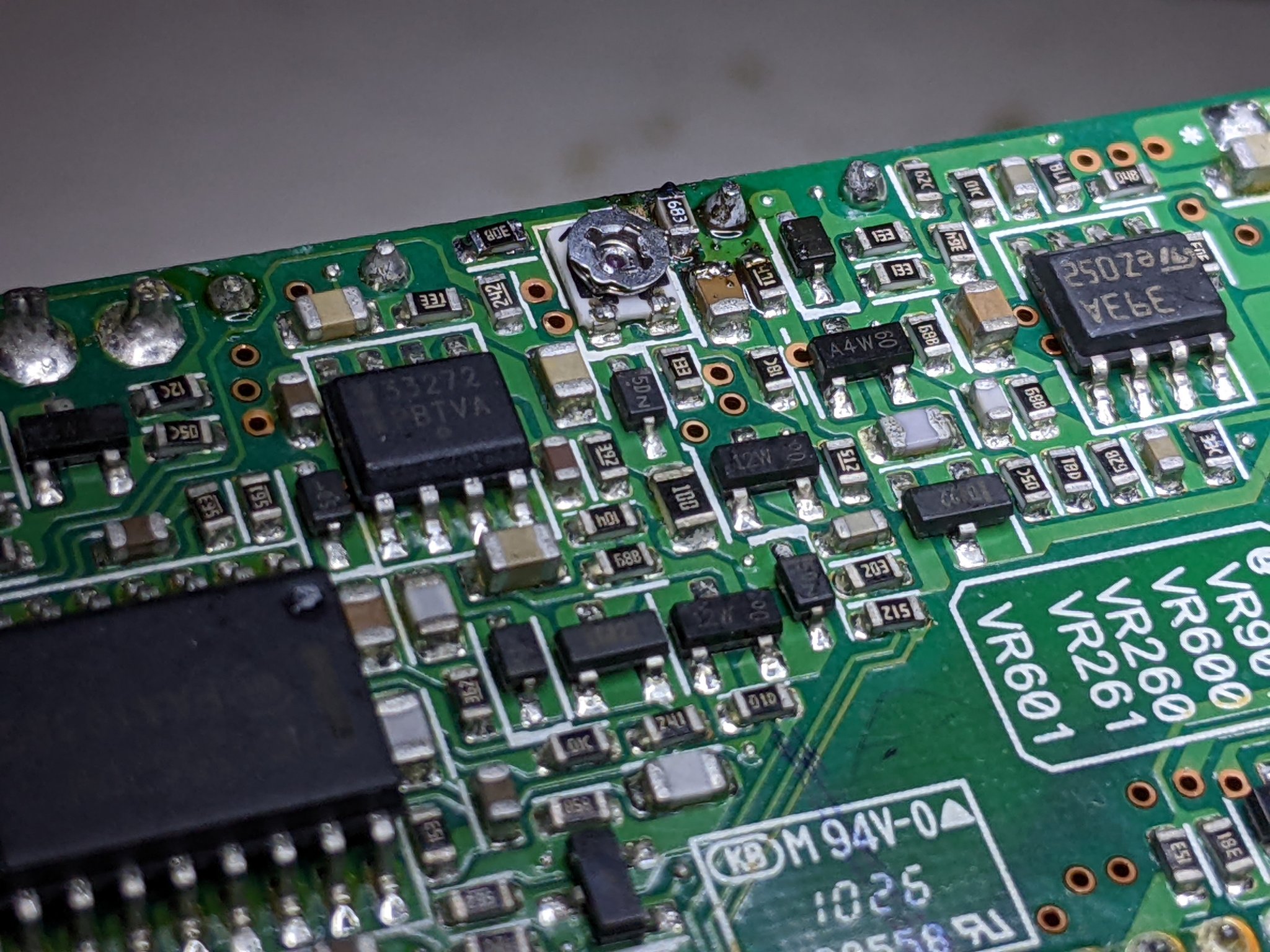

Where I'm at currently with this project.
I have a few of these HSTNS-PD19 I'm working on for car audio amp testing, want to run 3 in parallel at 14.4v volts (off of 220v).
I have found how to disable the OVP!!! Well, to an extent. It is making it to 14.08v now before either a secondary protection kicks in, some other sensor becomes out of range, or the unit is just plane wigging out with output voltage quite low and bouncing some (which more or less is what happens when hitting OVP anyway.)
Initially, the resistor near the pot was a 18.7k. I increased that to 20k at first. Maxed out at 12.7v after moving the pot up just a bit.. (the known ovp protection kick-in point).
Moving on to ovp (which i finally found.. pretty sad how long that took lol). Is just a simple R divider to the micro on the back side of the daughter board. Stock is 20k/3.74k.
I first added 20k to the 3.74k to get 3.151k (my rough calc said this should kick in ovp around 15.3v).
Then back to the pot side.. Changed that resistor to 22k, could now swing 13.6v (ccw) to 14.05v (cw).. cool i thought.
Went to 24k which was a bit of a leap, no dice.. Protection or wig-out state even at ccw pot.
F'd around and finally found a parallel combination of resistors that allowed me to boot ccw with the pot (68k||33k=22.218k).
Still hitting the ovp at around 14.08v (i thought). I changed the ovp circuit resistor to 3k. I now start at 13.72V and max out at 14.08v with pot ccw and cw.

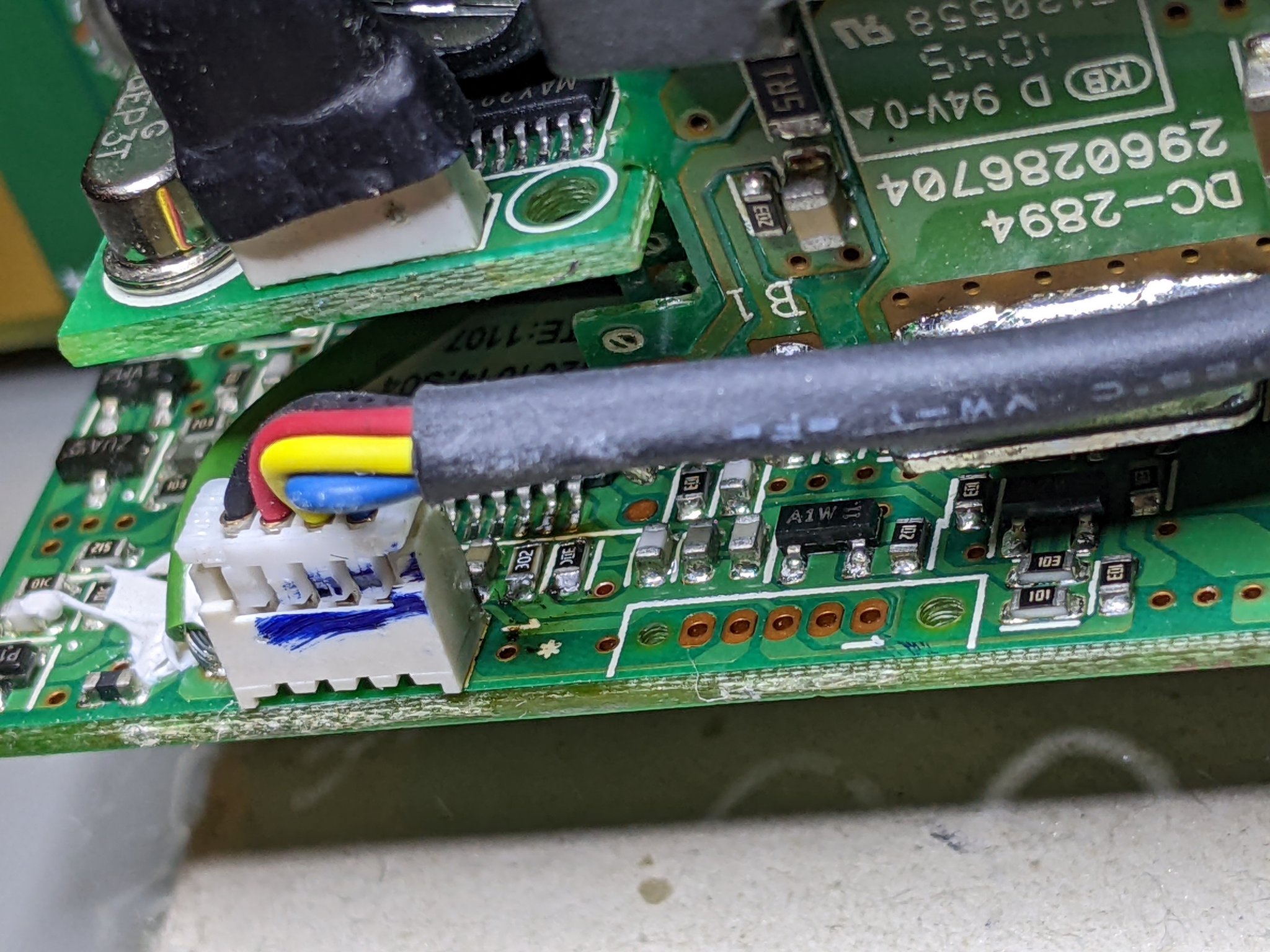

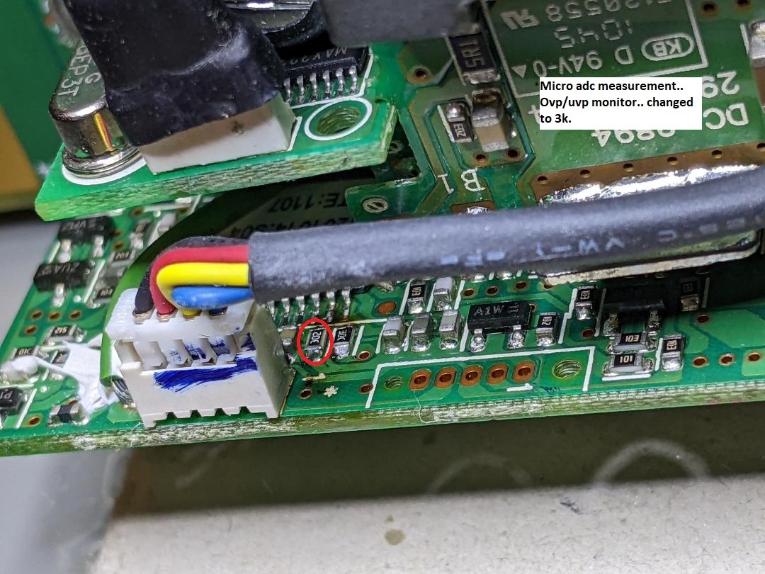

There is a comparator circuit on the bottom of the main pcb that takes output voltage into the comparator input, I did play around there too after all of the above, no luck there. FYI

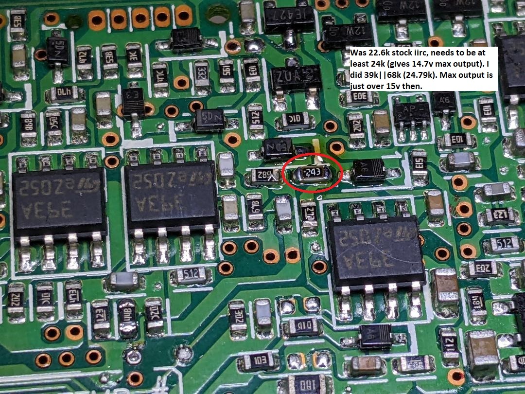

Ok, finally got there. Smh....
DO THE BELOW AT YOUR OWN RISK AND REALIZE I HAVE NOT TESTED FOR RELIABILITY.
I load tested at .375Ohm and voltage drop was from 14.40 to 14.25v, not too shabby.
One thing that is worrisome though is that the ucc37323 driver is running really hot, like 118C after a minute or so. Need to circle back to that. It's on the inside side of the long side board, near the top (soic8 package between a couple wired headers).
Scoped around a bit and waveforms look mostly ok, probably more digging to do.
And another sort of scary fyi, the last hack I did to get from 14.08v to 15v was just trial and error lol. I picked out non-standard values on the side board and tried raising and lowering resistance until something worked.. I was having zero luck with other methods. Sooo yeah I'm not entirely sure where in the circuit this tweak is
Pics attached enjoy
