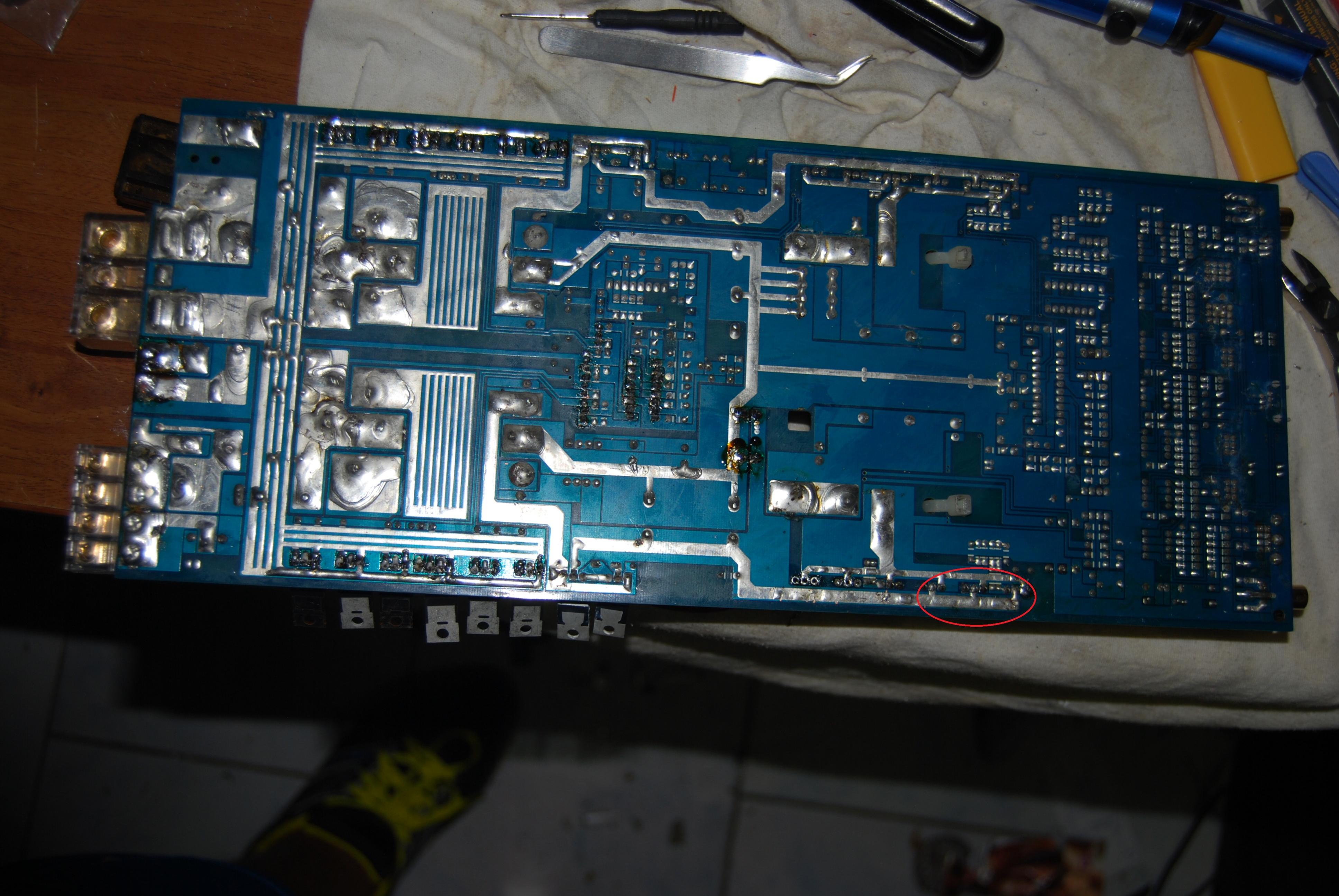

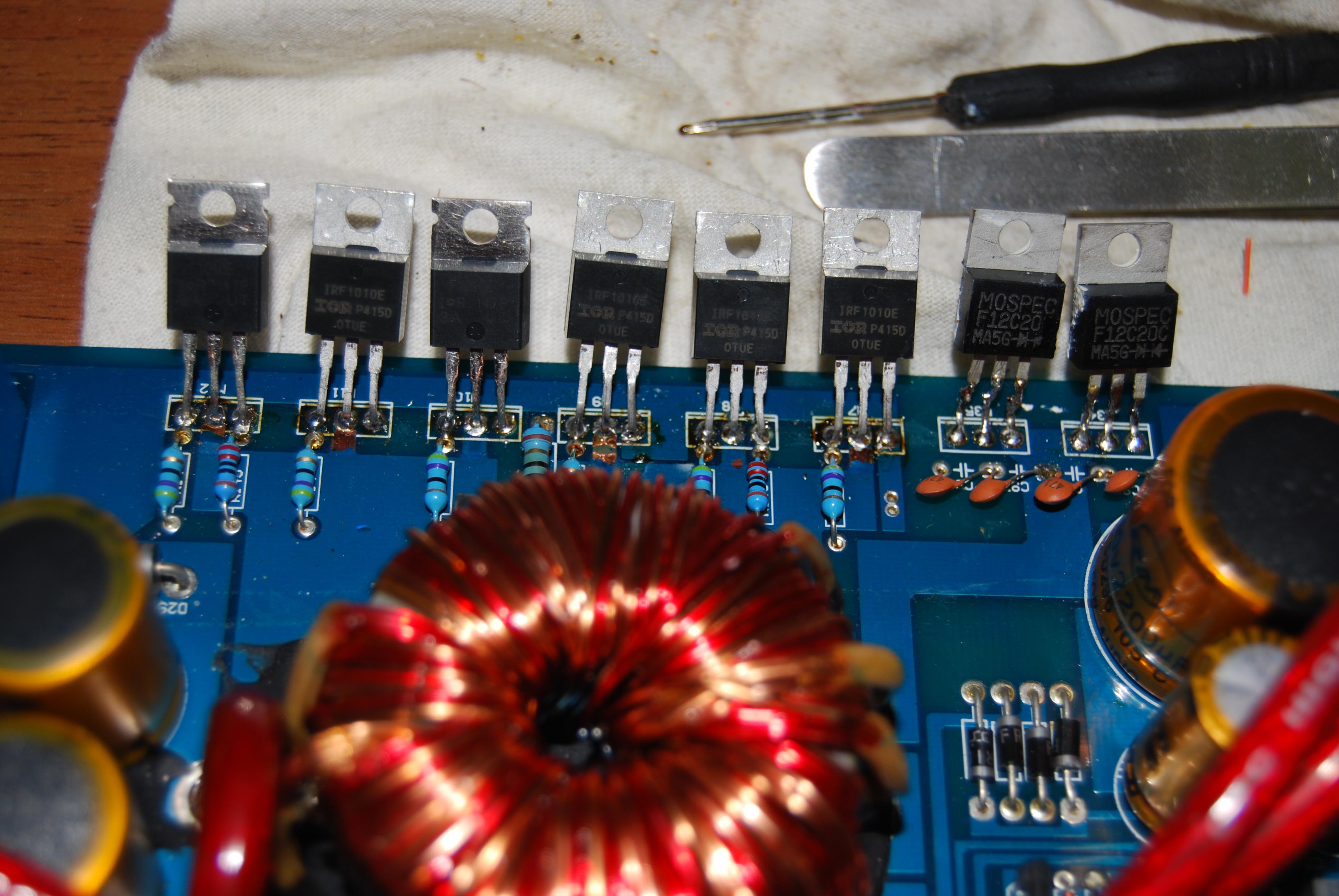

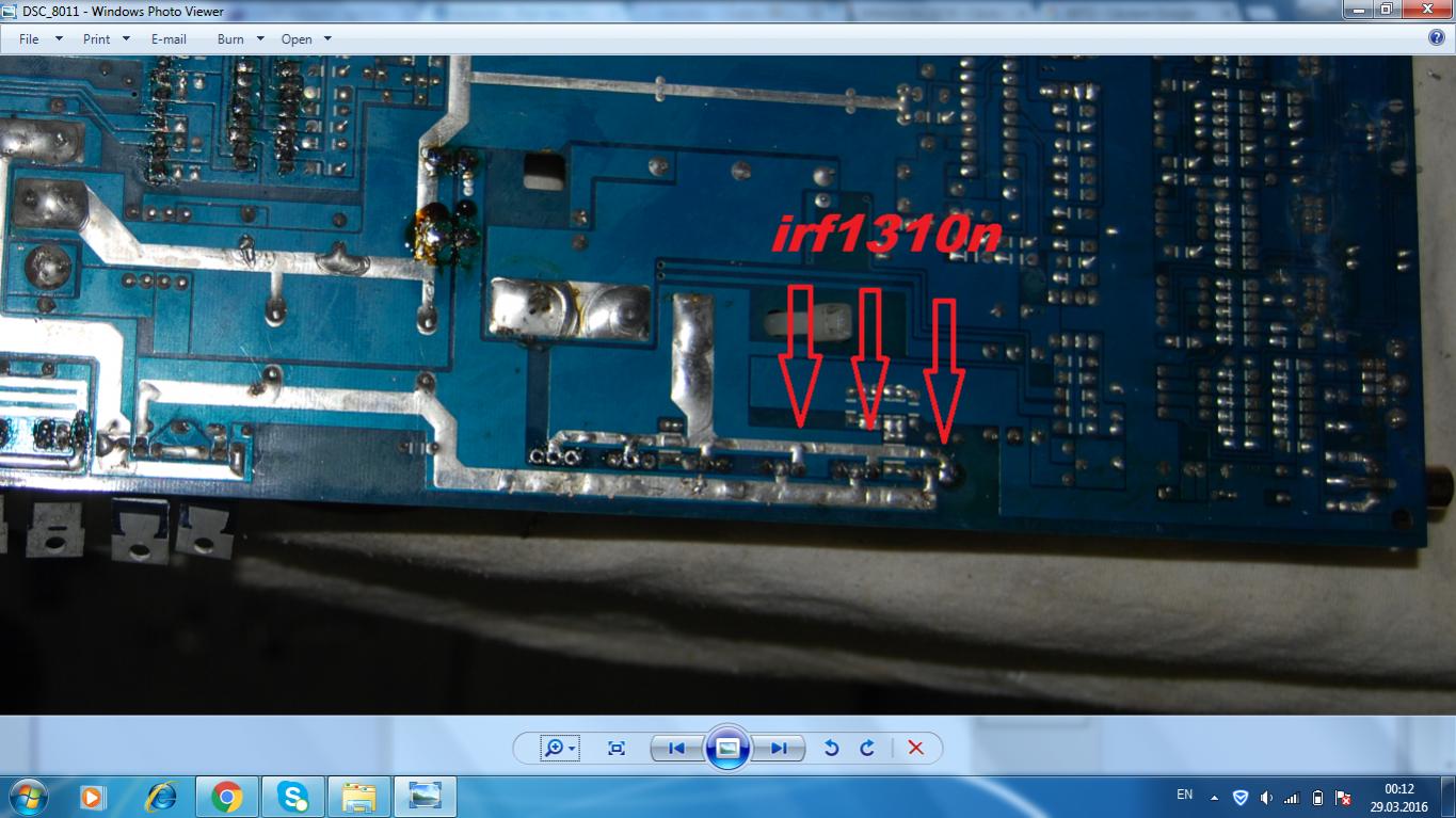

Hello..I have a hifonics txi 1500d broken..Amplifiere was burned and i changed the tl494 , driver transistor,power suply transistor ,and driver hip4080, .Now the power suply work good.the problem is at output transitor because when put the power suply on the amplifier , 3 transistor from photo are very hot,in few seconds are at 100 celsius degrees.
If the voltage remains coupled transistors are destroyed(only 3 pcs).I wil put a photo for see.,.i use irf1310 all output transistor.
I wait the sugestion,what i must to check:|thank you anticipate:|:confused::confused:

To avoid running in circles with this amp, I'd suggest installing a new 4080 (no matter if it's currently new) and all of the output transistors with the IRF3710Z. That seems to be the most reliable way to get the 4080 based amps repaired.
Absolutely do not purchase components from ebay. Order from farnell or mouser or some other reliable distributor.
There are other components that need to be checked like the large resistors and diodes near the 4080 and all of the gate resistors.
