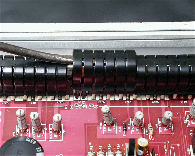

Remember, clamp all transistors before applying power.

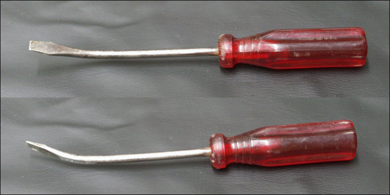

A little trick I picked up with the transistor clips. Cut the longer ones in half and it is 10x easier to install/remove multiple times:
Amp is ready for power testing:
Per suggestion, I was able to cleanly clip the 494's Pin 16 from the top of the PCB using an exacto blade. Using a shielded alagator clip for bridging this pin to other sources (Ground):
