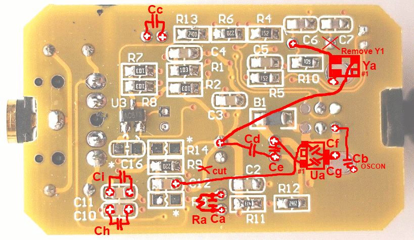

Many thanks to enjoybiking for the suggested mods. I've outlined a few of them directly in the attached PCB photo (I have yet to implement these changes in my UAE23).
In the first phase I will try to do Ua, Ra, Ca, Cf, Cg, and the X cut.
Ua=MIC5209-3.6BS (separate 3.6V reg for the ES9023; upside down)
Ra=100k (similar to the ODAC)
Ca=10u+2.2u (alternatively, replace C9 by 22u and add 100n here)
Cf=22u (see reference Ua design)
Cg=0.1u (see reference Ua design)
In the second phase I'm thinking of adding the other caps and replacing Y1 by Ya, and maybe add some ferrites.
If anyone has any other suggestions or advice about the mods, please let me know. It would be great if someone could help do proper measurements before and after the mods. The whole idea is about pushing this DAC from being good to great for a little premium (say $10-15; labour, tools, and shipping excluded).

UAE23 mods: the 3.6V regulator
I mounted my second regulator 90 degrees more clockwise {and yes, upside down} and tacked the regulator input to the USB 5v+ directly. It might be possible to tack a second ferrite there to the +5V "u" of trace there and feed the second regulator {mounted with feet almost straight up, maybe 10PM}.
If you wanted a third regulator, it MIGHT be possible to vertically stack TWO regulators. 3.6{DAC} and 3.3 {TCXO} SOT-223 style like you drew. Will it fit the plastic case? Maybe not.

Sure, the mods' outline is just indicative. For example, there is actually more space for Cb and Ya on the other (=front) side of the PCB. The Ra could also go straight onto the R3 pads.
I did put a Fox XpressO 50.000 mHz clock on topside this morning, it is upside down with it's back laying on ES9023, OSC pin #3 feds the MCK pin on ES9023 with a few mm bare wire-wrap wire. OSC EN and V+ pins are towards bottom edge of board. GND from OSC to scratched clean top ground ground-plane spot {out left of DAC pins 2&3}. Once this was is place I cut trace coming from TE7022 pin#3 to the DAC, I did so where the trace heads East {flat} and cut away from myself towards the TE7022 so as not to nick the pin 2 and pin 1 TE7022 traces.
3.6V Micrel 5209 regulator is now much as you drew it on bottom of board by USB IN wires. Rather than desolder my old 3.3V TPS79633 I used it to run the new 50MHz clock, I ran the + wire up through that big hole [bottom right of your pic]. I added a decoupling cap to the OSC from EN pin to ground [EN is wire-bridged to V+ pin on 50M OSC]. I was able to use a wire-leaded cap there, typically that would be something like a 103 cap {0.01uF}. The Micrel's top TAB is stacked over the TPS79633 tab over edge of that large grounded hole. Micrel is NOT upside down.
So dedicated regulators for DAC, 50Mhz clock, and TE7022+12Mhz TCXO {sharing the onboard LT1763}.
DAC Vcc pin also gut a 22uF tiny can cap today, spanning that cap{s} aready at the DAC power injection point {below the etch cut on your drawing}

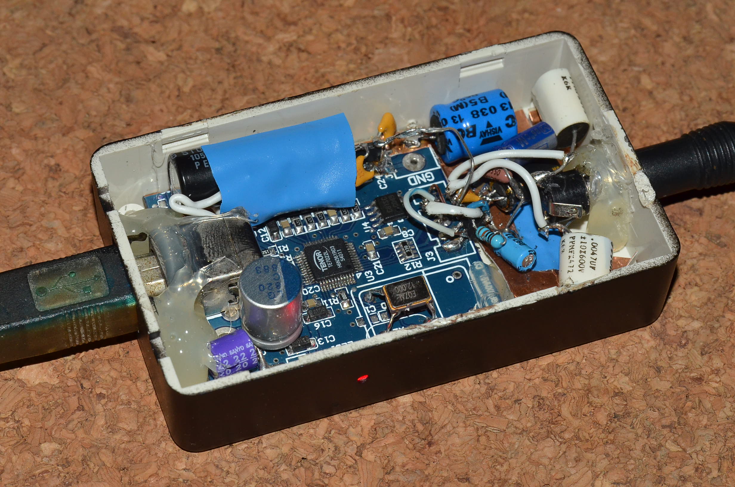

I made this. Look bad but sound very good ! There is seperate 2 ground planes for dgnd and agnd. It use TL1963 3.3V regulator. Input to regulator through RC = 7R x 2200uF Rubycon YXG +100nF. Output 470uF BC038 + 100nF. R8 = 143K RN55 parallel to 10uF Panasonic AM-X +100nF. Neg use 22uF Nichicon FW + 100nF. CN_CP use 1uF X7R + 100nF. Mute use 100K + 5uF.No series R on analogue. Only have 4700pF Multicap PPMFX (metal polypropylene) output to agnd. Tenor use 12Mhz XO91 <1ps rms jitter. Input to Tenor through capacitance multiplier.
Sound is very good. No clipping/distortion. Very very small pop noise when plug into USB. I use Foobar, kernel streming, no driver. There is low jitter sound quality so this is very good value part. :)

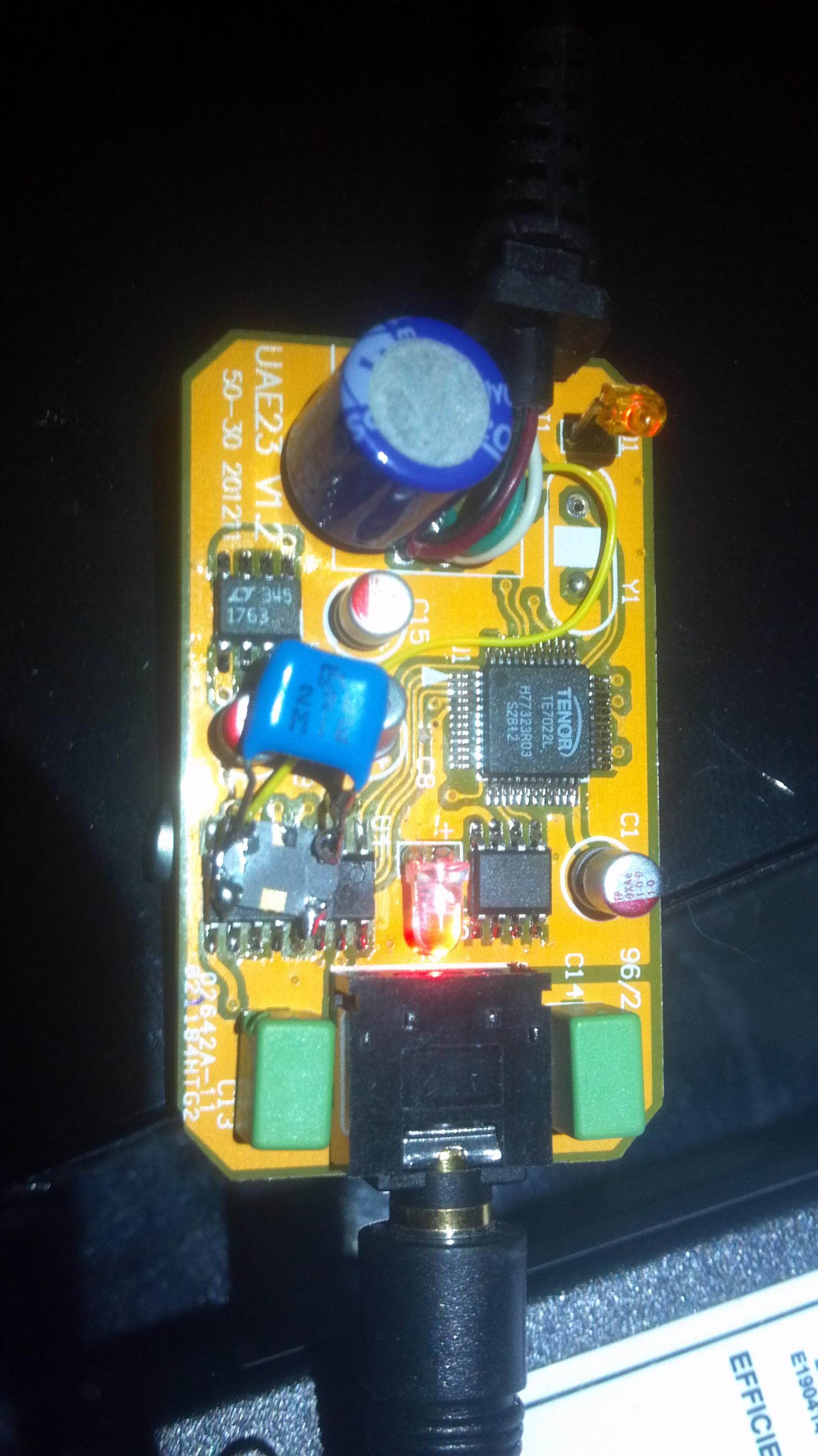

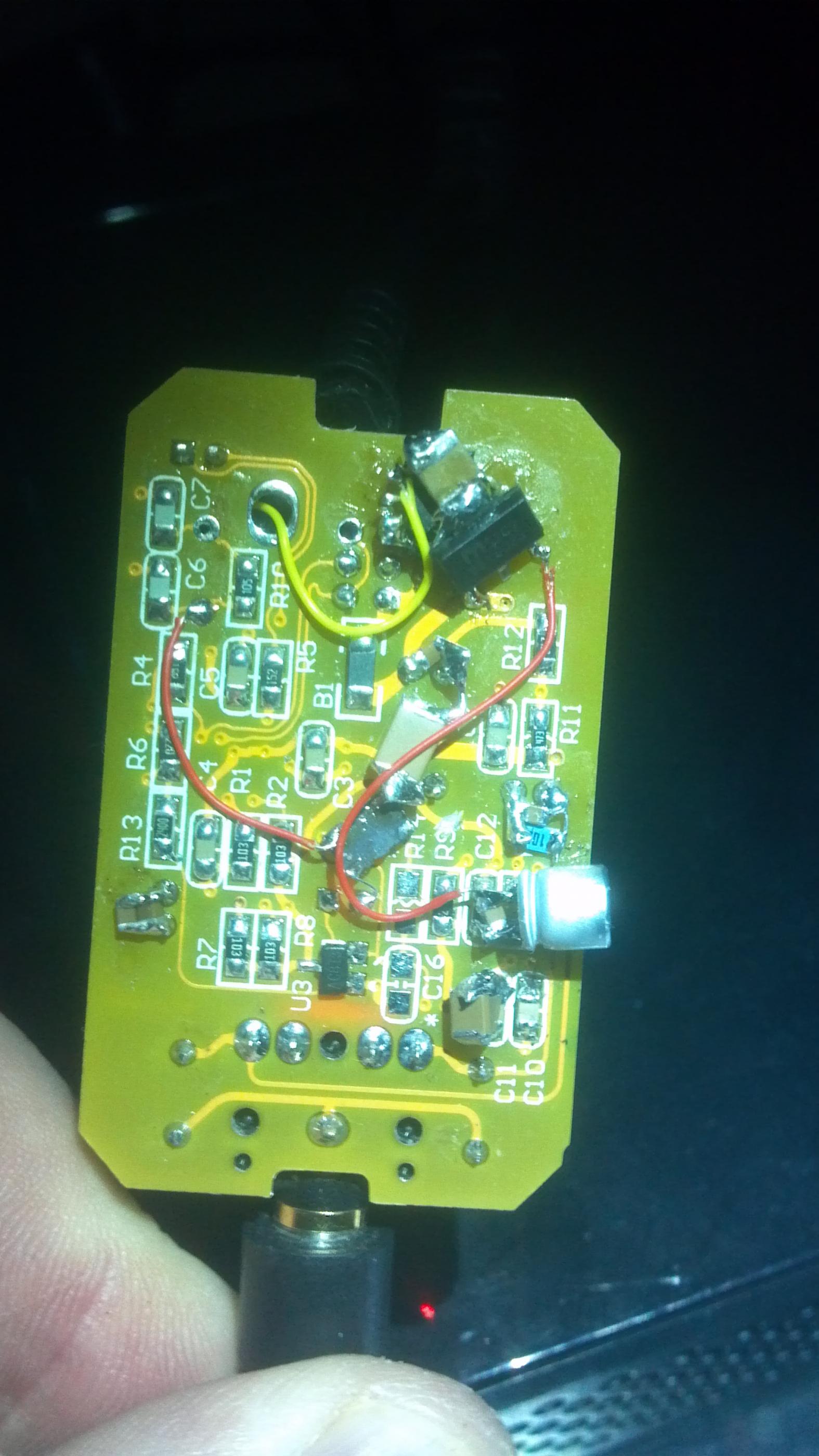

Attached are pix of my modded UAE23 I may redo parts of it, but it works well.
The top 50Mhz Oscillator I would like a better cap arrangement and maybe a ferrite bead.

DAC lives at edge of tenor pcb, and top is down, so LRCLK and Data are direct connection - pin to tenor pcb.
