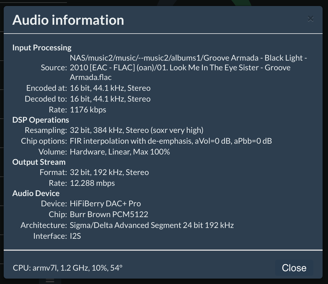

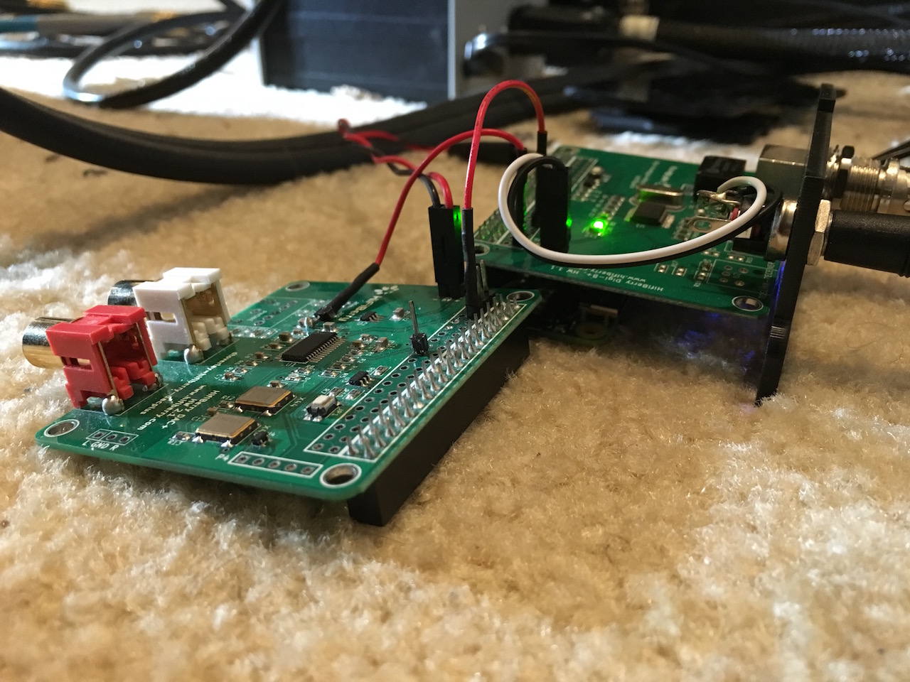

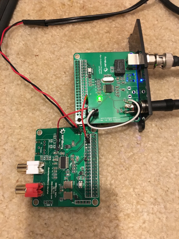

At this point I'm trying things without altering the board to the point it can't be put back, did at least use a short jumper since then. Linear power and then this 3.3v seem like the heavy hitters since it is improved big time. Not a struggle to hear the difference like interconnects etc.
I'm thinking of making tiny ADP150 daughter-boards that can be added, wire it correctly then, just a thought tho-- I'm keeping it simple, to repeat it on friends dac's etc.
Don't laugh , but to experiment I am borrowing that ADP150 circuit on the DAC+ (see the lash up in the pic), to power the 3.3V on the digi+ (similarly bypassing the pi 3.3), best my PSAudio DL3 dac has ever been! Using 2 linear 5V supplies.

In the mean time I'm going to order 2 of these:
0.8uV Ultralow noise DAC power supply regulator 3.3/5/7V 1.5A*x2 - DIYINHK
That will give me 4, selectable 5V/3.3V supplies, nice and flexible.
Edit: yeah I see what you mean, you can see the tiny surface mount parts that are the actual LT3042, but then it also has the normal looking thru hole with heat-sinks regulators (in their pic), hmmm
maybe the ADP7150 is a better choice.
And I'll go with the 25W transformers (up from those 15W):
25W Power Talema Seal Toroidal Transformer Install PCB 7V 9V 12V 15V 18V 22V New | eBay
Need to get my digi+ up & running on that, and can try it on the Dac+ PRO.

Ah, thats what they did, re: page 26, to up the output from 200mA-- hope it's not to much a compromise. Also went with the 7V transformers, Thanks!
Now I get the pic's you've posted showing the paralleled regs... thought those were all stand alone, to power various parts of the dac.

32/384 Upsample to disable PCM5122 filter
The moode 2.6 tr1 is working with the D+Pro now, so tried 32/384 up sampling...
Looks like it does it, but then changes to 32/192 going to the dac... so maybe the hifiberry driver limits it?
Music does play fine this way, no stress on the pi3.
Scott... I should add this info on filters (in case you didn't already know it), that DACs use different filter sets based on the sampling rate of the input signal and typically use a less onerous & obtrusive / better-sounding filter when you feed it a higher sampling rate. So even being able to upsample to 192 could possibly bring some benefits, again after some fiddling with filters. BUT AFAIK, with the PCM51xx chips, the biggest bang is brought by upsampling to 352/384 with the right filters.
