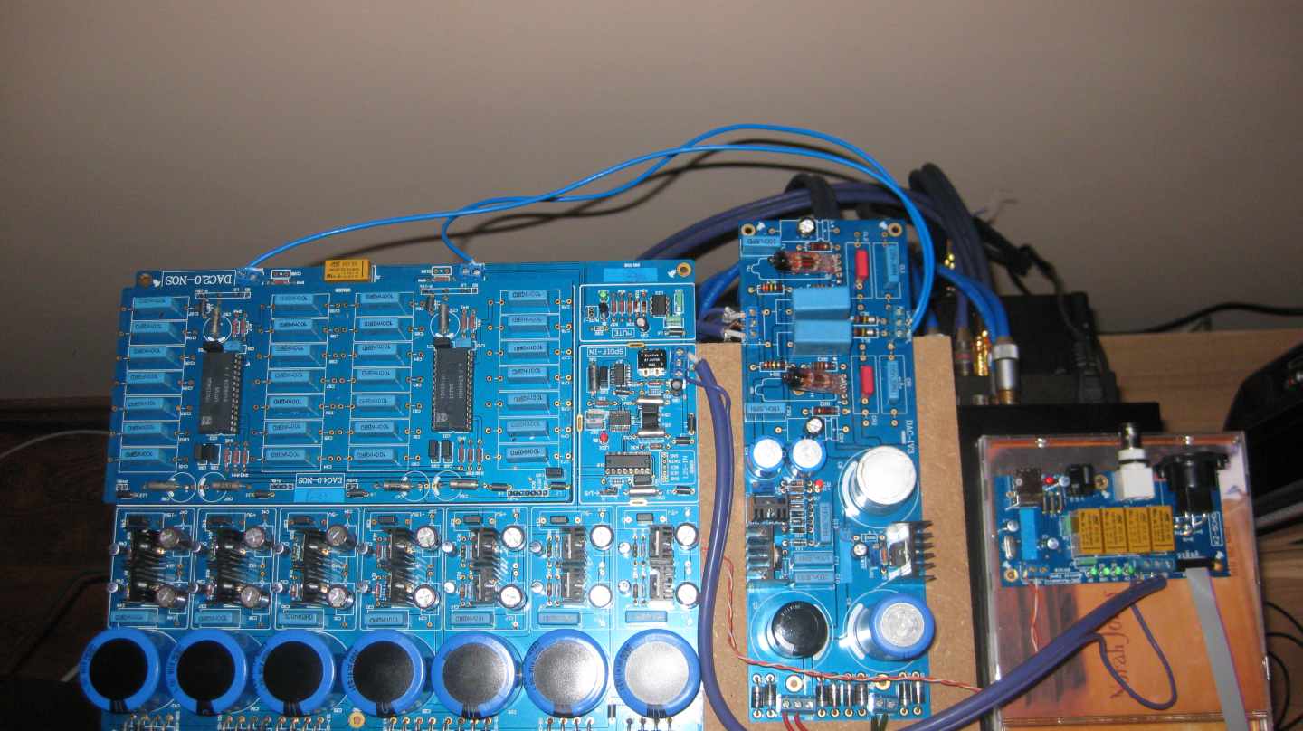

Hi everyone. I've just got my 4xTDA1541A from raindrop_hui. After installation, I've notice a few things:
1. there is a noticeable hiss on the output of DAC (even without any input signal, or analog output amplification)
2. I can hear some "artifacts(distorted sound like)" on music(specially on classical music in the quieter parts of the music).
I've compared with the output from my CD-Player to check if the recording
was the problem, but it wasn't(these artifacts are missing on my
CD-Player).
Did anyone of the owners of this DAC encountered this issues? Is the hiss normal for this DAC?
Regards

Hi flancfuster,
please tell a little more, how you connected the DAC (with pictures if possible).
Hi flancfuster,
Hi dvb,
I've received from HUI 4xDAC, Tube module and multi-input. The power supply (9V and 18V) is connected as per markings on PCB. I'm using a separated transformer for tube module.
First, I tried using twisted pair cable for SPDIF input and for output connection from DAC to Tube. The hiss (tape like) was there.
After I've changed to coax cable to see if there was something wrong with cables. Same thing, the hiss was there.
I've tried to use the DAC without multi-input module, direct on SPDIF, no change. After that tried using DAC without any output amplification, no change....
Regards.
I see a missing ground wire on the Tube output. Did you use Rain_drop's transformer?
The wiring on the power supply side is mostly were the noise is coming from.

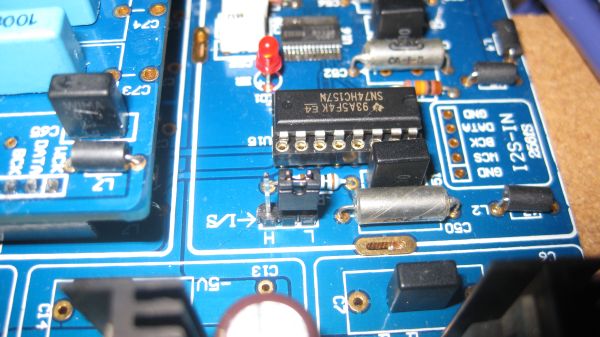

Is your SPDIF/I2S switch in HI-Position? Low is I2S any you need SPDIF.
Looks like my switch is on Low position. I've seen now the switch and I will change it.
Thanks. I will check how is working now.

Hi dvb,
I've tried the other position on the I2S/SPDIF jumper. There was no output signal after the change, so I've switched back(see photo below)
After several tries, I've noticed that I have less "artifacts" and hiss with signal from laptop to usb, so I'm guessing maybe is something wrong with the signal from optical output(cd-transport, cables...). I've tried to connect SPDIF coax directly to DAC, without the multi input module. No change. I'm using Real Cable for optical connection, and coax cable between multi input module and SPDIF in from DAC. CD transport ONKYO Integra DX-6850.
Can you tell me what cables you recommend for SPDIF in to multi input connection?

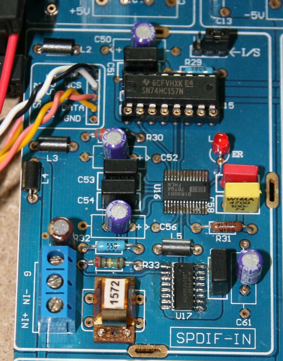

Hi flancfuster,
i hope you connect the SPDIF signal to +In & -In and not to +In & G ??
For the cable you could use a normal 75 Ohm digital cable.
Hi dvb,
Indeed, i've connected the SPDIF to +In and -In, coax 75 Ohm cable.
I've seen in your project, that you've changed the caps from I2S/SPDIF in. Should that make the difference?
This was one step of the complete upgrading of the DAC.
With every OS-Con´s in the powerlines you will make a step forward,
but to be honest in the Input-Stage there is not much difference.
Back to your problem. I think you should send a mail to raindrop_hui, because
he knows his schematics from the I/V-Tubestage best.
I had absolute no problem with my Tube-Stage.

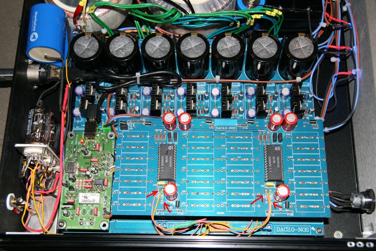

Hi Oliver
My brother Sorin alias flancfuster put all the boards in a enclosure with proper cable and ground connections. The hum still coming from the tube stage without signal and when we play music especially classic music with low level signal we can hear some unusual noise (like an FM radio station not on the right frequency) and also a lot of hiss. When we stop the music the hiss disappears. The hiss is more perceptible on the SPDIF and Optical connection then USB. We try to connect the SPDIF directly to the DAC bypassing the multi input board with the same results. We use only two TDA, we interchange the DAC s, same result. I think that the input digital stage has a problem but we don’t know where to lok to fix it. I will send this message also to raindrop_hui to see what he think about this problem
If someone knows how to fix it or how to find the problem let us know

I forgot something!!!!
Did you short the two resistors under each DAC (4x)? They are not necessary and definitely wrong in the schematic.
So please have a look to the resistors (R41,R42 & R46,R47)
