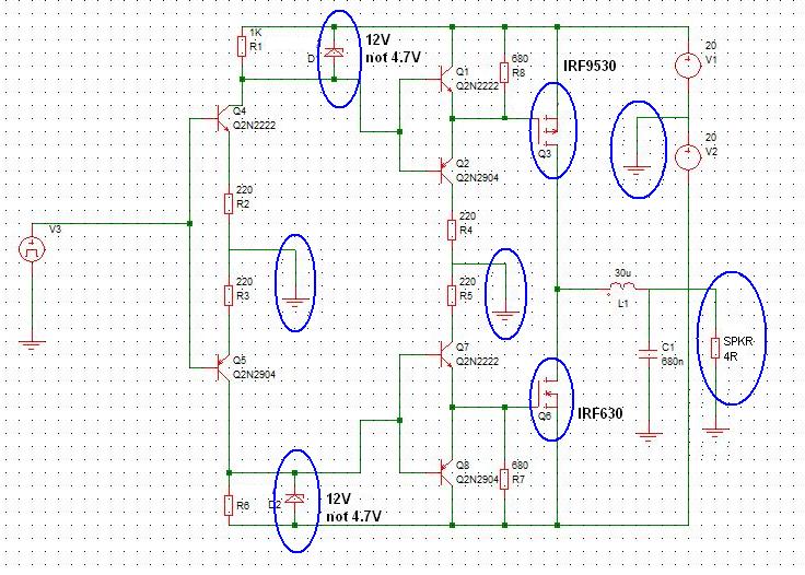

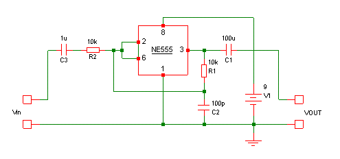

hi can anyone help me with this circuit
They're almost the same. 555 oscillators use a resistor and capacitor to turn the output square wave into a triangle wave for the input. It's not a very good triangle, though.
I think it would be difficult to make a good class D amplifier with a 555. Something like the circuit below might work, but it will have high distortion, and probably can't drive a load impedance less than a few hundred ohms.
It may be interesting to look at with an oscilloscope, just to see how it works. (Can't simulate it because there's no 555 in the simulator.:()

do u know how to calculated the operation frequency of the modulation sage
No. Maybe I could figure it out if I tried hard, but trial and error is quicker. :D

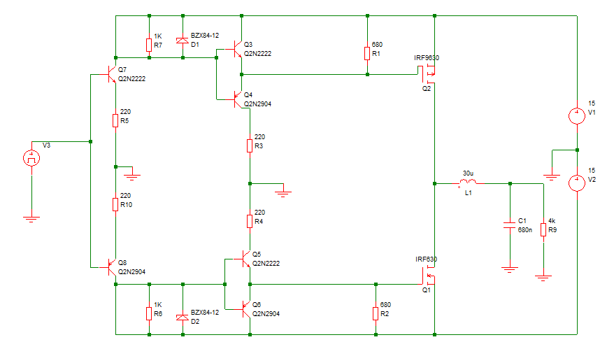

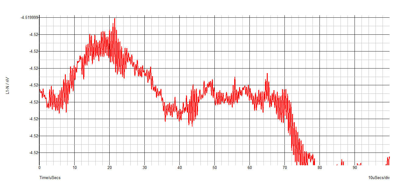

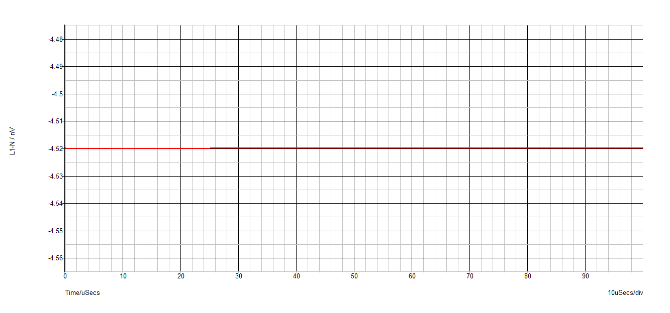

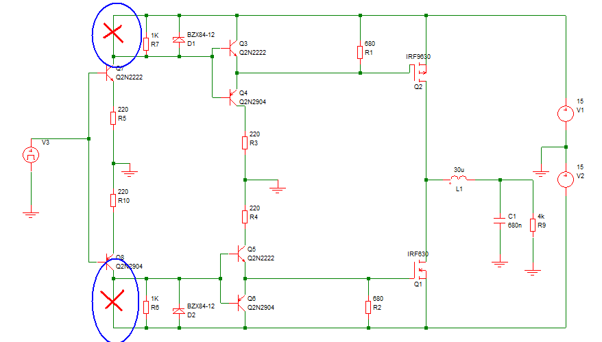

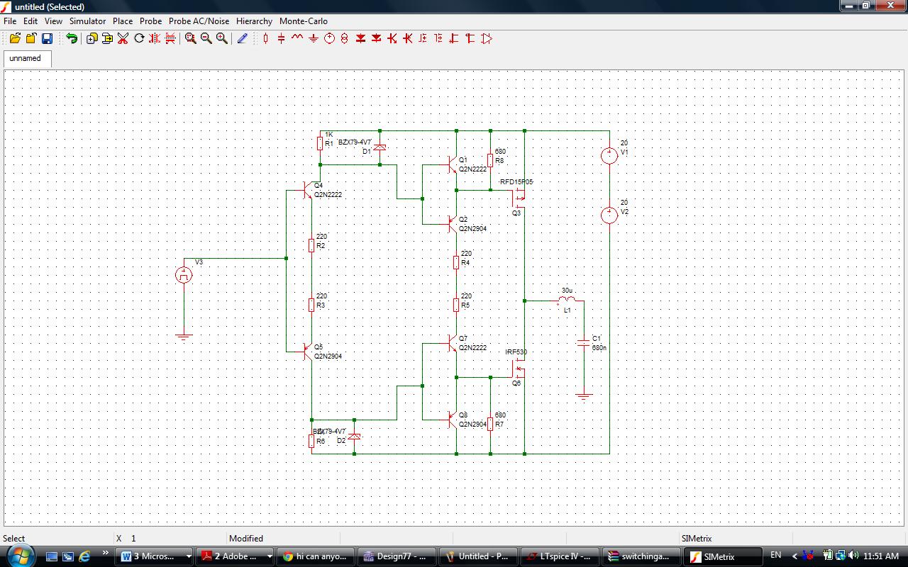

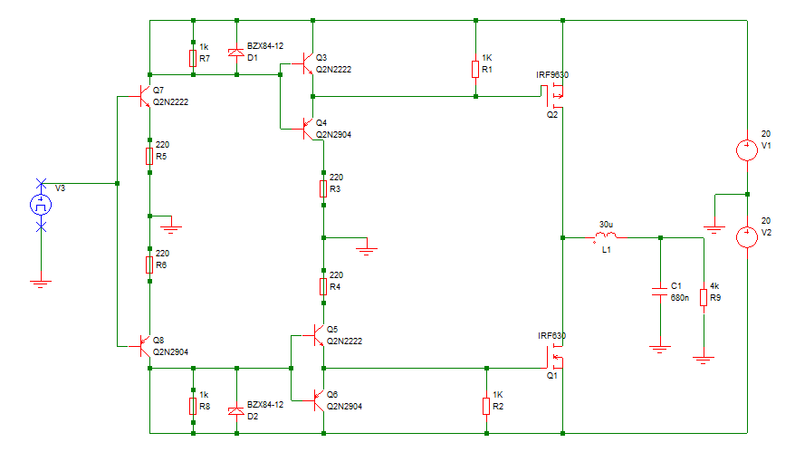

sorry to Bother you but i try to do simulation to the mosfet driver and mosfet i could not get any graph ..can u help me
Are you using Simetrix or other software?

Hmm... No output, just a tiny bit of noise. What's the voltage from V3?
I'll try it now and see what happens.
Edit: Now you've got wires going through the middle of R3, R4, R5, R6, R7 and R8, short-circuiting them. There are also wires to the left of R7 and R8, short-circuiting them. That's the problem.

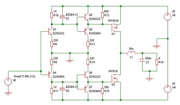

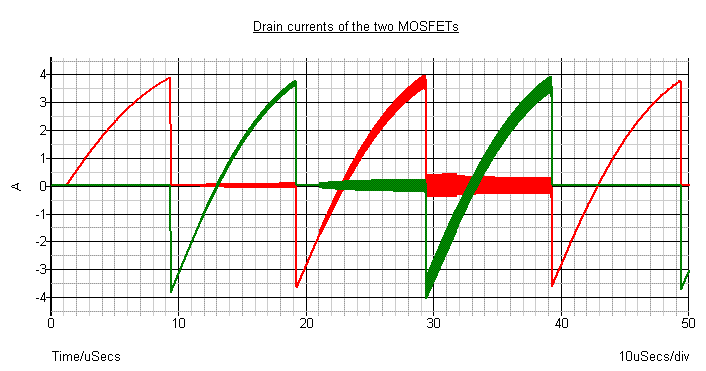

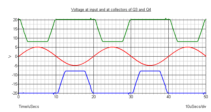

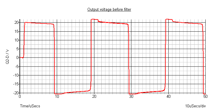

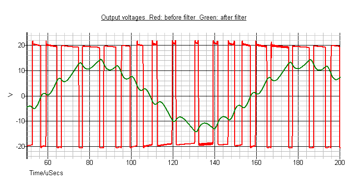

I tried the output stage with a 50KHz sine wave. Normally it will be driven with a square wave, but I wanted to slow things down a bit to see the switching in "slow motion".
The fuzzy lines are just the simulator struggling to get it right. That won't happen in the real circuit. You can fix it by changing the maximum timestep, but if you make that too small then the simulation runs very slowly.
