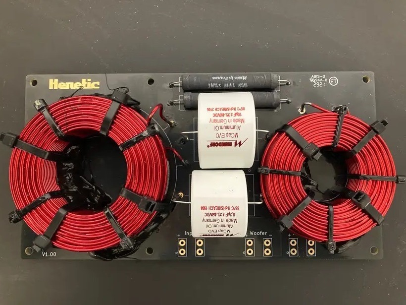

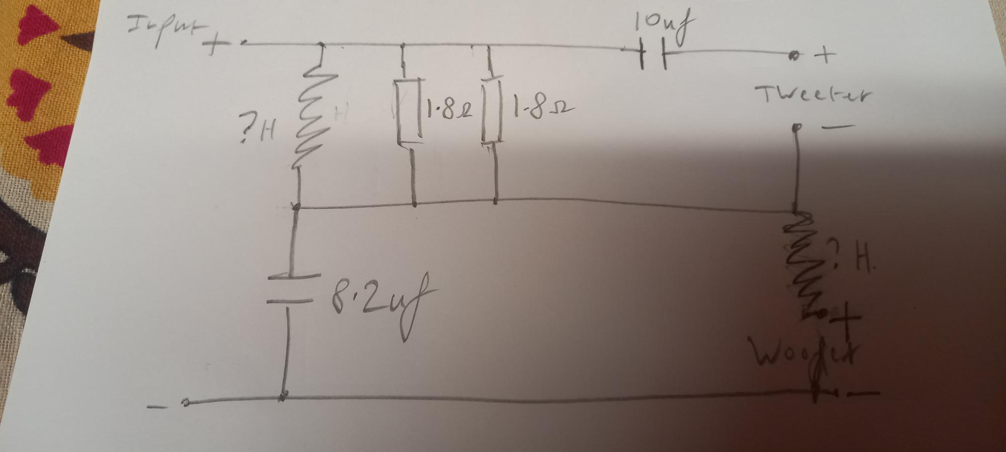

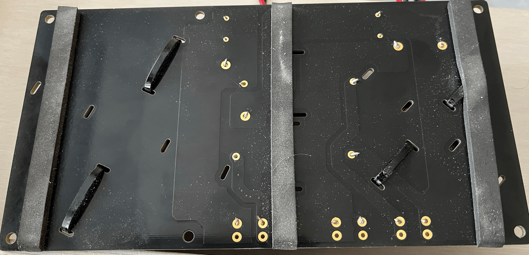

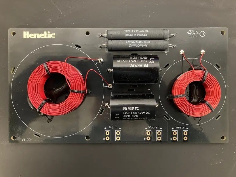

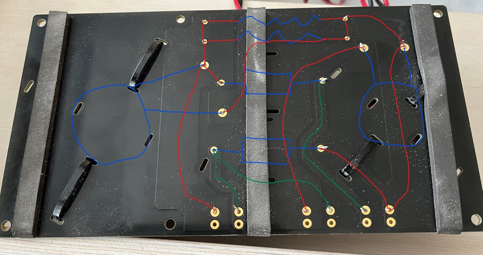

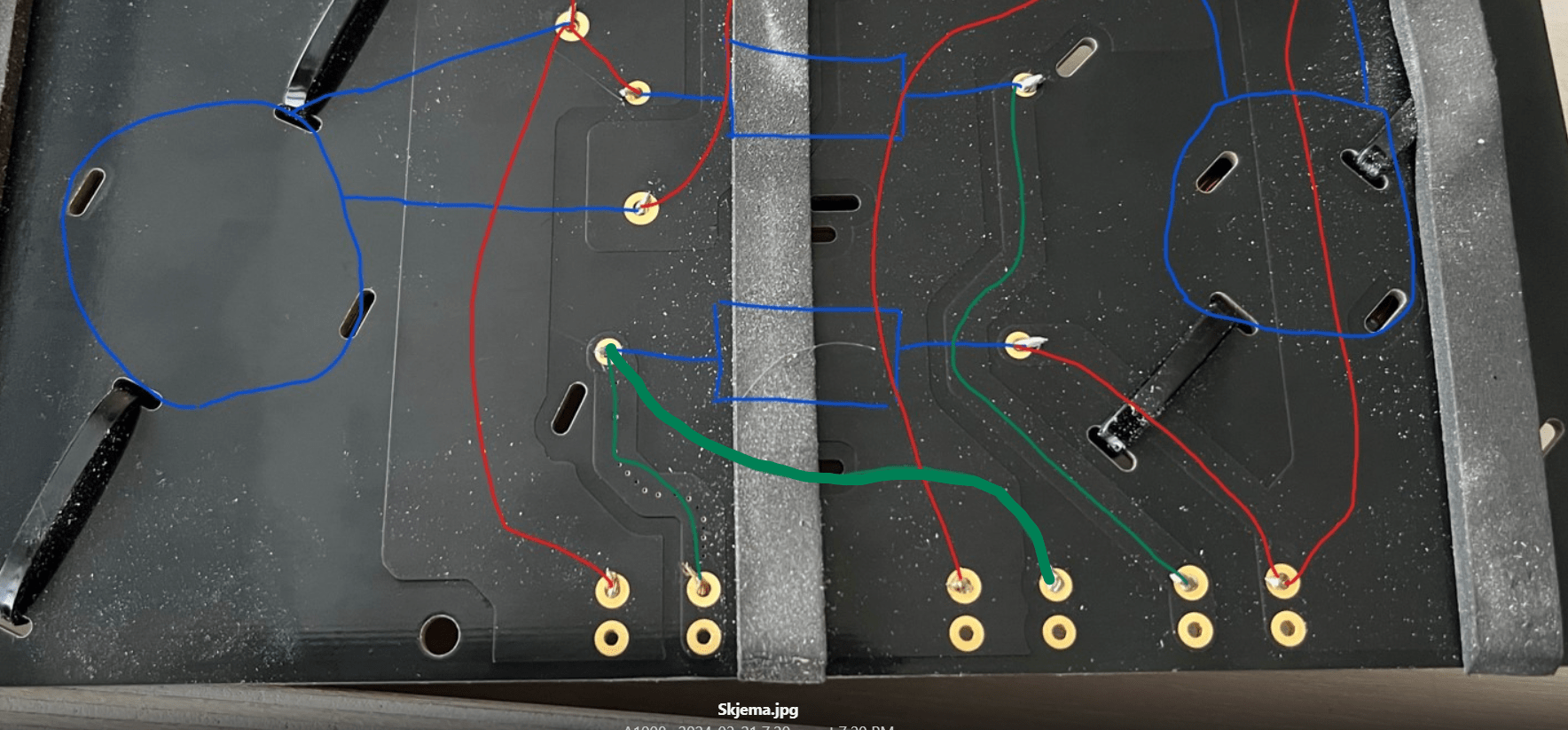

When trying to follow the trace and component placement on the back of the x-over. Not sure I got it right.
Interesting find, resistor's in parallel. I am sure someone will verify your decode.
The Tweeter may or not swapping polarity?
In the original post and picture of the topside the connectors are indexed as +/- which is copied for each of the other connector pads? A minor point as a quick measurement would show correct phasing.

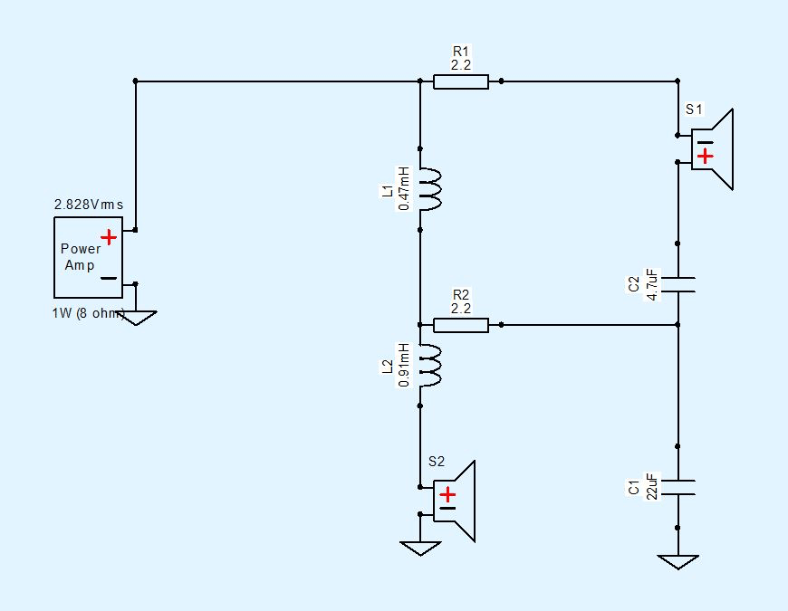

That doesn't seem right. 0.9 ohm across L2 makes L2 effectively do nothing in my quick modeling of it. I was using other driver data (Beta 10 and JBL compression driver), but the basic crossover function should still work, unless I screwed something up in my model.
