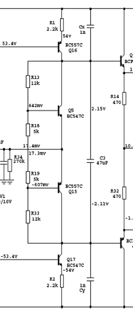

C3 is there to provide a low Z between the bases of the output transistors, at AC. It allows the PNP driver to turn off the NPN output, and vice-versa. A transistor can turn on faster than it can turn off. The residual charge in the base may cause the transistor not to turn off before the other polarity device turns on. The base must be actively discharged because the possible cross-conduction can quickly become catastrophic.
Hi
Hi CBS
thanks for the information ,so is that mean if i give larger value for c3 it will turn off the output transistor more quickly?
and i'm sorry for my stupid question ,you say the base must be actively discharge,how does the way?
thanks,sorry for my poor english

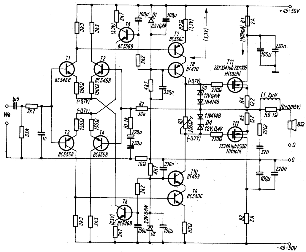

it depends on your power requirement, but personally, i have a
preference for symetrical differentials..
here a schematic from ELEKTOR , the mini crescendo..
it needs some minor tweakings , especialy a more serious
compensation that the one proposed in the original article
wich rely on the mosfet input capacitance...
also, the input transistors are not adequate, use 2SC2240/2SA970
instead of the BC546/556....

thank you for the schematic ,i think the original 2sk134 are a bit hard to find now,beside quite expensive also,see on ebay near $25

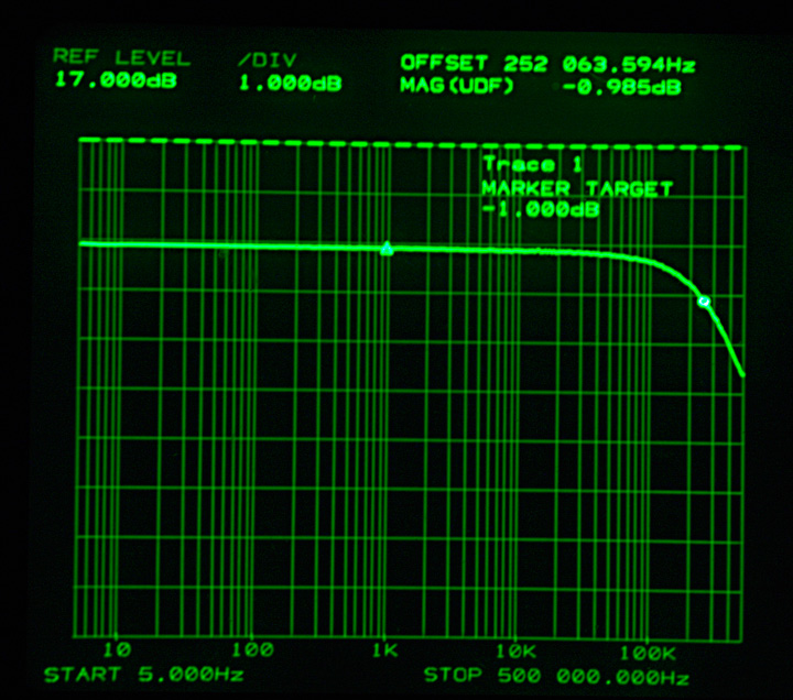

here the simulated frequency response without any effects through choised location and without any room effects

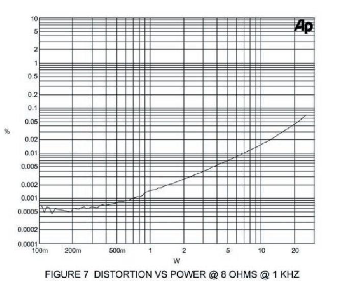

Efficiency is one thing, results an other one.
Have you ever listened to an F5?
Where are the 1% distortion?
Look at the dist. figure shape. (extremely low at low level increasing regularly)
Important for details restitution.
Look also at a the frequency response figure. Very rare in audio.
Opposite to you, i do not claim the creshendo is a bad design.
But you have better to build an F5 and listen, you could be surprised.

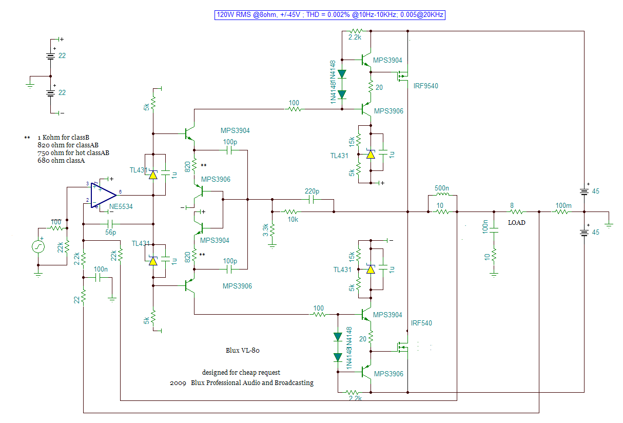

Want t try VL-80? or ever seen this topology before?
This amp are cheap, but not tested yet, finished design and simulation only. Based on V+I amplifier for better speaker response and refine its linearity.
Could we have more infos?

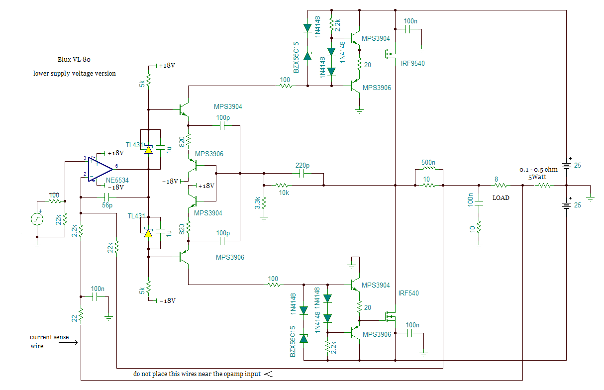

I do some change on the schematic for easier build amp and lower-saver rail voltage.
this step below used when I build or rebuild the big one, and appliable to build this small one since there are no additional problem. This small one are smaller than the small one before, only +/-25V rail.
1st->. Build the output stage (current feedback type, small DC offset still OK) and check it working or not.
2nd->. Build the input stage (place the opamp) but the current sense. Leave the current sense not connected and check it again.
3rd->. Connect all and check it.
