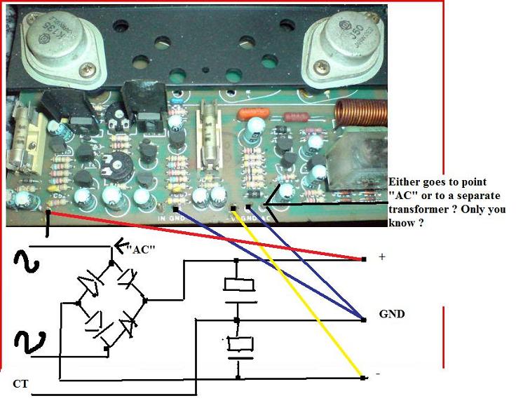

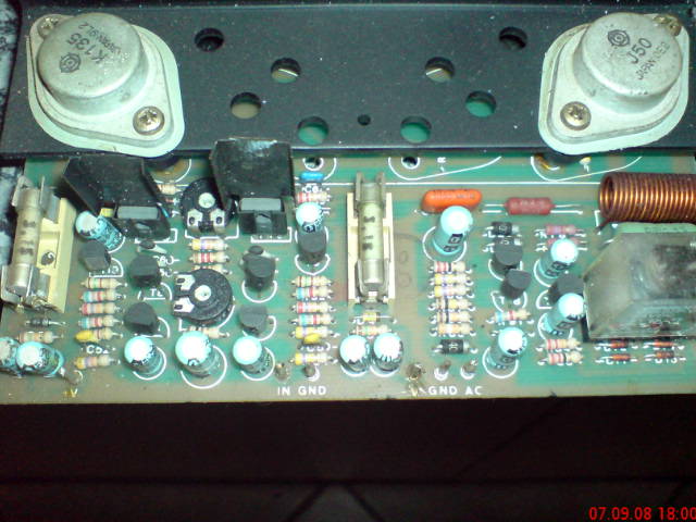

Hi there Guys.
Please give some guidance. I have got two mosfet modules , 50Watt I think, which I have had since the early 1990's. They have given me exelent service with continious trouble free opperation. I have dismantled the case they were in ssome years ago and for the hell of it can not remember the precise wiring on the power supply. It has a AC pin on the PC board which I think went to the TX side of the rectifier, somewhere.
Please help, I would hate to lose these modules of take the expensive smoke out of the Tranies, I know they are obsolete. (K135; J50)

Hi Beejay
Im a ex SA, when I saw this pic of yours it put a smile on my face, I also built this amp when i was still a teenager going off to Wits varsity. I built two monoblocks which are still operational and getting dust as I didnt bring them with me. They are called KW Mos120, rated for 120W, if you built them with the transformer included in the kit, I have the circuit diagram with me but not the construction tutorial which came with the kit. If youd like to find more precise info I suggest you to phone the company that sold those kits, they are called RS electronics and are situated in Springfield JHB south, they are not part of the worldwide british company with the same name, which there is in Woodmead.
This is one very very good sounding amp, which I hope you get going again.
If you manage to locate RS do yourself a favour and buy another pair of mosfets and stick them in those empty spaces. RS will most probably have stock. I modified my monoblocks for even higher performance with higher quality input and vas transistors and I can honestly tell you they sounded better than amps costing R10 000,00 and that was back in 1991 .They will do very well compared todays modern high end amps :D :D :D

Hi Mooly, I agree with the connection to AC on your digram, that was also how I remembered it.
